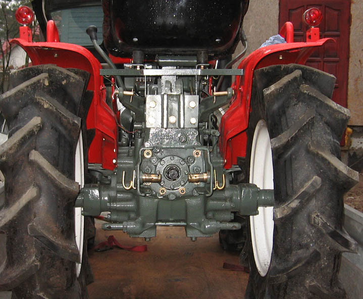

Here is a picture of the back of a 1510.

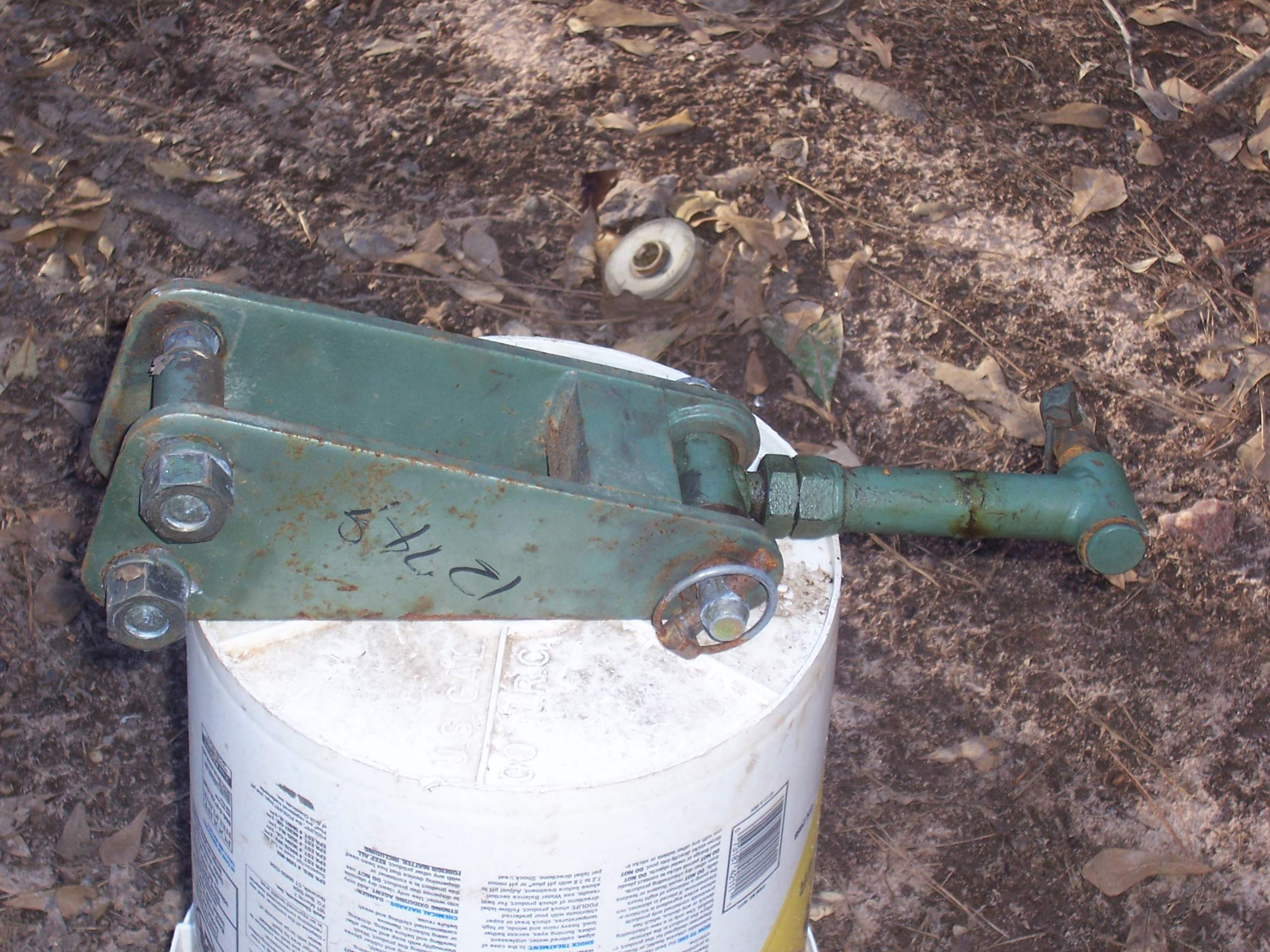

So if that's what the mount for the toplink looks like on all 1510s, its completely different from the 186D... 1510 doesn't appear to have the 2 parallel plates w/ bolt holes, so nothing to mount the tiller top bracket onto?
So guess i should send the importer a photo of a tiller top bracket (like the one hopefully shown here) to make sure he includes one of these.

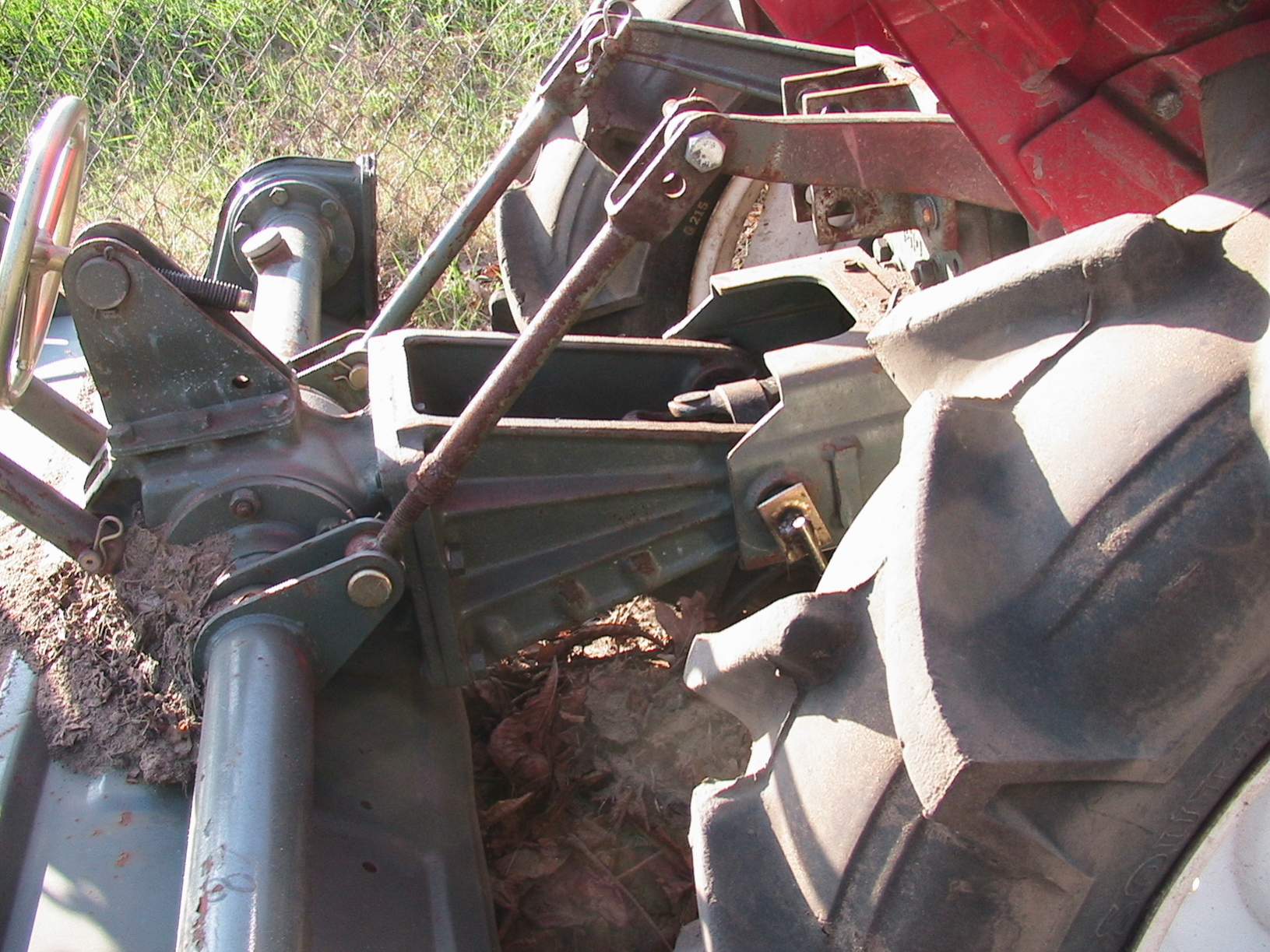

Mine came with the bolt holes for the top link adapter. See Pic. It is interesting to look at California's 186. I can see that the places where we have our bottom pins for the link arms the 186 uses for support for the link shaft.
Mike
