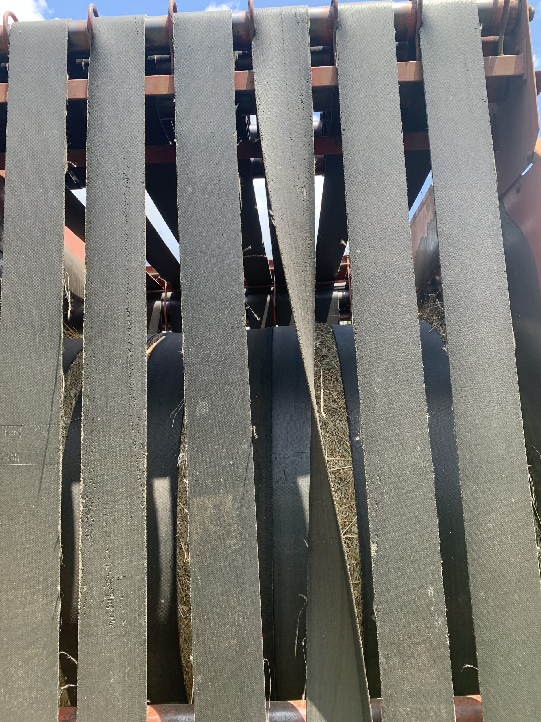

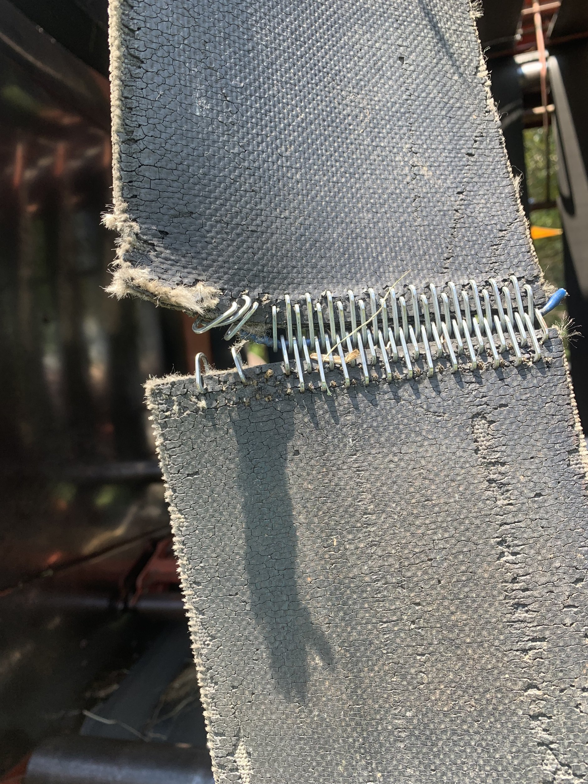

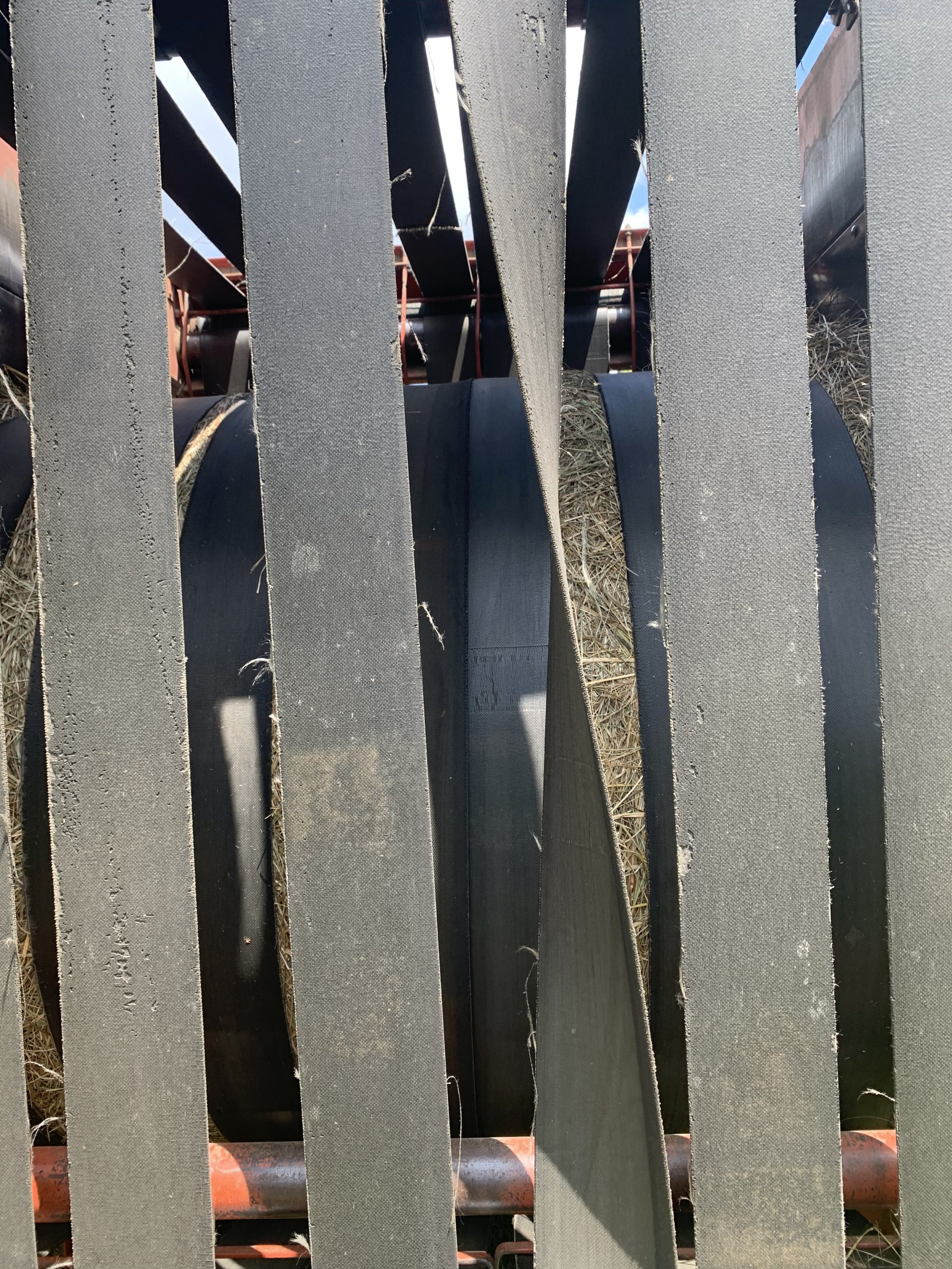

Another question of this baler, how do make adjustment to keep belts from moving side to side and twisting like in pic. I guess there’s no way to add video to this forum.

You have belt tracking issues. Have you ever cleaned your steel rollers? Is there a gummy-dirty film on them?
Had similar issues with a NH round baler and that film build up was the problem

+ 1 0n reducing the pto rpm to start a bale. Not a clue what a TDC is, but belts off tracking are a result of rolling barrel shaped bales. Both my old NH and my new Kubota baler have continuous bale shape monitors built into the in cab digital readout.
   / Gehl 1850 round baler problem #9
On a NH bailer the scraper clearance is critical to keeping the steel rollers clean.
He's been running too many barrel shaped bales.
