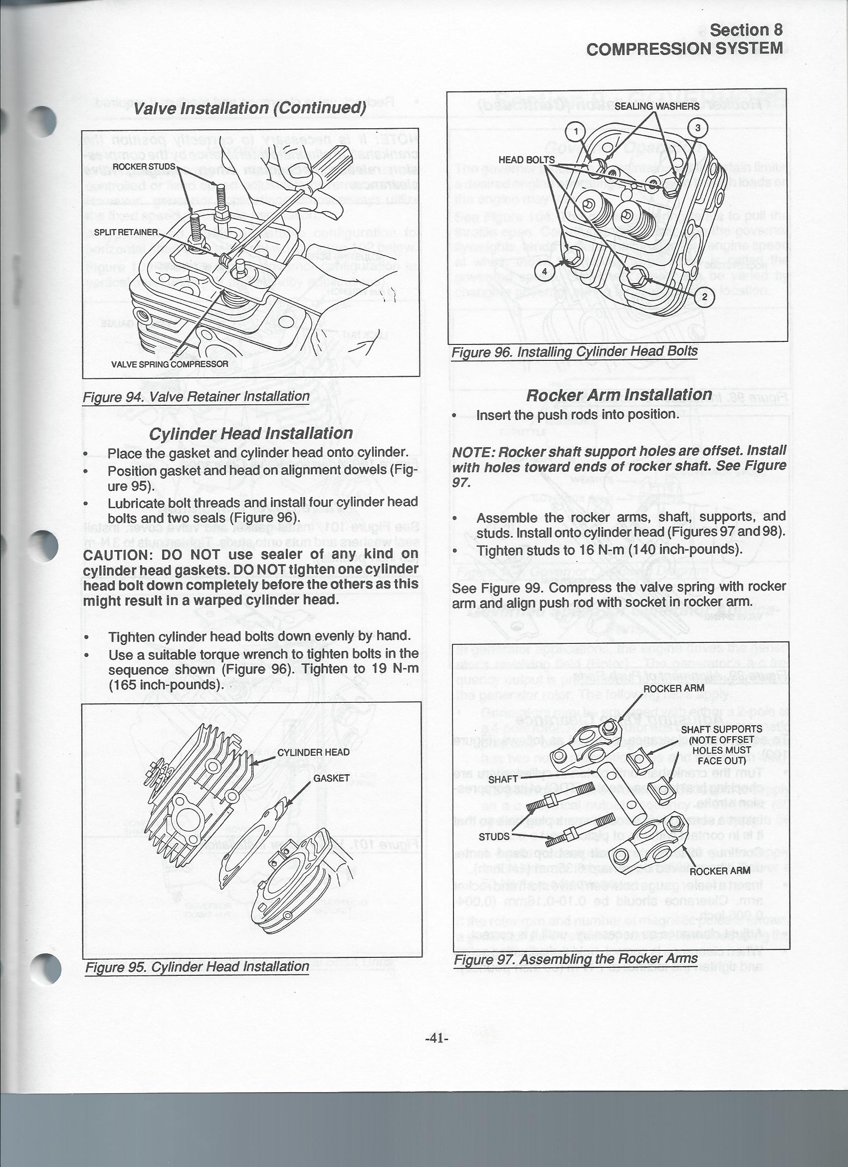

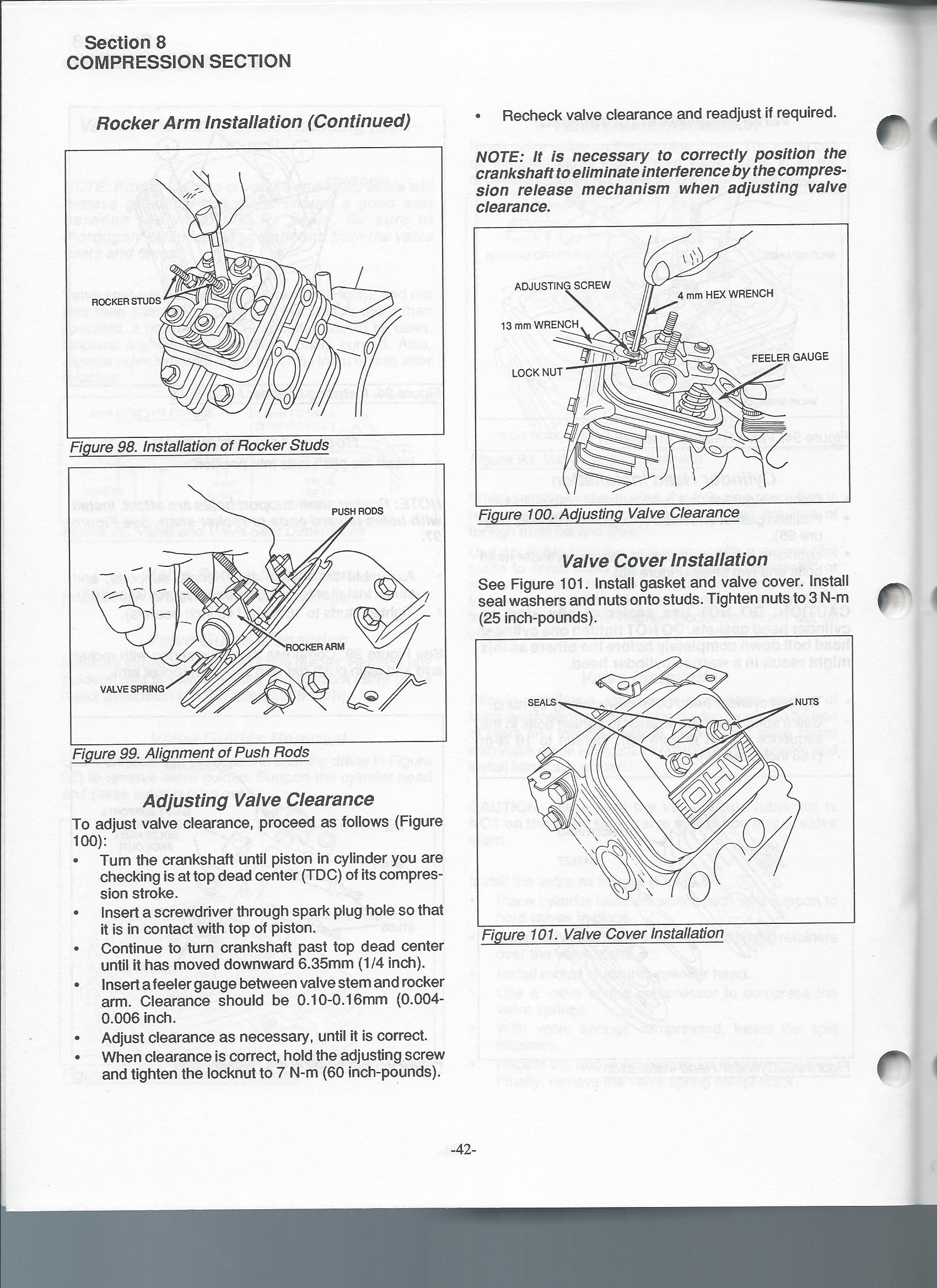

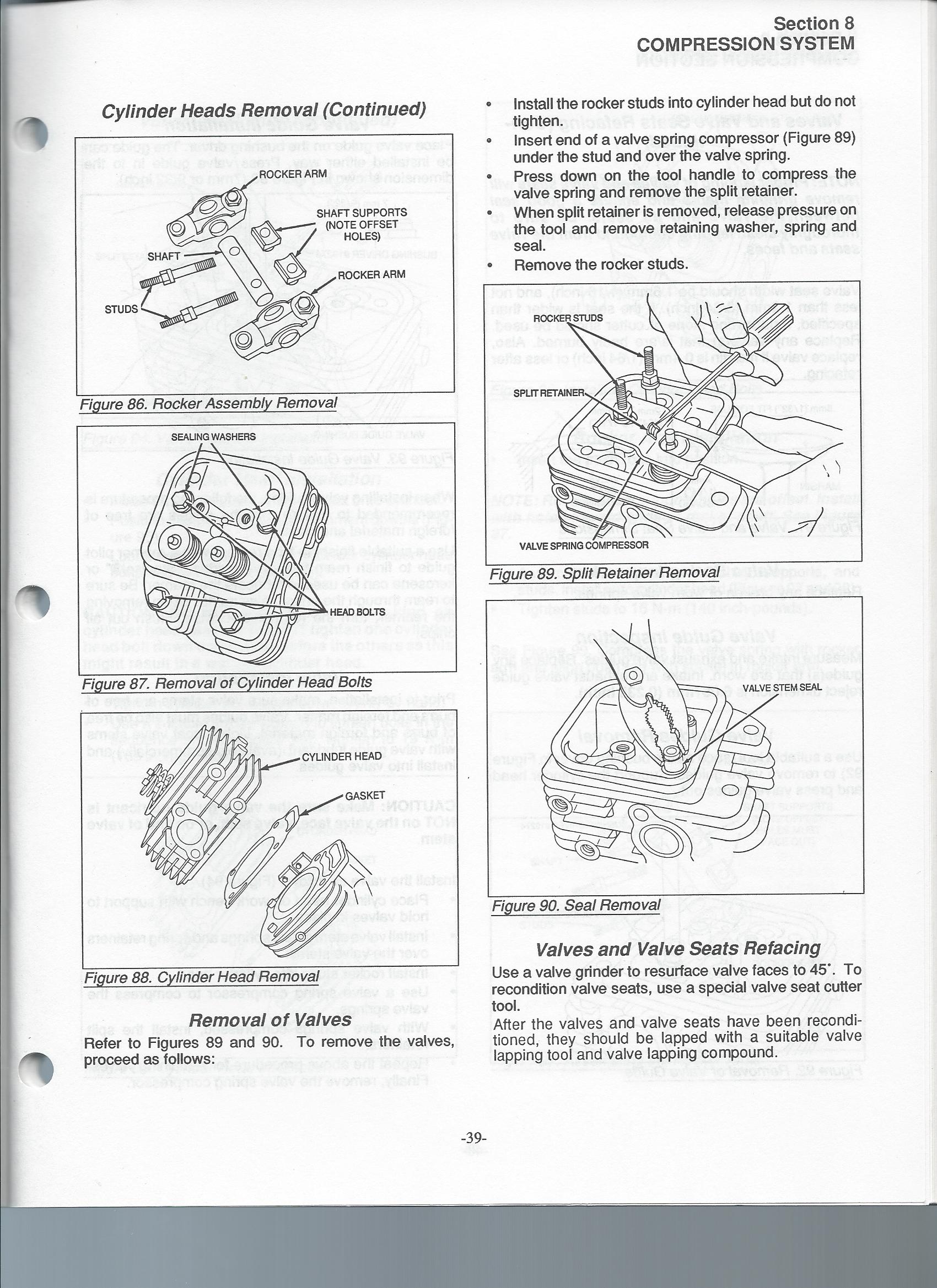

   / Generac 15KW generator engine tear down #33
Found this hope it might help..
#34
Thanks. That will help a lot of I end up rebuilding the heads. Still on the fence. Trying to get a hold of an old friend that rebuilt this very engine model for tractor pulling. They make about 90hp and turns around 9000 rpm! He should be able to tell me about where to get guides or inserts.
#36
Thanks again!
Once thing that caught my eye was that in the pages you posted above, the heads use 4 head bolts, where mine have 6. Also, there don't appear to be any push rod guide plates on those heads.
When I Google the valve guides part # 67813, I get a lot of links to 8kw Generac RV generators, but none to the GT990 engine I have. Do you feel pretty good about those guides being the same ones used in my 6 bolt heads?
