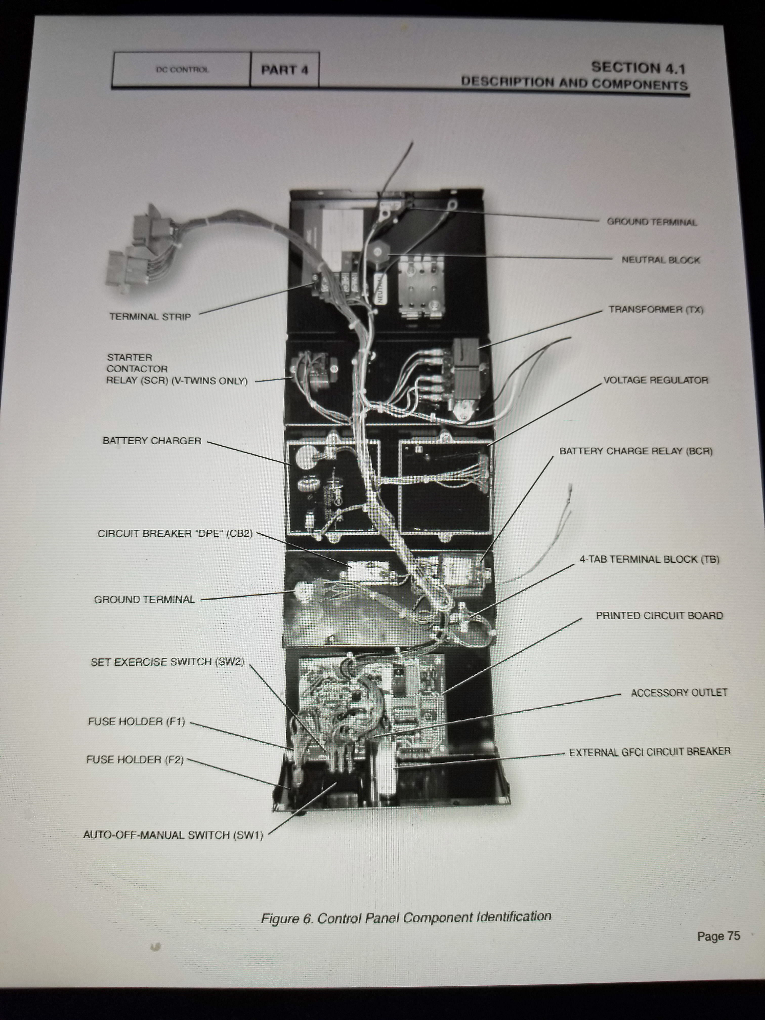

Most standby generators must have some kind of continuous charging method. You didn't say if it had one and simply wasn't doing it's job or the machine was relying on the excercise time for recharge.
Sorry to be unclear.
This unit has a built in charging system. I just don't know how it is supposed to work. But I do know that it doesn't work. ;-)
I also thought the exercise time would self charge the battery, but it fails to do so.
I was hoping the Generac knowledge base would aid in my learning. I have the schematics, but have no instructions on how to diagnose the system,
   / Generac 48kw generator: DOA, Generac unable to repair/not helpful #92
I dont know how old your generator is, but since you state a transformer, i assume its around 2008 era generator. i would need a serial number to cross reference it truly.
the older units have a transformer within the generator control panel area, and a relay. the relay swaps between utility supplying power to transformer and the generator windings while running powering the transformer. theres also a battery charge module. View attachment 670640
transformer should show 16 volts aprox at both sets of upper terminals. theres 2 set of 16 volt AC output on the transformer. since your getting voltage at transformer, i bet your issue is with the battery charger itself. ive had to replace quite a few of these over the years. you need the serial number of the generator to verify proper part.
It's very possible that the charger is bad. You can test for AC voltage on the input wires at the top of the charger (the smaller 2 wire connector) and should read around 19 VAC. The output is measured in DC voltage and will be the larger 3 wire connector that only has two wires (no wire in the middle spot). Output should be around 13.5 VDC on those 2 wires. If you have AC input and no DC output, the charger is bad. but, before you do this test you should start generator a few times to draw down on the battery reserve. if the battery is fully charged, i sometimes see no voltage at these terminals. best to be sure battery isnt fully charges. the battery charge module is a 2.5 amp trickle charger.

That picture is exactly what I saw with the panel open and poking around with the meter probes. I'll study it more!

The battery was down to 12.2 V, After I installed it two weeks ago fully charged. So two auto run cycles (Wed at 1:30) it should have been asking for a charge. I did a manual start, and it kicked roared to life without cranking toooooo long. So, not dead yet.

It has been awhile, and I wanted to give you all an update when progress had been made.
Thanks for all of the helpful tips and advice. You all have managed to get my neighbor on to a working backup power solution. Many thanks!
So...what was done?
The primary fix was Generac coming out and they installed a new ECU version 280 and controller version 1.07. The surging problem under (partial) load issue was fixed.
We have had a couple of outages since the updates, and the generator has worked flawlessly, even texting the owner to let her know that it was online and producing power.
There are a few to dos: finish the re-piping to the recommended size, test under full load, and upgrade the propane tank from 500 to 2000 gallons.
