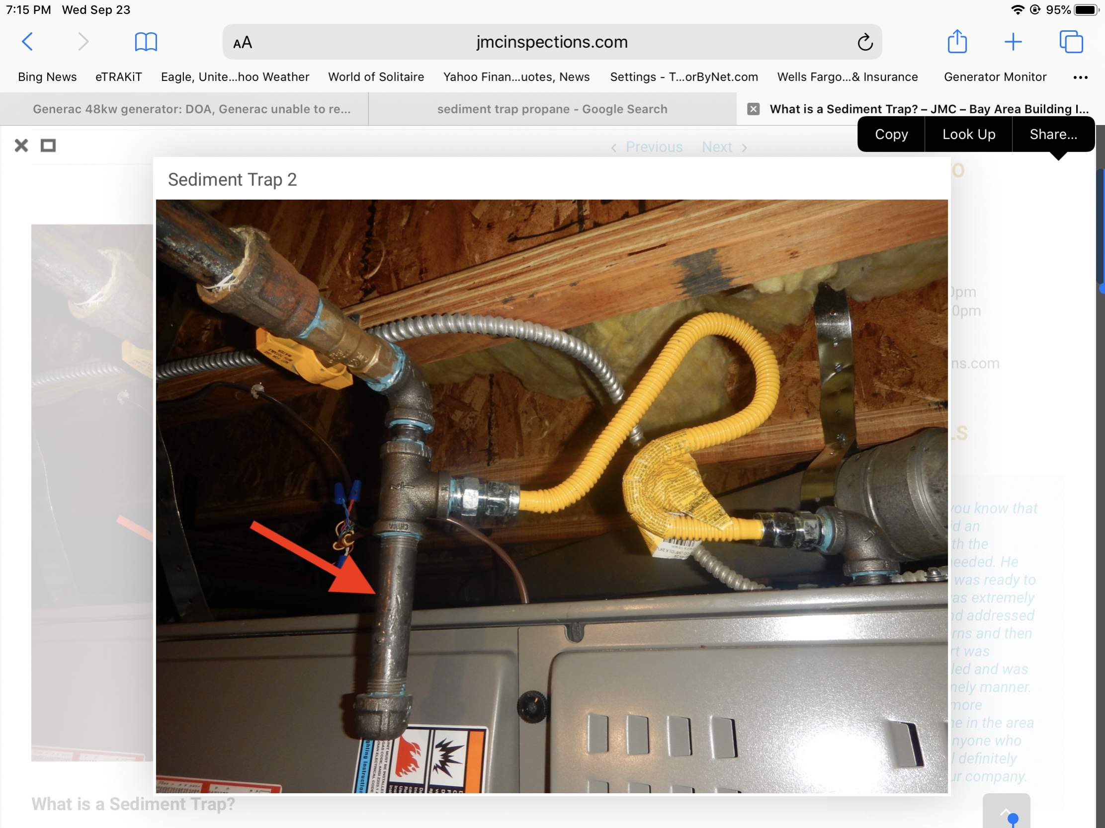

The op’s unit may just have never been set on controller for propane. A simple fix. But not having proper sediment trap on a propane system is a certain future failure issue. You would not believe the junk that gets trapped there. Would not want that going thru my carb.

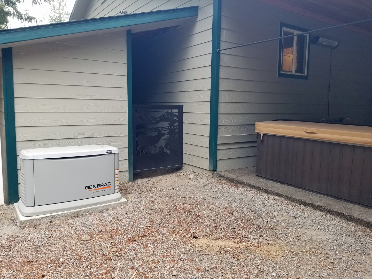

Diesel gens are sure nice. If i had more power outages or were subjected to prolong outages like eastern seaboard weather related issues, id have one myself. But in 4 years i only have 50 hours on my generator. Also, where i placed my generator, right next to my patio, i like the clean look of the generac system. 20200923_171818.jpg 20200923_171827.jpg

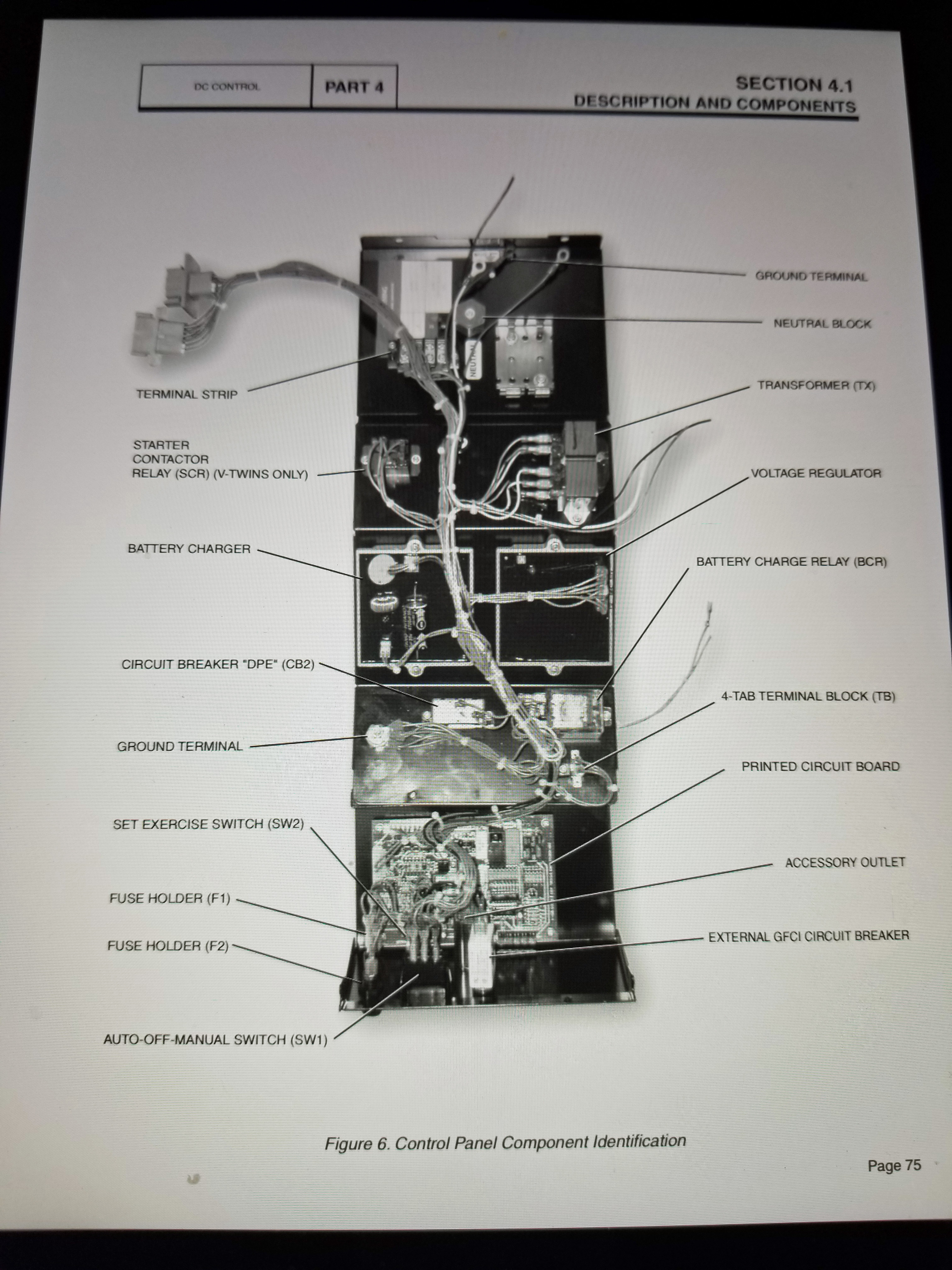

I'm trying to help an older single gal (in her early 80s) with a 15 kw whole house Generac unit that doesn't keep the battery charged.
After a month or so of once weekly auto runs, there isn't enough battery to start the propane Kohler.
Checking around with a meter, the fuses are both good (5 and 15 amp) and power is getting through after the fuse. The transformer is putting out 15 v.
Any "Usual suspects" to look into? I don't quite get the function of the relay... I need to study the electrical schematic more.
I've got the unit on a battery tender now. stop gap.

I dont know how old your generator is, but since you state a transformer, i assume its around 2008 era generator. i would need a serial number to cross reference it truly.
the older units have a transformer within the generator control panel area, and a relay. the relay swaps between utility supplying power to transformer and the generator windings while running powering the transformer. theres also a battery charge module. 20200923_173849.jpg
transformer should show 16 volts aprox at both sets of upper terminals. theres 2 set of 16 volt AC output on the transformer. since your getting voltage at transformer, i bet your issue is with the battery charger itself. ive had to replace quite a few of these over the years. you need the serial number of the generator to verify proper part.
It's very possible that the charger is bad. You can test for AC voltage on the input wires at the top of the charger (the smaller 2 wire connector) and should read around 19 VAC. The output is measured in DC voltage and will be the larger 3 wire connector that only has two wires (no wire in the middle spot). Output should be around 13.5 VDC on those 2 wires. If you have AC input and no DC output, the charger is bad. but, before you do this test you should start generator a few times to draw down on the battery reserve. if the battery is fully charged, i sometimes see no voltage at these terminals. best to be sure battery isnt fully charges. the battery charge module is a 2.5 amp trickle charger.

The op痴 unit may just have never been set on controller for propane. A simple fix. But not having proper sediment trap on a propane system is a certain future failure issue. You would not believe the junk that gets trapped there. Would not want that going thru my carb.
Hmmm... I wondered about that. You might notice in the photo that I posted above that the existing, to be replaced, piping doesn't have a sediment trap. What do you recommend? "Tee" style? Screen?

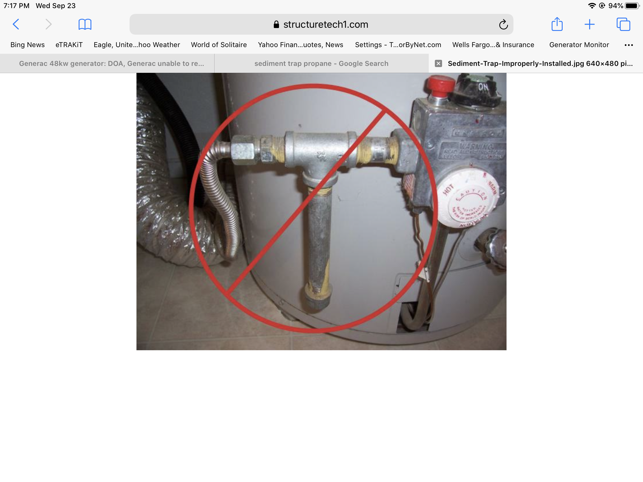

Gas has to change direction. Like this F86C7C07-4658-4E29-BEEC-75C24828B7EB.jpg. Not like this E32346AB-F919-4E04-B837-3298109FD278.png
