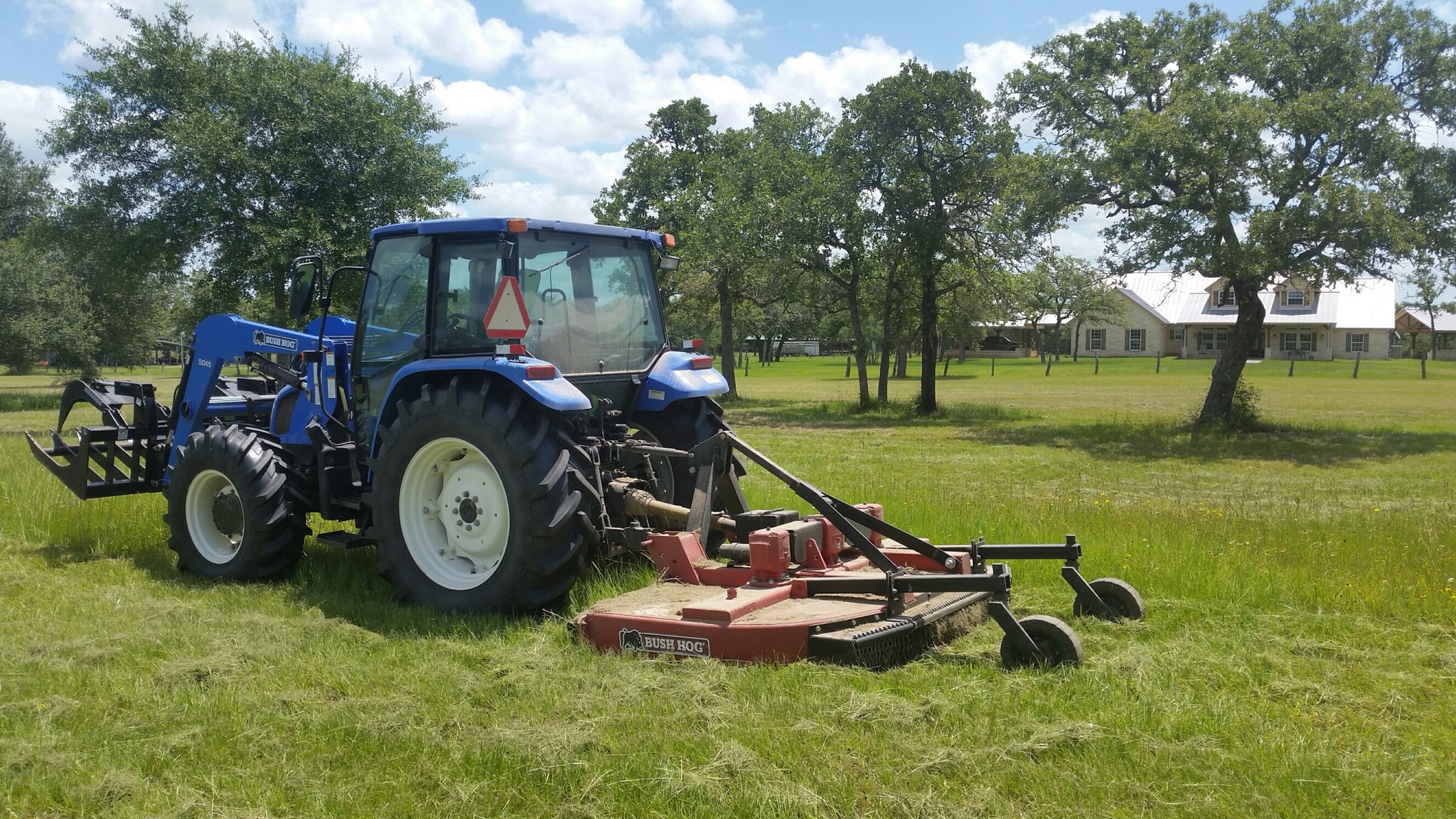

IMHO, you set cutter rear height with rear wheel(s).
You set front height with 3 point lower arms.
The top link needs to be able to float to let rear of the cutter to follow terrain. Most high end cutters have this built in. Mine sure do.
Some even connect top link with chains so, the cutter can float.
In fact, you could cut very well with top link unhooked.
Not sure where you’re getting your information but, it’s not correct. What model cutter do you have?
   / General bush hog questions #24
RSKY;

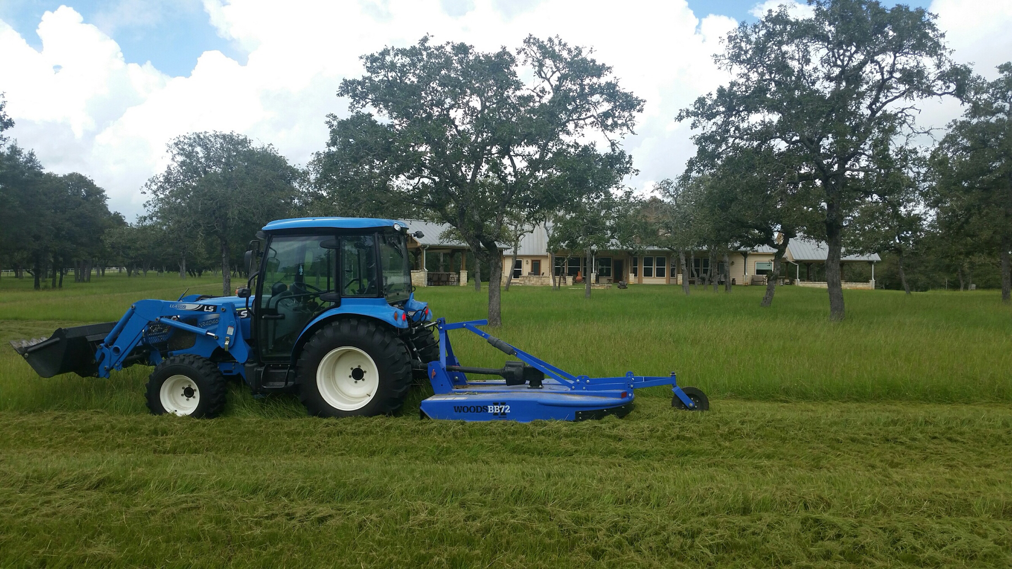

Bush Hog 3008. Upper link connected to rear of cutter with tube inside of tube to allow rear of cutter to follow terrain.
Woods BB72 Brush Bull. Jointed upper link to .......... allow rear of cutter to follow terrain.
LS 84” Rear Finish Mower. Slack in upper link to keep Mower on it gauge wheels.
Taking float out of upper link would result in a really crappy cut if terrain was not pool table flat.

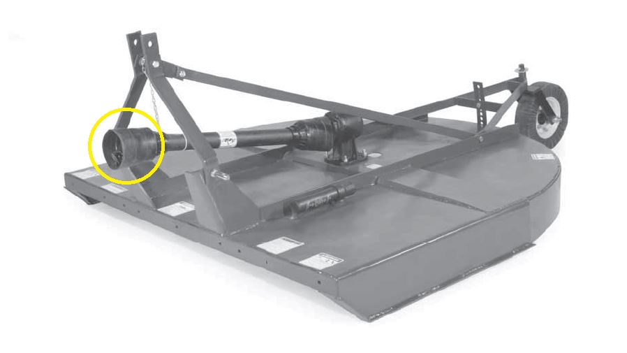

This is what the boot area on mine is like. You can see how the boot is longer than the connection. Just makes it real difficult. Maybe not cut that boot entirely off, but several inches back so I can see and manipulate the u-joint and collar connector?
I can't have the PTO running and be out of the seat. I can't think of any good reason for me (or anyone) to ever be anywhere near the rear of the tractor with the PTO engaged. This is the only shaft-driven attachment I have though - maybe a log splitter or something else I guess there could be a reason for someone to be somewhat near that area.
I wouldn't cut right next to a person or vehicle or anything I wouldn't want shot with a rock. But if someone else is in the general area, what is a safe distance that anything flung out by the bush hog isn't a big threat? 50 yds? 100? So far it has hit some decent rocks but just made a lot of noise and hasn't sent anything flying. But am assuming it easily could launch a rock in any direction.
No kids running around my property. Mostly just me there unless my wife wants to come along and split some wood (no idea why, but she really likes splitting wood), pick grapes & berries, etc.
If the "bell" of the plastic is protruding past the end of the PTO universal joint, then by all means move it back so you can access the PTO to hook it up. This can either be done by trimming with a knife or perhaps it just needs to be slide back on the PTO shaft a bit. It should never extend past the end of the universal joint.
