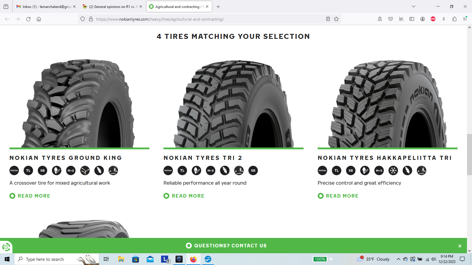

I have never heard of a Nokian R14. I run Nokian Tri 2 on my tractor. They are a direct swap but not R14's. Do you have a link to them?

I'm wondering if the R14 type is just used in the US and Nokian has its own classes/types. ??
Agricultural and contracting / Nokian Tyres
The ground king comes the closest to the R14 design, The TRI 2 is a more highway oriented tractor tire, and the Hakkapeliitta is the snow tire version.
Goodyear / Titan have the R14 some of the other manufactures have there own tread patterns available.
The tread pattern clearly says they ain’t R-1 or 4. They are not turfs so what’s left?
Fact is I like them for what surfaces I want to use the machine on.
