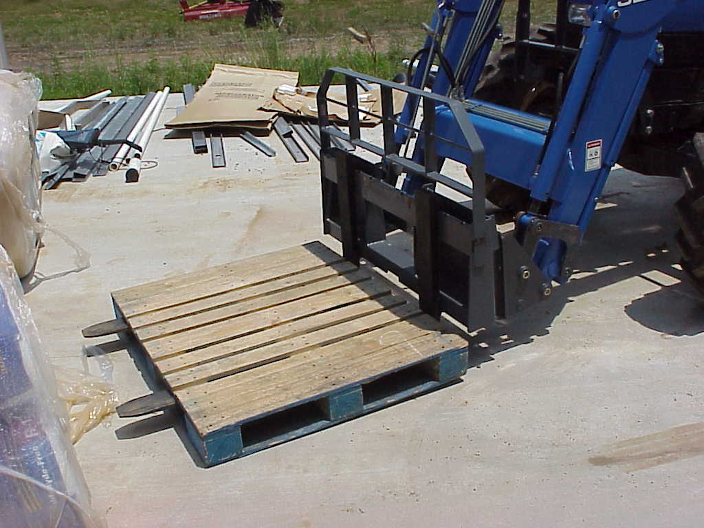

I also don't see the benifit of the MSL in proportion to the additional cost. My unit without MSL is fantastic. But get the quick attach!! I am not sure if you dealer offers any without it but its worth every little penny and then some. The cool thing about this is its bobcat compatible. So you can buy cheap bobcat attachments and use them with your TN! I have a set of forks which are very handy (see attached).
