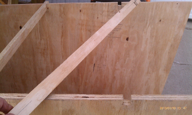

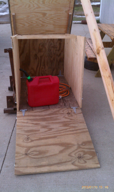

Here's some pics of the generator dog house. Two walls are hinged and are used as ramps to roll the genny up and down, the other two walls lift off completely.
The roof lifts off as well. The two cross braces are half lapped and are removable. I drilled 4 holes for removable nails to pin the roof to the walls in each corner so it can't blow off. Little hasps hold the 4 walls in place.
