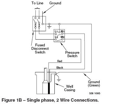

I recently bought a house that is supplied by well water. I need to wire up my generator to run the well, and time does not permit a 'proper' installation. What I think I want to do is isolate the well from the house wiring at the switch, and power it with the generator. I'll use extension cords for the inside stuff. Here is the kicker- my well pump is a two-wire model. The way it's wired now is there are three wires running to the top of the switch (red-black-white) and two wires from the bottom of the switch to the pump (red and black). There is no neutral wire from the pump. The grounds are all present and connected. Can I do the same thing with my generator? I have the proper wiring and plug to do it, but I am concerned about running the generator with the neutral disconnected. Does the generator care?

The gen don't care.

Dusty, please do not take this as an attack...BUT if you have to ask why there is no neutral to your 220v pump then I think you need to get help from someone who is more qualified.

And the professional would be right, there should be a ground wire tagging along there somewhere along with the two hot wires like in the diagram jim brown posted.
Don't get neutral confused with ground. Although they are typically tied together, they are not the same. Your generator has two 120V windings in series. Measured from end to end you get 240VAC. The neutral wire runs to the middle where the two 120V windings join, and is the return wire for 120V from your generator. In summary, end wire to end wire = 240VAC. Either end wire to the neutral wire = 120VAC.
The 240 VAC load has no use for the neutral wire. The commercial power feeding your house is the same. Two hot wires, each connected to the ends of a center tapped 240V step down transformer out on the pole. This transformer provides 240VAC down from whatever the line voltage may be(thousands of volts?). This transformer has the same center tap as the generator does to which the neutral wire is connected. The neutral is connected to ground at several places for safety purposes.
Your generator Should be able to be wired into your well pump using the 240V receptacle on the generator. That receptical consists of 3 prongs. hot, hot and ground... You will need a compatible plug to wire this 240V power into your pump switch box. You should be able to then plug in your 120V loads using the 2(or more) 120V recepticals usually provided. Some generators have a 4 prong receptical which consists of hot, hot, neutral and ground. This type plug is designed to feed a 120/240 distribution panel, much the way that the commercial line feeds the main power panel in your home and provides for both 120 and 240V loads.
