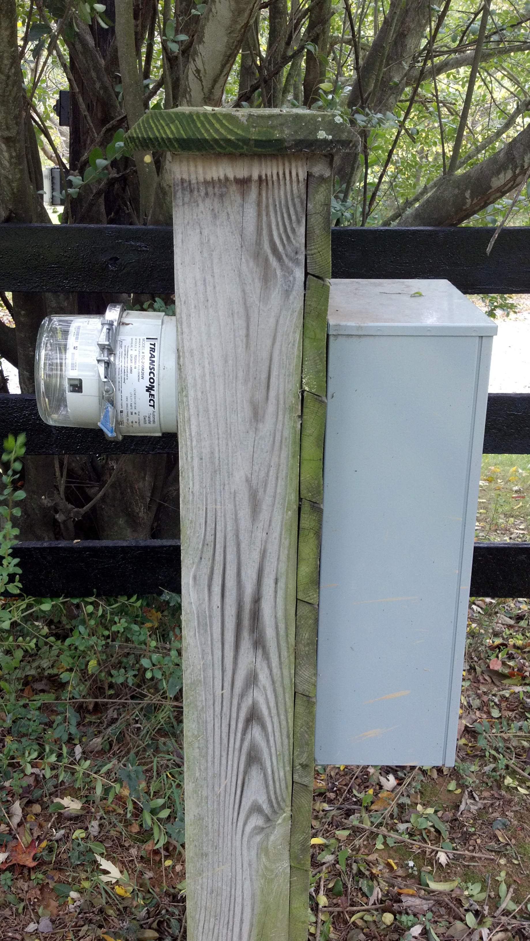

Here are photos of what I described earlier (400A service with two exterior disconnects each feeding a separate 200A interior panel):
Yesterday I opened a service inquiry with the utility and sent a note to PSP to find out which Transconnect model would work for my configuration. I just read through the other thread you referenced - thanks!

OK, first... by seeing your pictures, you could use the retro-fit style. You are actually using the dual lugs from the meter which is 200amp service. You would use whatever size fits your situation. Do you have enough room for a box about 20 inches by 30 inches about 3 inches deep? Located next to the meter by that cord from behind the meter. That is the box with the electronic brains and switch gear.
Who is your Utility service?

We are served by Potomac Edison (FirstEnergy) and it is supposed to be 400A service ("heavy-up" completed in 2012); those two exterior disconnects feed separate 200A interior panels, and one of those panels has the 100A circuit that runs to the subpanel in the barn (conduit visible at far left). Wall space is limited there but the additional box may fit above the meter enclosure.

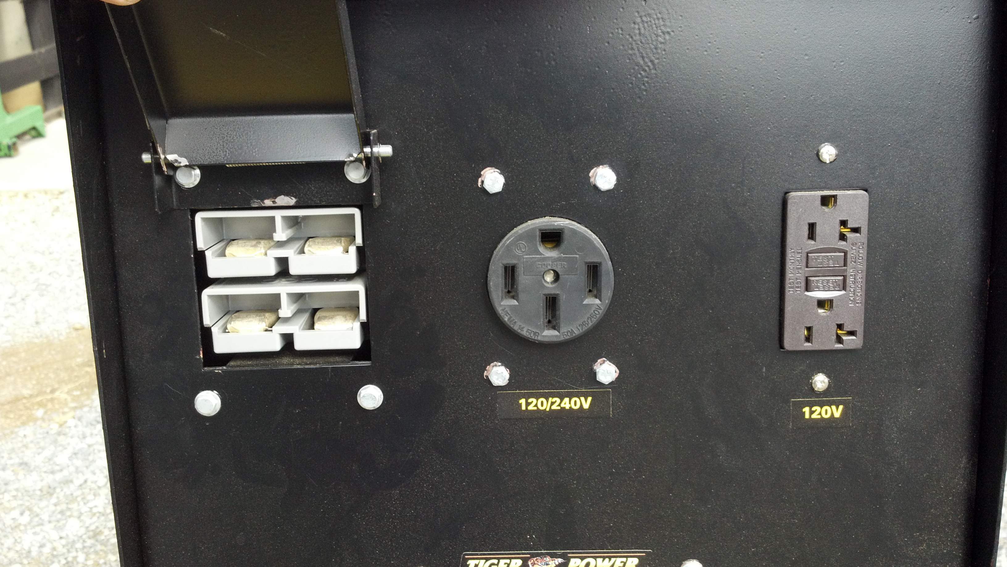

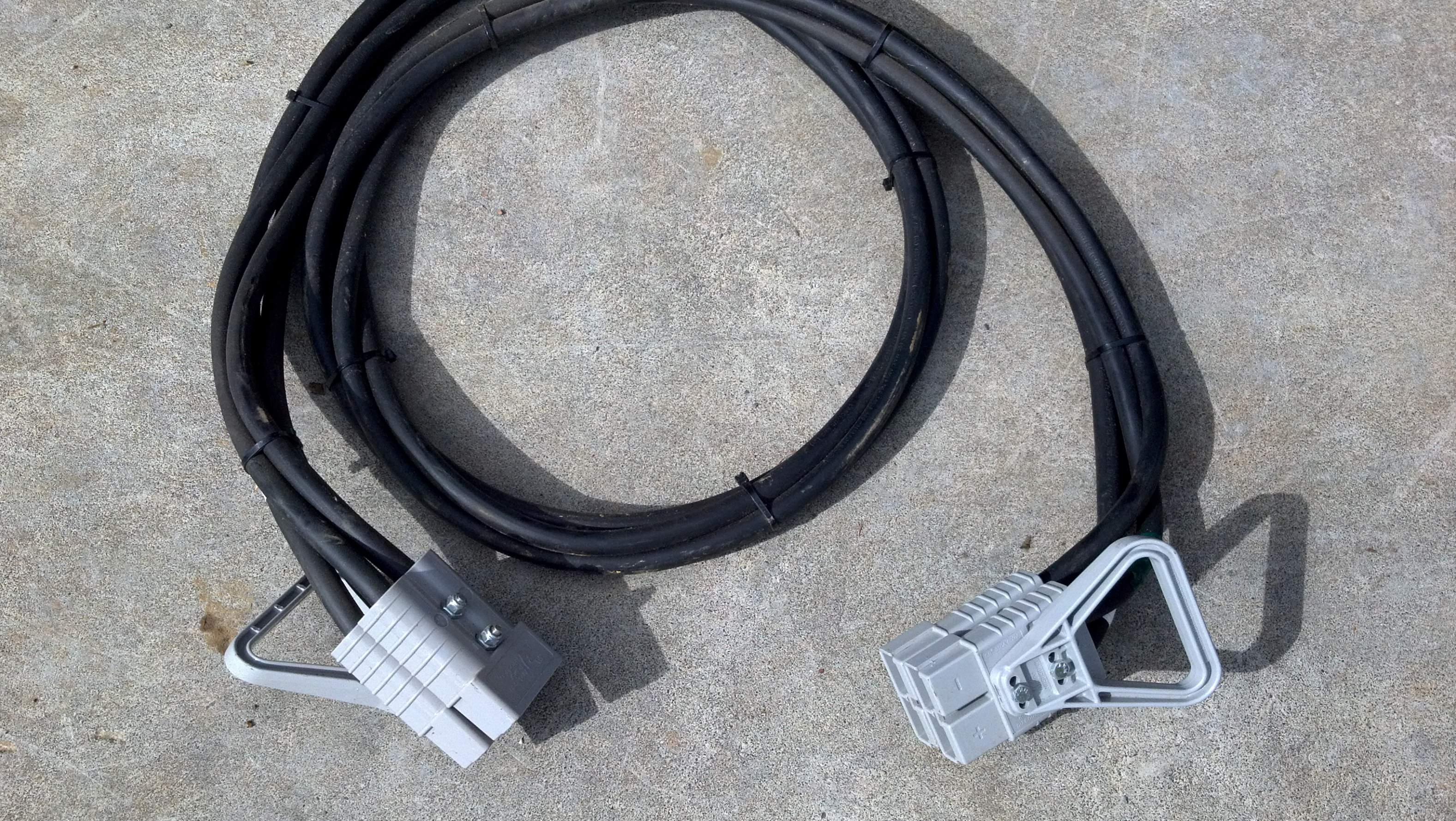

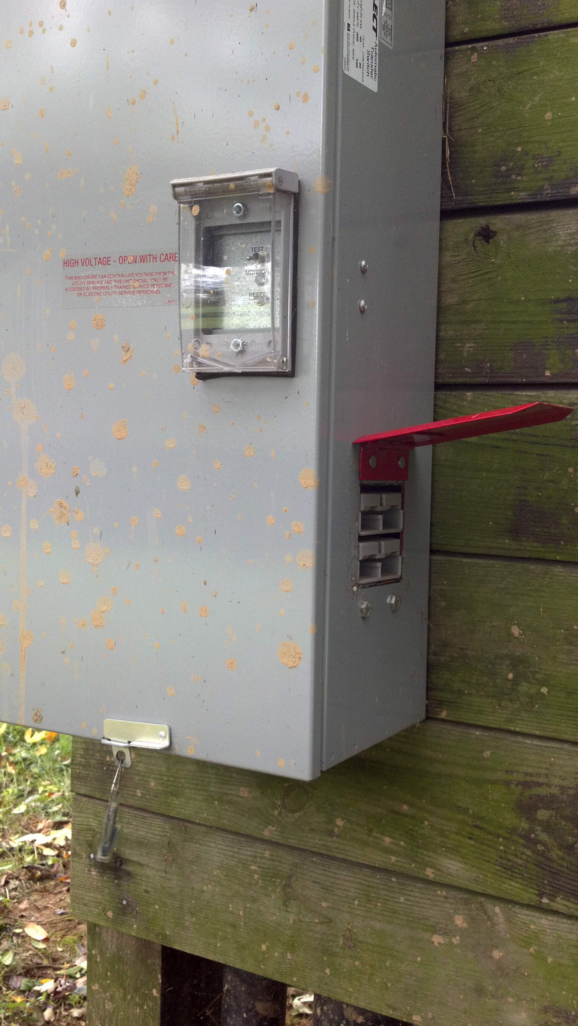

Howdy,
Here are some views of the second brains box and the full power plug connection.
