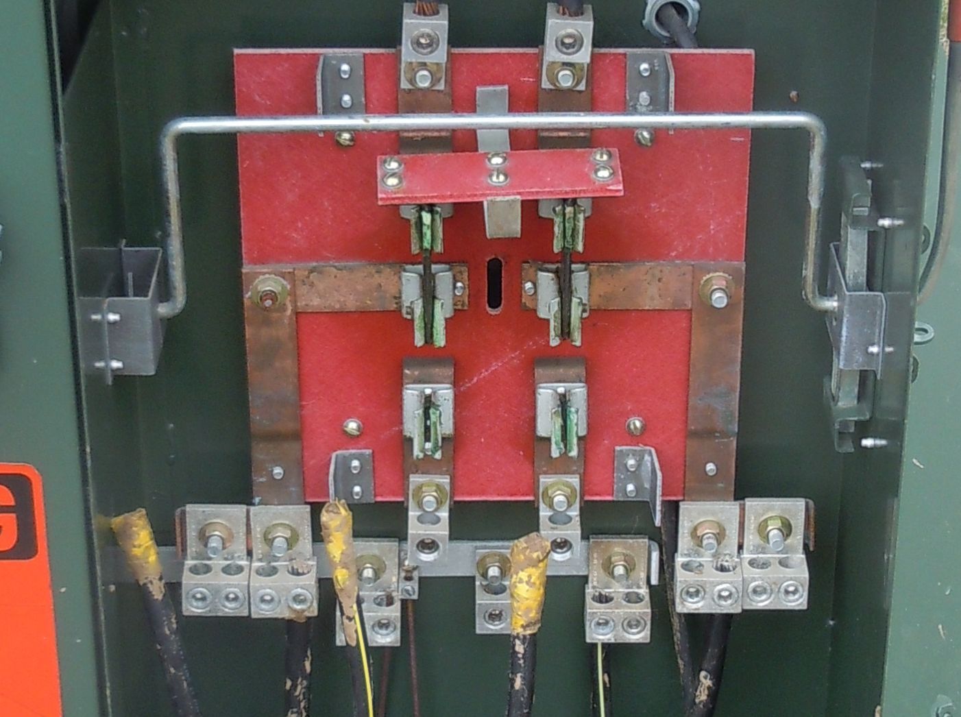

I have a tombstone by the transformer. It has a switch allowing selection of the grid, all off, auxiliary power. If I use a generator I could connect the cable on the AUX terminals of the switch and select auxiliary power. It is simple, no back feeding is possible but it isn't automatic.
The switch is in Grid position.
Handle in horizontal position is all off.
Handle pointing down is AUX power.
I could possibly leave the handle in off position and wire in some way kind of transfer switch to make it automatic.

   / Generator backfeeding into utility lines #94
That would work, it's basically a double throw 2 pole switch.
What do you have connected to the aux lugs now? Is it wired for a generator input somewhere on the house?
Also another set of wires not connected, is that for a future shop/ barn.
I see the double lugs for the load, good idea.
The good thing about that is you can totally disconnect from the grid, from the transformer forward on your property, so you could work on your main panel or whatever with no juice in the box or anywhere in the house. the only bad thing is you have to go out in the yard to operate it.
I don't think you could ever make that automatic though.
JB

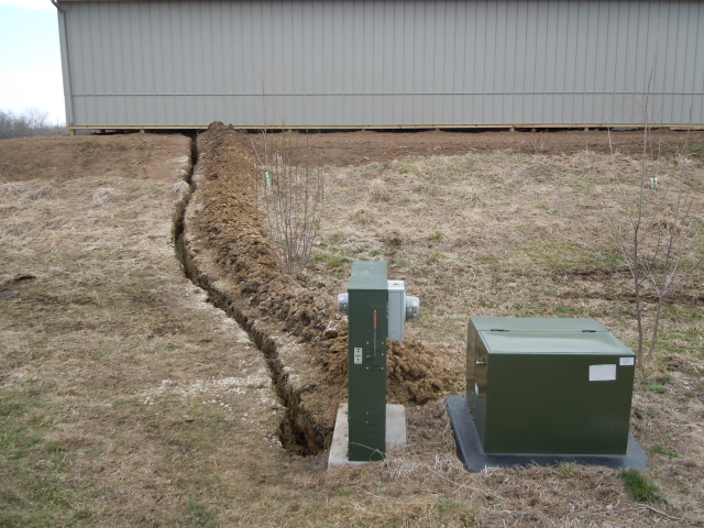

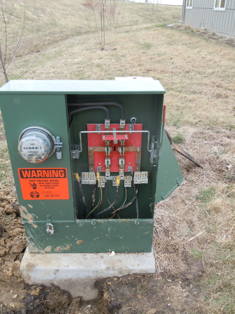

   / Generator backfeeding into utility lines #95
The tombstone was installed by the power company. The transformer is just behind it. This is where they put the meters. The tombstone has two sides. One is locked and sealed. There is the total power consumption meter. From there are wires to the switch on the "user" side. On the "user" side is also meter for heating.
At this point there is nothing connected to the AUX. The neutral lugs (on the bottom in the middle) look like (in the picture) connected to the AUX terminals but they are not. The picture shows the switch before I connected the wires for the shop.

   / Generator backfeeding into utility lines #96
Ok I see in the close up, thanks.
You could of run extra wire in the trench for the aux line. or are you thinking of just putting the generator right next to the meter/ switch. That is, if you have plans for a genny at this time.
I'm sure it must be deceiving in the picture, but it looks very close between the neutral bar/lugs and the hot lugs.
JB

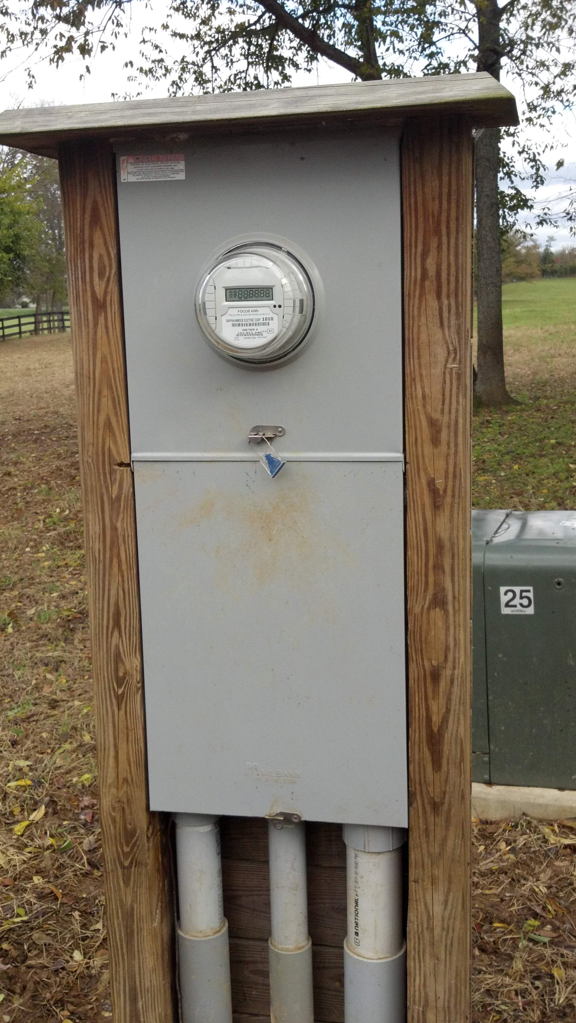

   / Generator backfeeding into utility lines #97
Howdy,
Generlink is made for 200amp service. It is a collar which extends your meter out about 4 inches. There is a special cord end which plugs into it. see picture below. The generlink unit favors generator power. In other words, when you attach the cord, your meter disconnects from the utility, and your on generator power. That is how you test. 3 little lites along the bottom by the plug tell you if utility power is waiting on the other side. If its not lit, then the power from the utility is not there.
30amp Generlink cord set
For larger service
I too have 400amp service at a central farm distribution point. It was easier and cheaper to have my utility put in a special hook-up. Transconnect unit. Similar to the generlink, a special collar moves the meter out about 4 inches. It then has a special pigtail which connects another box. The other box has all the automatic transfer and disconnect circuitry. I have a full power plug (dual modular anderson 350amp gray with 2/0 pins) The same which is on the pto generator. see below
View attachment 237146 View attachment 237147
View attachment 237148 View attachment 237149
This really works well for me. I have feeds going out from here to the shop, run-in shed, barn, and large house. Each with there own panels.:thumbsup:

   / Generator backfeeding into utility lines #98
Howdy,
That unit looks really nice for a new installation. I too would suggest that anyone with a new installation look into having a meter with switch like this, or a panel with gen lockout kit. Like anything, it is a lot easier to start with these plans in mind, and build it that way. Coming back later, just involves so much more work and changes. I used a Milbank rural service meter panel outdoor 3r combo with generator lockout installed for a remote Ag well.
