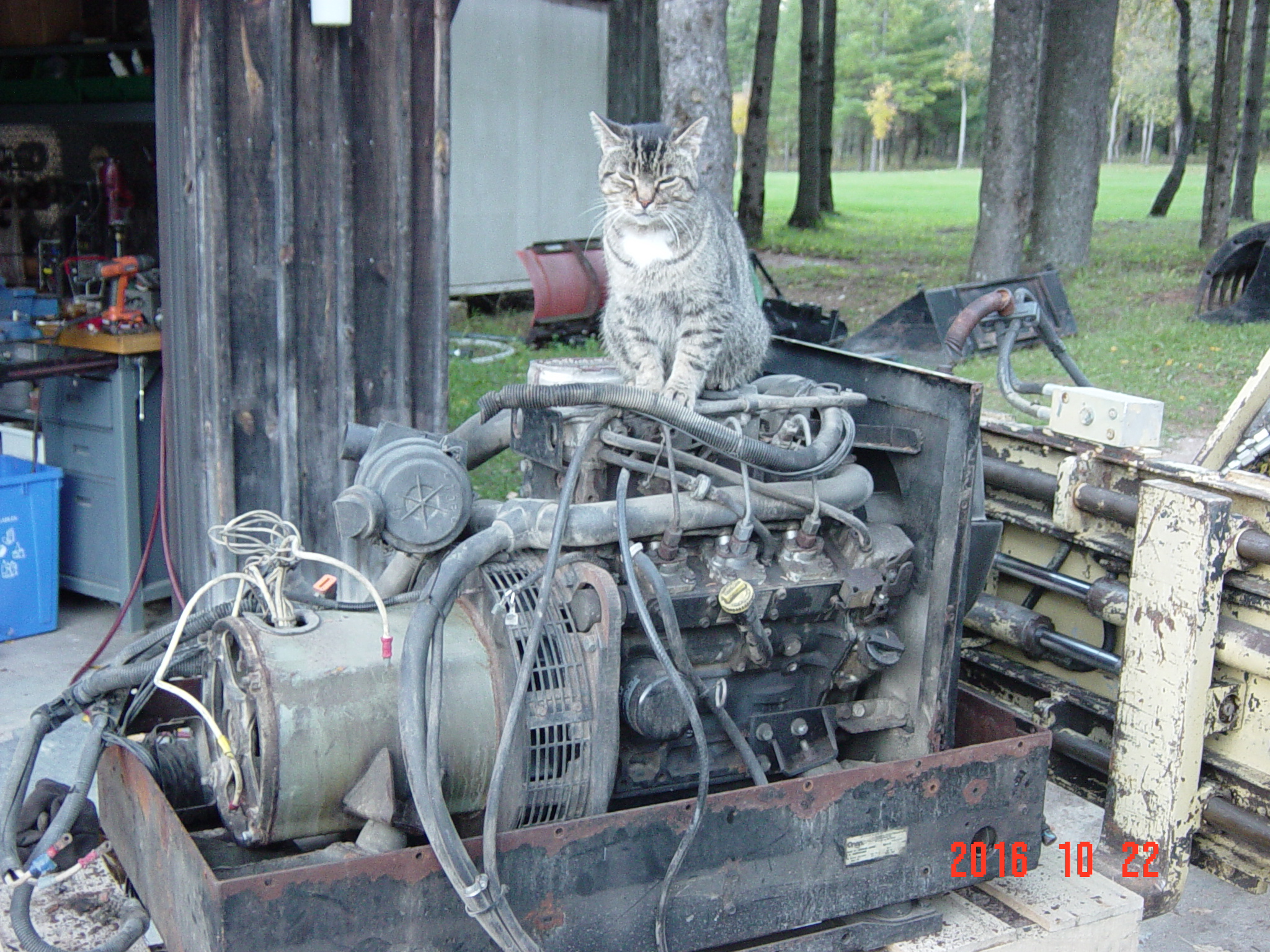

Went with a 12.5 kw Isuzu in 2012, and it does the whole house just excluding 4 ton heat pump, carriage house and swimming pool pump. Real fuel sipper at 0.25-0.3 gph. It's a real gem from Central Maine Diesel. Put in a new Gentron auto transfer panel & moved breakers around between its 200 amp panel and the other 200 amp panel.
