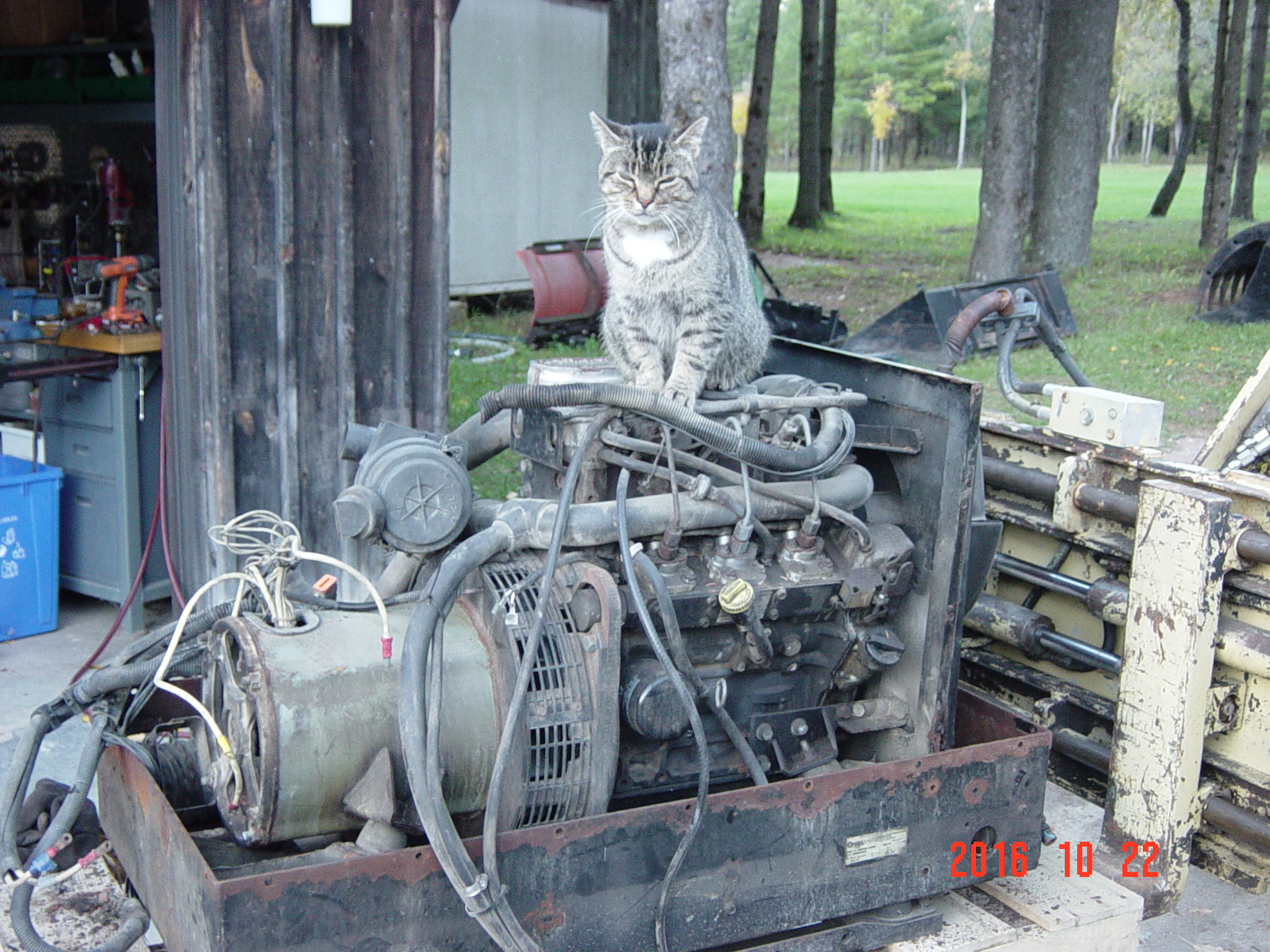

Onan's 12.5KW version with the Isuzu Motor. Project was coming along nicely and got pushed to the back burner in favour of a 7.5 Commercial Diesel Inverter unit, that was supposed to be a quick and easy side project!
Isuzu is the nicest running Diesel engine I own.
that engine sounds like its going to PURR
/ generator brands/types #22
Ralph,,,, What brand and model number is your generator? Your running 3 times the load my little Honda EU2000I . about the same fuel usage. Might have to step up to a new generator. I have to run a separate generator to run the well pump when needed.
The driver is Isuzu 3CE1 engine. Not sure what the generator actually is. Think it's Italian.
Ralph
/ generator brands/types #23
I suspect that this is the unit:
Isuzu 12 kW Diesel Generator
Yes, that's it. I found the actual fuel consumption curve some place and determined that the consumption would be about 0.25 gph at our average kw of 2.5. That's about what it has been. I keep track of all the fuel that goes in and out (use some in the tractor).
Ralph
