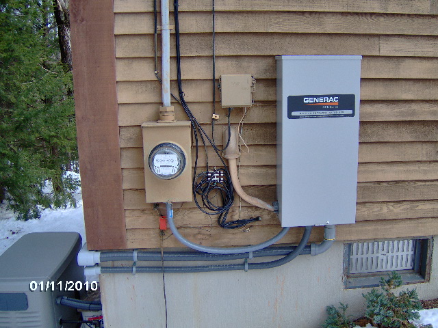

I have some more info. I had a generator installer come out and take a look. It seems that I have to take at least 10KW load from the heat strips off the generator load. Those are on separate breakers from the AC load so that would put to total load up around what everyone has been saying. I apologize for doubting the experts here. I dont have the luxury of walking out and looking at the breaker box since I am 7000 miles away at the moment. I dont know if he is removing all of the heat strips but it would be at least one circuit. I wouldnt think we would need more than that in capacity since a cold day in Ark is 20F where as in Idaho it might -40F.
Anyone like to volunteer some typical installation cost for installing a 20Kw genset and 200 amp automatic transfer switch. I would be setting the genset myself and getting the gas company to hooked up propane line . This would be electrical side of the installation only. I have a price from the one installer and would like some info on what others have had to pay.
   / GENERATOR BUYING #47
Here is a pic I found of a very simple install.. Kinda ugly but what the customer wanted.. I already sent you the piecing in a pm..
