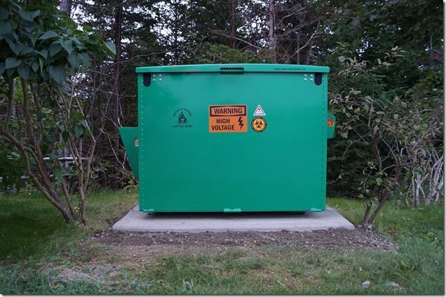

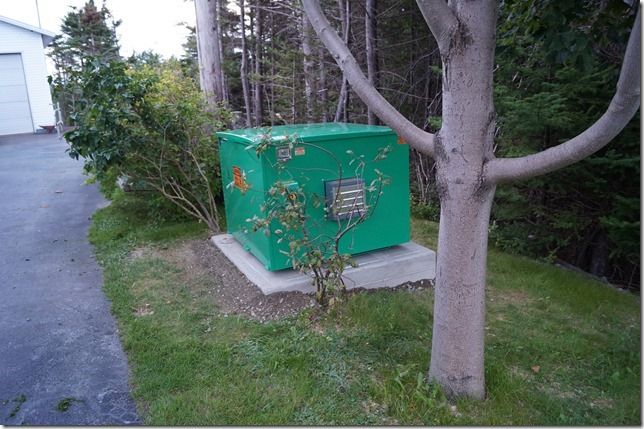

I looked everywhere for an inclosure to put our generator in. I looked at those plastic boxes, plastic sheds... Couldn't find anything that was secure or fireproof. I needed something that would take a hit if a tree fell on it and I wanted a theft alarm system in it. Couldn't find it so I had to build it. Took me a week to fabricate. It's made out of 1/4 and 1/7th plate. Weighs in at 1500 lbs. I wanted a portable generator because I can use it at other tasks around the property. I put the Honda wireless remote starter on ours and I'm using a Square D transfer switch in the house.

I like your shelter, great job!!
How did you run the exhaust out?
Thank you. You'll notice I made a stack to exit the rear of the inclosure. I also machined a special flange that goes right up to the muffler to mate with it. It's a tight fit yet don't require any tools to connect. It has a few added features as well. I did a video on the unit.
- Built out of 1/8th and 1/4 steel plating. Complete system weighs 1500 lbs.
- Custom machined hinges with grease nipples.
- Built in security system.
- Canarm fan for system cooling
- Double stainless steel latches both coded for the one key.
- Hydraulic struts to keep lid open.
- Fold down front section that acts as a loading ramp for the generator.
- Special locking system in floor to hold generator in place.
- Custom exhaust system with top flapper.
- Wireless remote start added.
- Snap-On L.E.D. light added.
- Floor mat that chemical resistant.
- All openings have restricters added to keep critters out.
- Sand basted to remove mill-scale, epoxy primed and painted.
- Custom graphics by Kathy (Wifey)
- G.P.S. Tracking on generator.
- Pour a concrete pad to bolt it too.

Very nice!
