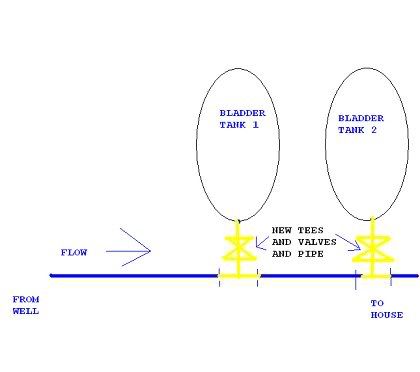

3RRL, you are overcomplicating it.
Yes, in your supply line, after the pump, before the appliance, cut out a section and put in a T, the straight leg is in the line, and the "base" of the T is too the tank. (really does not matter) No regulator, valve etc. etc. needed
It is just holding a "cushion" of water to work against.
Exactly what I did.

Interesting about having more than one bladder pressure tank.
I'd like to do that for the same reason of having longer pump runs and longer pressure available between pump runs.
When you say "T" it into the supply line, could show a simple drawing showing the supply line, the two tanks and pressurized exit line to the house or wherever? What about the on/off pressure regulator valve(s) that tells the pump to come on and shut off? Is there just one now or does each tank have its own?
Rob how is this?

Rob,you could just 'Tee' in at the house and stick an extra bladder tank in that killer crawl space. It will do the same thing but it will be out of the sun. could even help if a heavy draw(several things using water at the same time)caused low pressure in the house. I added a huge one next to the tiny one that was there, I tee'ed in before the water softener so I can run untreated outside for watering.

Thanks Tom, that's a good idea.
Since all my pressurized lines all run off the main coming from the first bladder tank, even if I put that one in the crawl space it would still add pressure on the main line just like if it was next to the first one, right. In the Summer, some of my sprinklers around the house run off that main too, so the additional tank would help with pressure closer to the house, I would imagine?
   / Generator Operation Question #28
It would help even out the pressure,once the pressure drops overall it won't help untill the pump catches up. It would be like adding one next to the present one but would make up for an under sized water main,looked like you had plenty of pipe size though. If you had low water pressure in the house while running the sprinklers you could stick a check valve before the new T. Water will fill the house tank and keep it at pressure but it wouldn't back feed to the yard.If the house calls for water both tanks will fill but if the house tank is at pressure and you are only using the outside water the pump would only be filling the outside one. With that well you would need a pile of sprinklers running to lose pressure .
