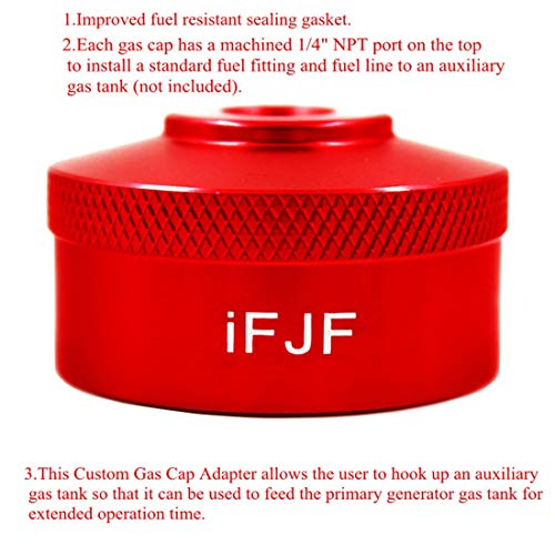

Many of the inverter generators can be had with a "Extended Run" cap that you use to connect to a larger can (such as a boat gas tank), then it will automatically fill its on board tank from the boat fuel tank. Here is one: Amazon.com : iFJF Aluminum Red Extended Run Gas Cap Adapter for Honda Generator EU2i EU2i EU1i EU1i fit 1/4"NPT Line(1/8" Thick Fuel Resistant Sealing Gasket with Each Kit) : Garden & Outdoor
Aaron Z
I don't believe that that cap will work with most generators. Honda is one of the few that has a fuel pump internally on their small inverter generators that can "pull" the fuel from an auxiliary tank. Most others rely on gravity.
