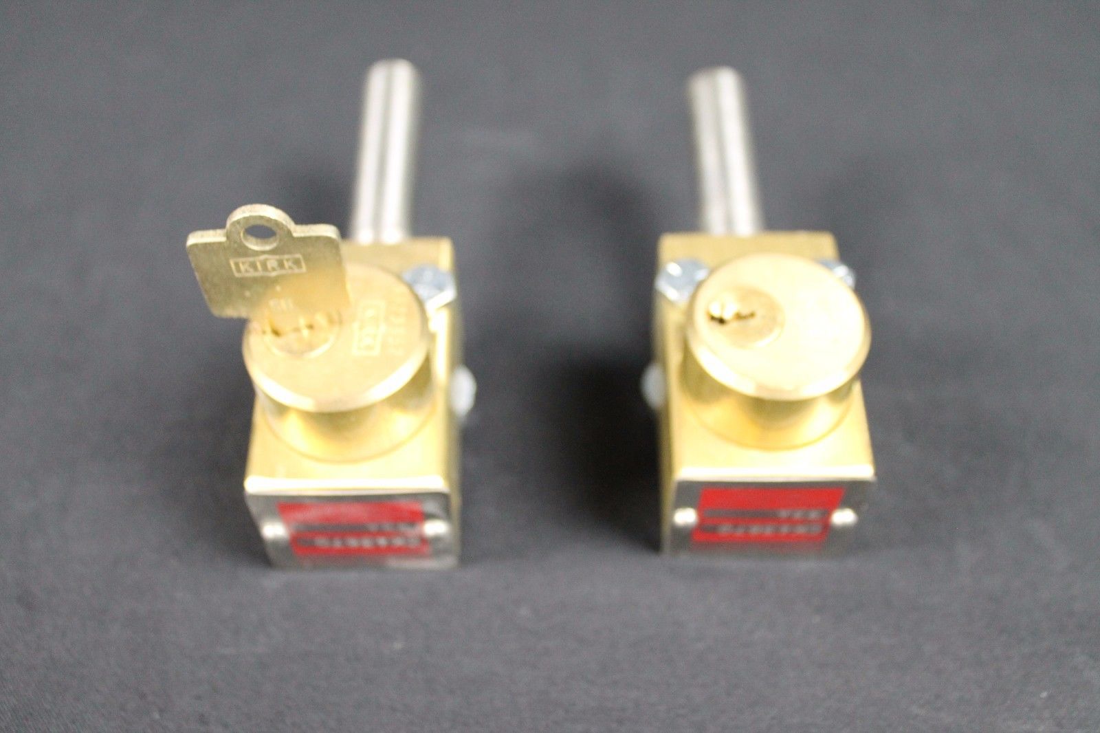

So to recap, you have a 6/3 with ground wire running to the subpanel?
If its not feasible to run a new wire from the main panel to where the generator is located, I would look into a Kirk Key type trapped key interlock system such as: Lot of 2 Kirk CK43670 Key Interlock with Key | eBay
Then one goes on the main breaker and the other goes on the generator breaker in the subpanel. The way it works is that in order to get the key out, it needs to be locked (with the rod on the lock extended).
In your system, you install one on the main breaker (so that the rod can only extend if the main breaker is off), and the other on the generator breaker (so that the rod can only extend if the generator breaker is off).
Then to switch, you shut off the main breaker, lock the main breaker interlock, remove the key, walk over to the generator breaker, unlock it and turn on the generator breaker.
The 2nd set of keys is to be stored in a safe place marked for what they are for and marked that only one set is to be used at a time.
Aaron Z
Very interesting Aaron, i didn't see any pictures of them in service panels but it sounds like a logical solution. would this system be acceptable to the safety police?
i have the exact same situation as OP, exterior garage with small sub panel about 50' away from the home's 200amp panel, and i just got
my old 5500 watt generator up and running and was looking for an easy way to power the critical circuits in the house from that garage panel.
I would imagine I could pull another set of wires but with this solution i don't see why i would have to. of course with a larger
whole house generator I would have the automatic transfer switch, but to get thru with the current gene this trapped key might be just
the ticket.
"I think the answer to your question is simply 50 Amps * 120 VAC = 6000 Watts...."
this is good to know, my 5500 watt gene should be ok thru my subpanel.
thanks
