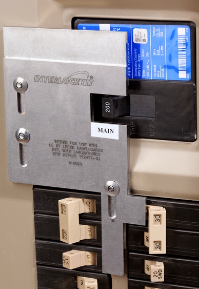

Define low cost. Most I have looked at were $600+ not counting the wire to feed the genset or to re-wire the meterbase to panel connection?
Also, its more flexible, why mount the generator next to the house (where it is in plain view from the road, is ugly and in the way) when I can put it in the barn where it is out of the way and can be locked up?
As for confusing the fire dept, how would it be different than a panel mounted interlock (such as a Square D HOMCGK2C)?

1/3 c. chopped onion
In skillet brown the crow breasts, then place them on a 1 1/2" layer of sauerkraut in bottom of a casserole. Cover each piece of meat with a strip of bacon and sprinkle the onion over them. Cover the breast with another layer of sauerkraut and pour sauerkraut juice over it. Bake two hours in oven heated to 350 degrees.
   / Generator question (household wiring to be more accurate) #49
I scanned the thread but may have missed this if it was already posted.
This is a block also but not a secure as a Kirk switch by any means.
