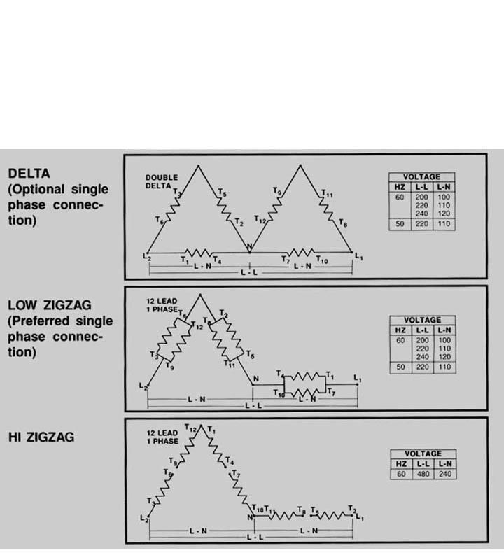

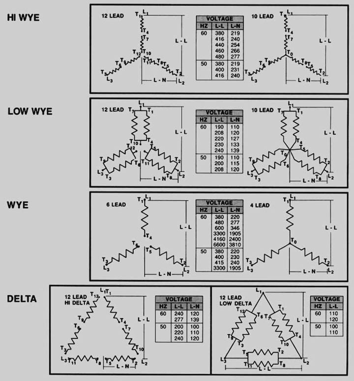

Here are some diagrams of the different configurations, the T1 to T12 numbers are the leads coming off of the generator head, you can see the different options depending on how you wire them:
Single phase wiring:
attachment.php
3 phase wiring:
attachment.php
Here is another thread by sewerzuk detailing how he re-wired his 3 phase MEP-004 genset to single phase: MEP-004a re-wire for single phase operation, with video - SmokStak
Aaron Z

Very, very interesting. 6600 Volts on Y ??:eek: Are those for different versions of alternators?
Figuring the effects of the phase differences into the diagrams is not something I am capable of. I'm sure Nicola Tesla could look at them and say, "sure, that will work" lol
