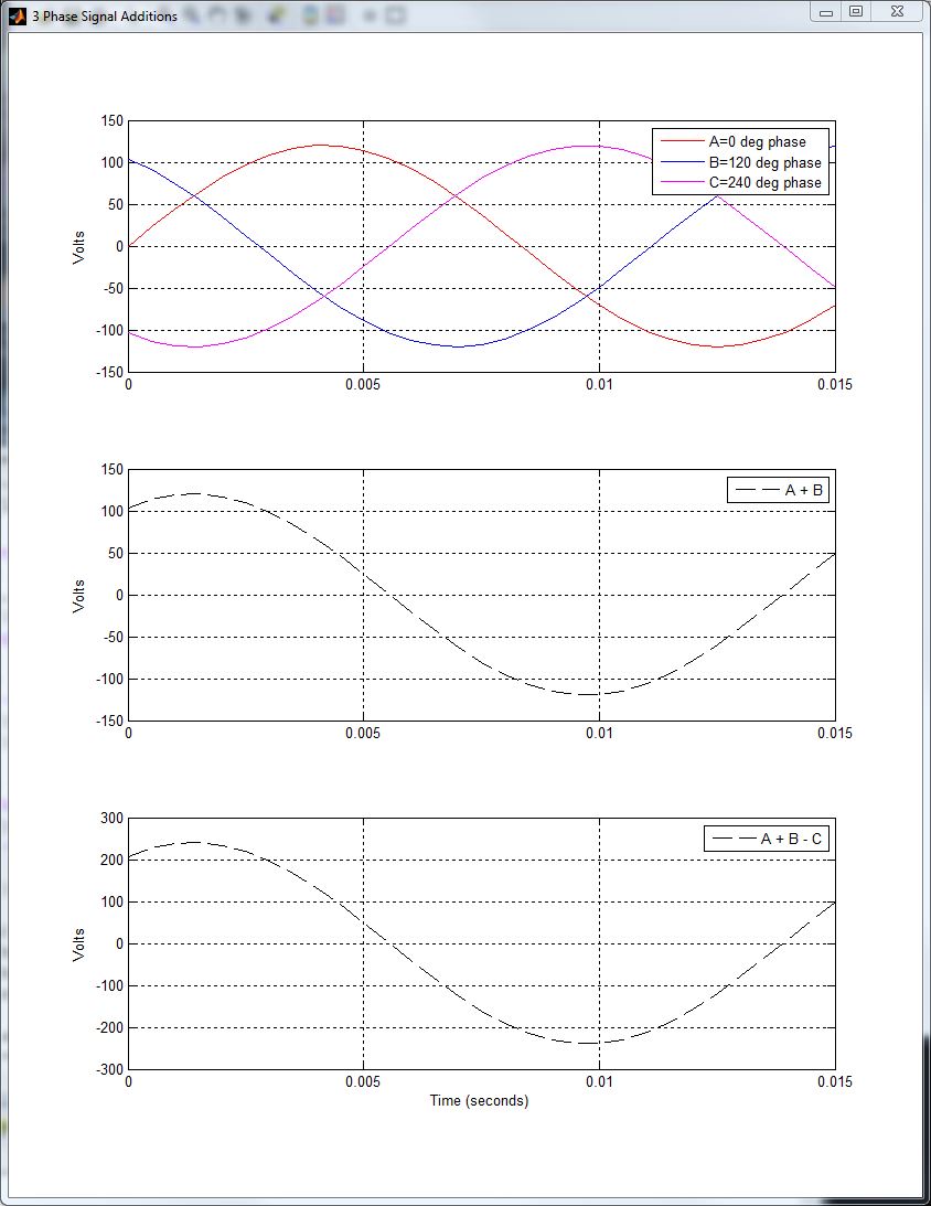

OK, here's the WHY. I made up a computer 'simulation' of signal generators for 120V, 60 Hz. operation. There are 3 signals: 0 phase lead, 120 degrees of phase lead, and 240 degrees of phase lead. Lead or lag doesn't really matter in the Big picture.
I show on the plot the 3 separate signals (A, B, C) plus combinations of them produced by simply adding or subtracting them. Note that adding 2 together keeps the frequency, produces a single phase and still rolls at 120 Hz.
What is interesting to me is when you add and subtract the 3 signals, it looks like you can still get 60 Hz but can achieve 240v peak to peak. Sure, there's no phantom extra power or current being produced, but you get the picture for the device you are trying to run.phase_additions.JPG
Here's the [MatLab program. You can surely run this concept in Excel, etc.

   / GENERATOR QUESTIONS FOR YOU EXPERT ELECTRICIANS #72
I have remembeed that and the next time someone asks, I will scribble that on a cocktail napkin.
I am impressed when people can do stuff, I can't. A little frustrated that I don't think I have what it takes to ever be able to do that. Maybe, understand it in basic terms, but not to do the math.

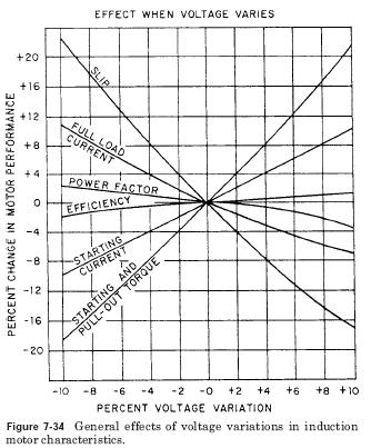

Regarding 208V & 240V supply mismatched with 208V & 240V equipment:
In general, induction motors are somewhat self-regulating. Their impedance (resistance) and power requirements are not fixed. They will self-alter their power input as the mechanical load output calls for it. As mechanical load changes, they alter their power input by changing the amount of current input and their power factor. (They are also somewhat self-regulating when it comes to operating close to their rated rpm without running away (over-speeding) and increasing torque when rpms dip, but that's another related story)
Running a 240V motor on 208V is a 13% voltage drop, which is off the chart, but you can see the effect on motor amps, starting torque etc...:
For (non-motor) purely resistive loads (heaters, stoves, hairdryers, block heaters, etc...) the power (heat) output will be effected by something like "the difference of the square of the voltage" or the square of the voltage differences"...blah blah blah, I can never exactly remember so I have to figure it out by working backwards from the Wattage to figure out the device's resistance (in Ohms), and then forward with the new voltage to Watts (power).
Example: 2400W heater (at 240V) => 10Amps; Heater must be 24 Ohms
Those 24 Ohms at 208V : Power is (V^2/R) 1802.6 Watts (or 208V/24 Ohms = 8.66Amps, 208V x 8.66amps = 1802.6 Watts)
So, running a 240V rated heater at 208V gives (1802.6W/2400W) 75% power output.
ahha....
75% is: 208^2 / 240^2 = (43, 264/57,600) = 75% ...so the power reduction factor is one "square of the voltage" divided by the other "square of the voltage".
