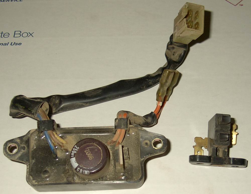

I started tearing it apart today and it looks like there are only brushes and what I believe is a regulator besides the fields and the armature. My guess is that it would have to be the regulator. What do you guys think? I also attached a picture of the parts.
Thanks,
Mark

Looks like the circuit board is potted - you can't test individual components.

The brushes are in terrible condition. The local auto electrical guy said he thinks the brushes could be the cause. Got new brushes in the holder now for $21.00. I will try it tomorrow. I hope so because the regulator costs from between $300.00-$380.00. Not willing to shell out that much cash without being certain.

yep.. try te cheap easy stuff first in a case like this where troubleshooting has been intentionally crippled by the manufacturer.
good luck

Actually potting the electronics protects them from vibration and moisture. Unfortunately, it also prevents any repair.
