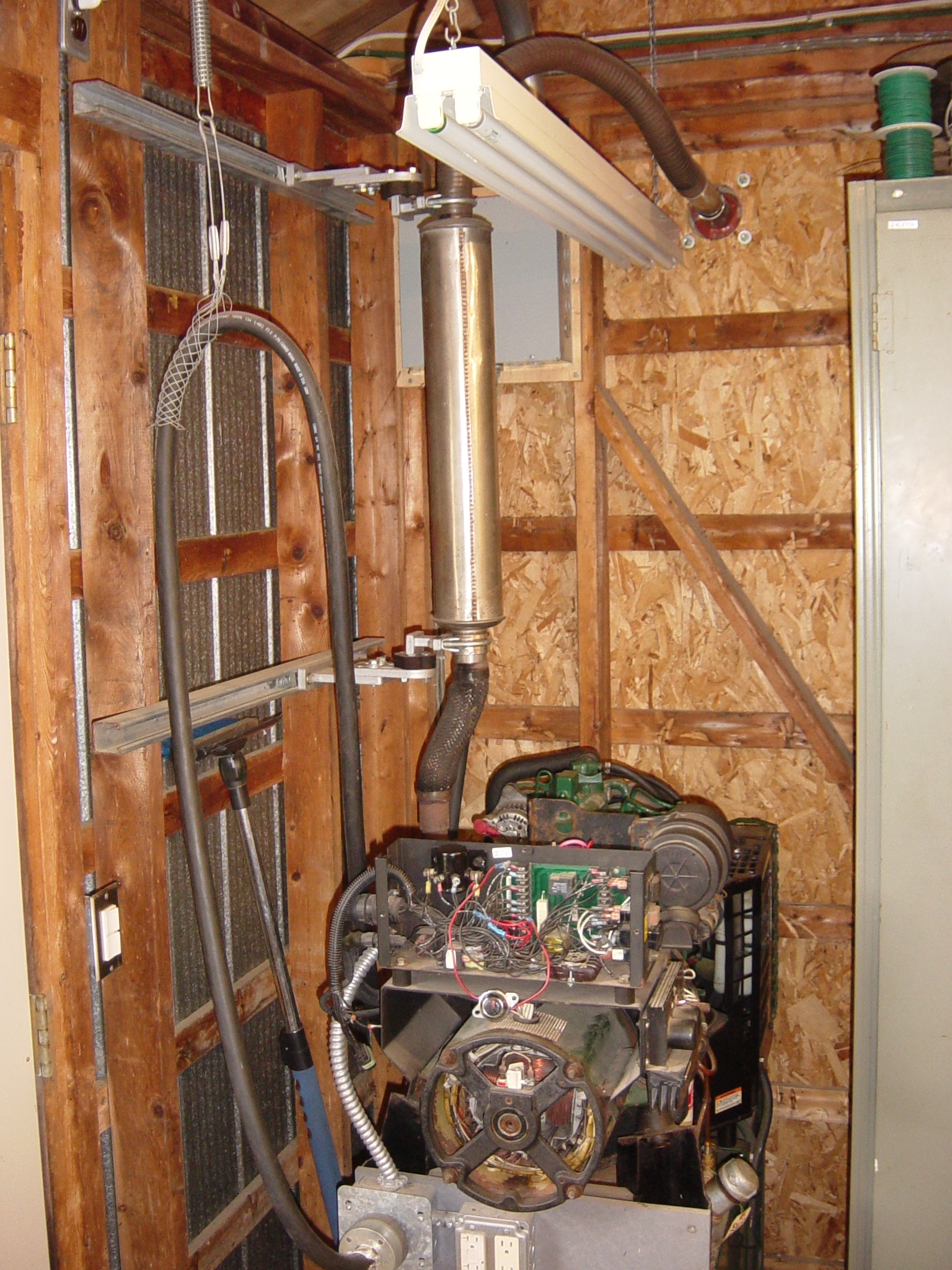

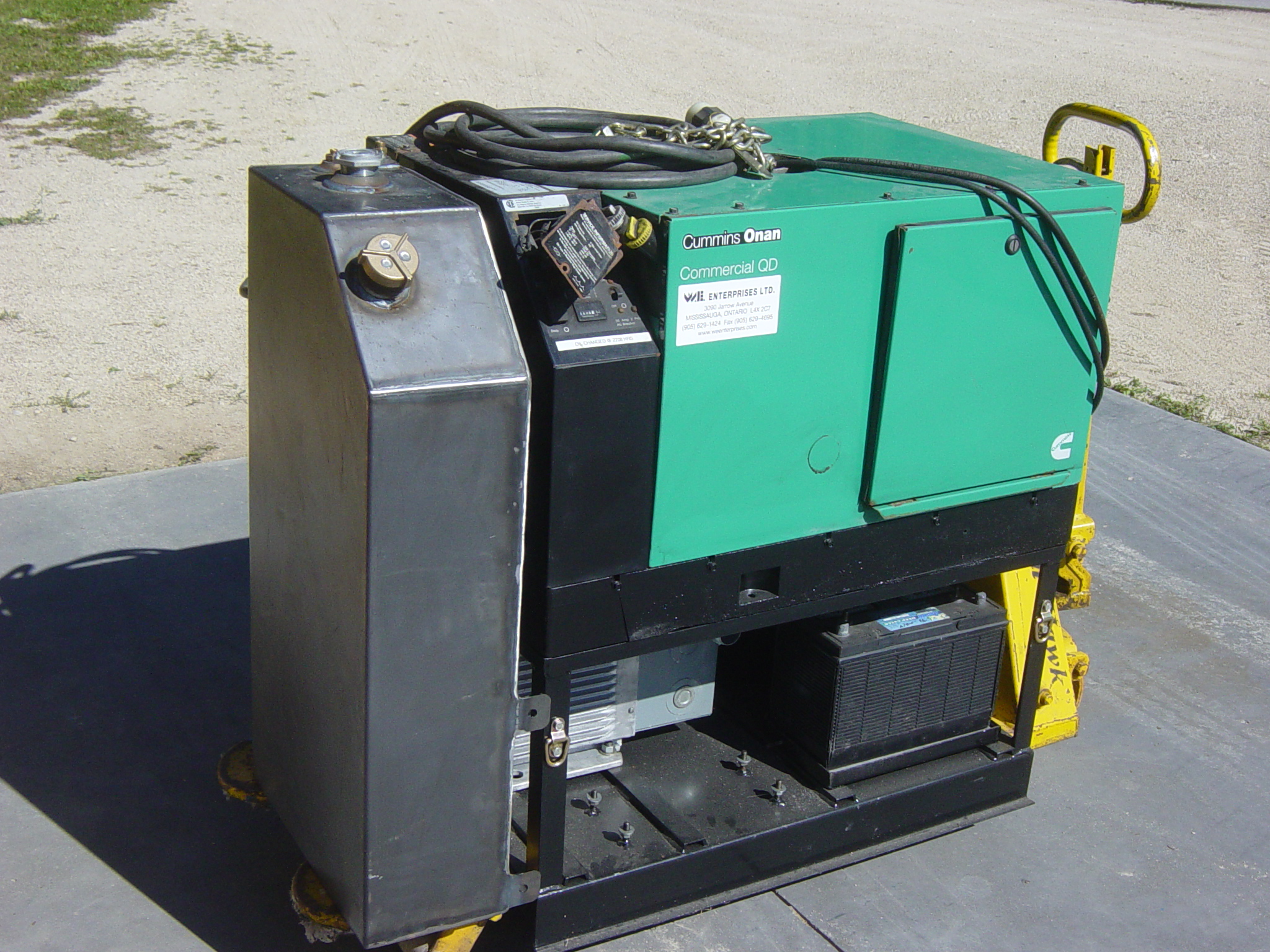

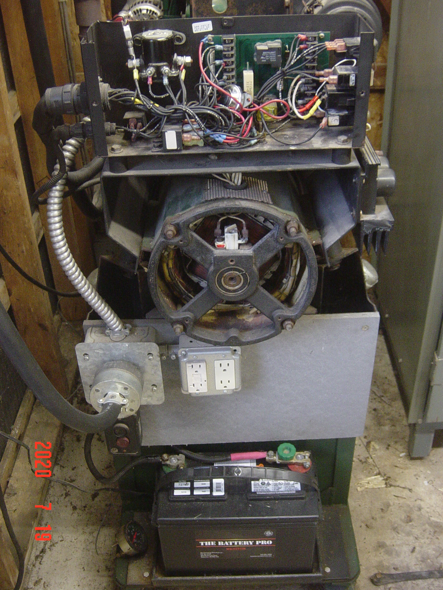

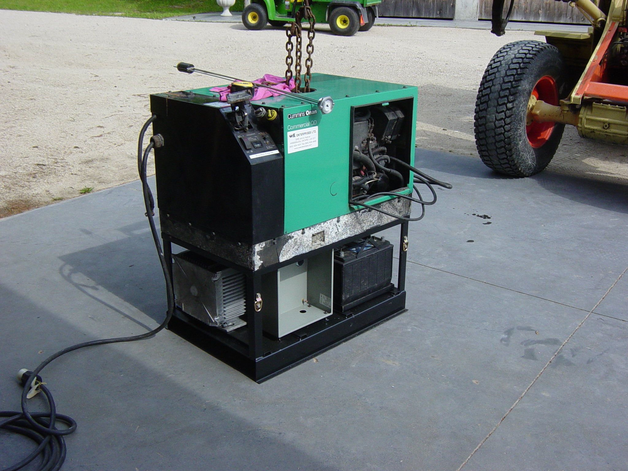

That's a great score. But not for everyone. I like it when the power goes out. Gives me a chance to use all my resources, see what works and what doesn't. When the power comes back on again, I have usually had enough of playing around, managing loads and so forth. Big difference from a Turn-Key whole house system, but you put a lot of faith in that.
Also, I have siad it a million times before. Not knowing when the power will come back on is the worst part, you can't plan for. You wouldn't want your whole house 10KW or so, system running all night long, to power a fridge and freezer, if you thought maybe the power was going to be out for weeks and fuel delivery might be an issue.
Personally, my first requirment would be a generator, I can see, touch and work on. Not a Tin can with some ,Diagnostic display or LEDS, Some phone Ap would be the last thing on my list.
View attachment 667411 View attachment 667412
7.5 KW, Onan/Kubota set that is currently my primary backup.
like i said...everyones wants are different. On my own unit i manually shut it down if power is out and i Am Hitting the sack. I dont need it running while sleeping. The fridge and freezer can easily go 8 hours with no real loss of cold. The transfer switch will auto swap to utility if its restored even with unit shut off. The reason i installed a 1,000 gal buried tank of fuel is the not knowing part.
