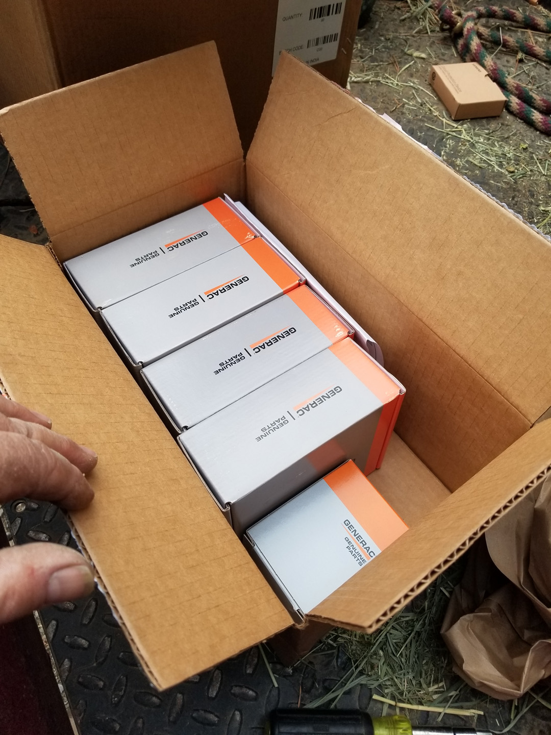

that package of filters and parts just arrived.....yah. what usually took 5 days took 2.5 weeks. miserable Covid 20201022_164347.jpg 20201022_164350.jpg
