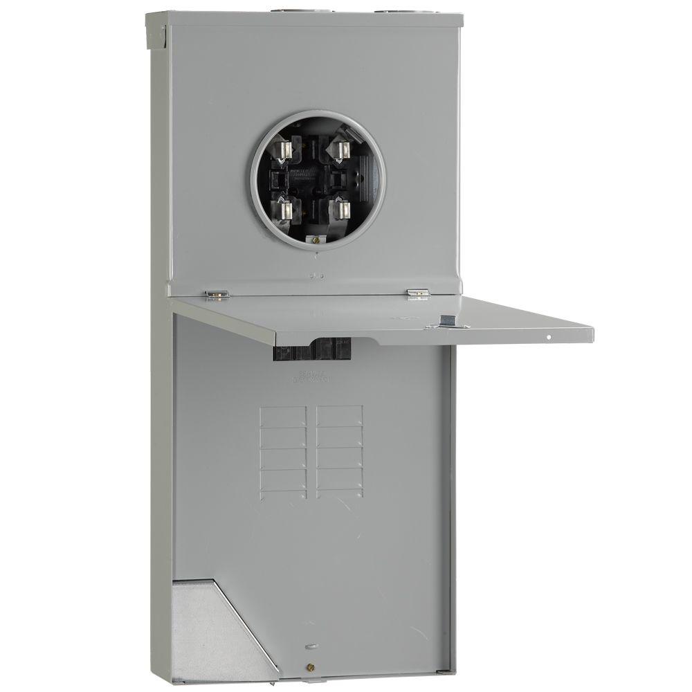

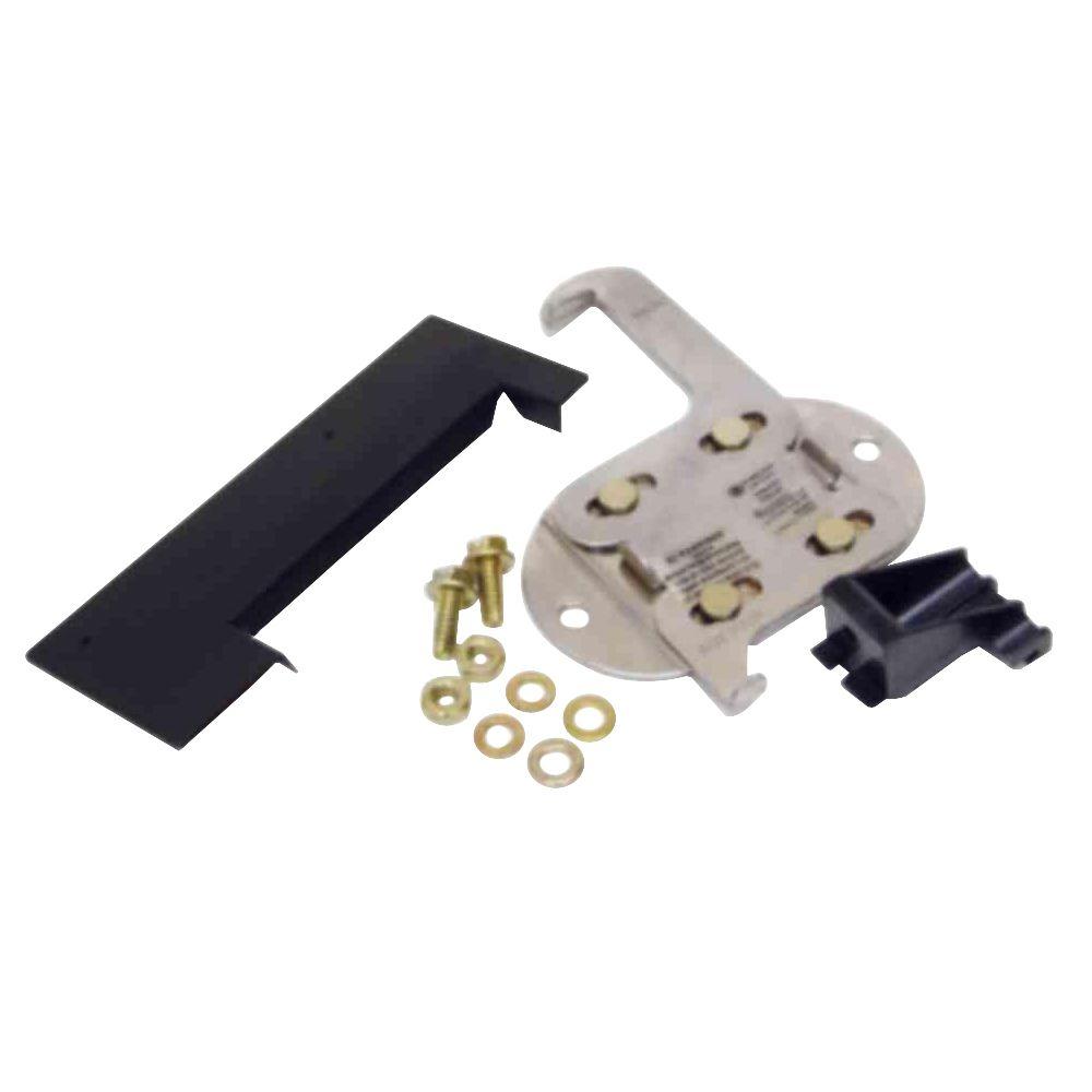

#76
Howdy,
A similar service/meter/panel combo would be something like the GE 200 Amp 8 Space 16 Circuit Outdoor Combination Main Breaker Ringless Meter Socket Load Center TSMR820CSFLFMG and getting the GE PowerMark Gold Generator Interlock Kit THQLLX4
