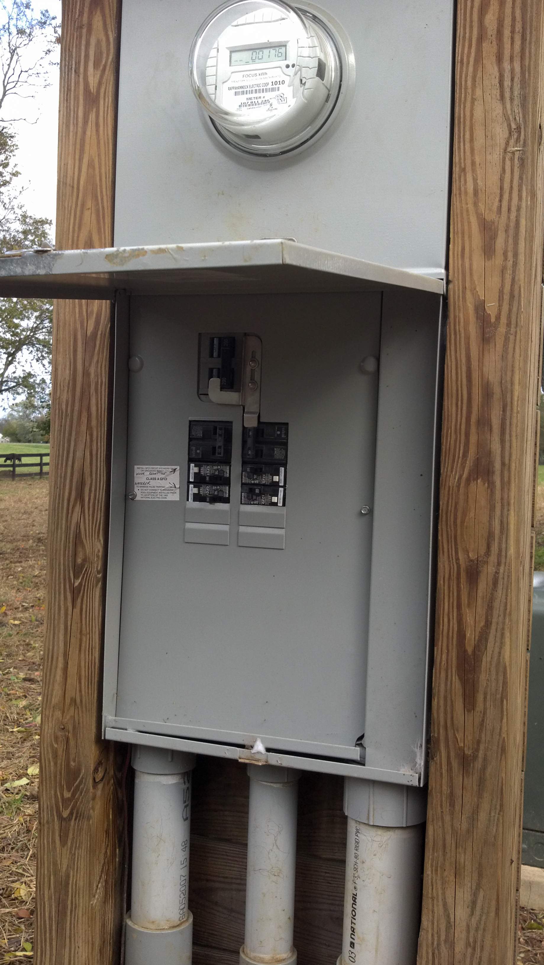

Maybe one of the easiest methods would be a interlock kit. There are many manufacturers out there. Some times its even easier to build it in from the start. Existing work- you can see if your current electrical panel has a interlock kit available. The interlock plate slides into position to let your dual pole generator feed power the panel instead of the main service breaker. The interlock makes sure only one of them can be ON.
example; 200amp outdoor meter/load center with interlock kit

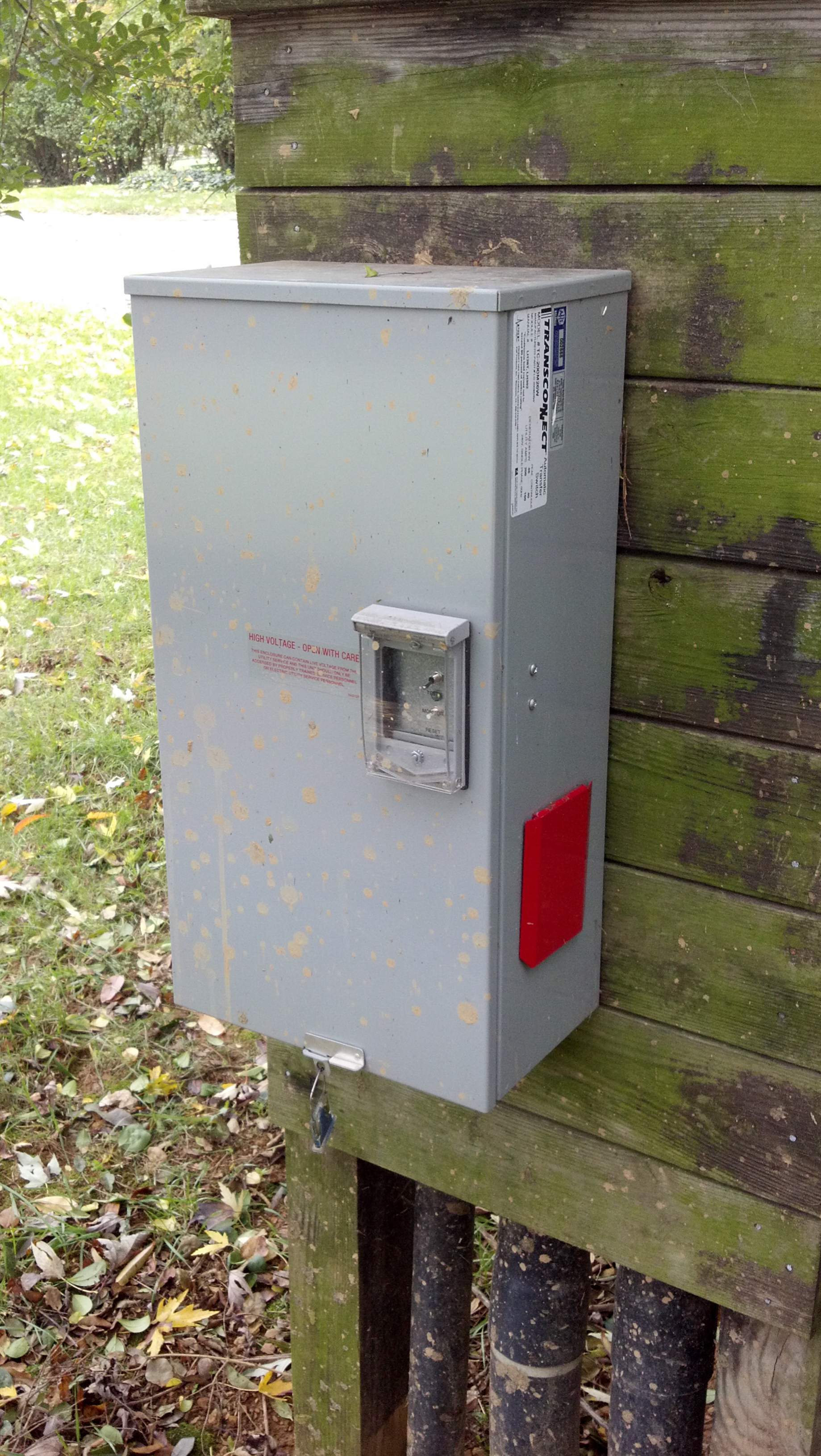

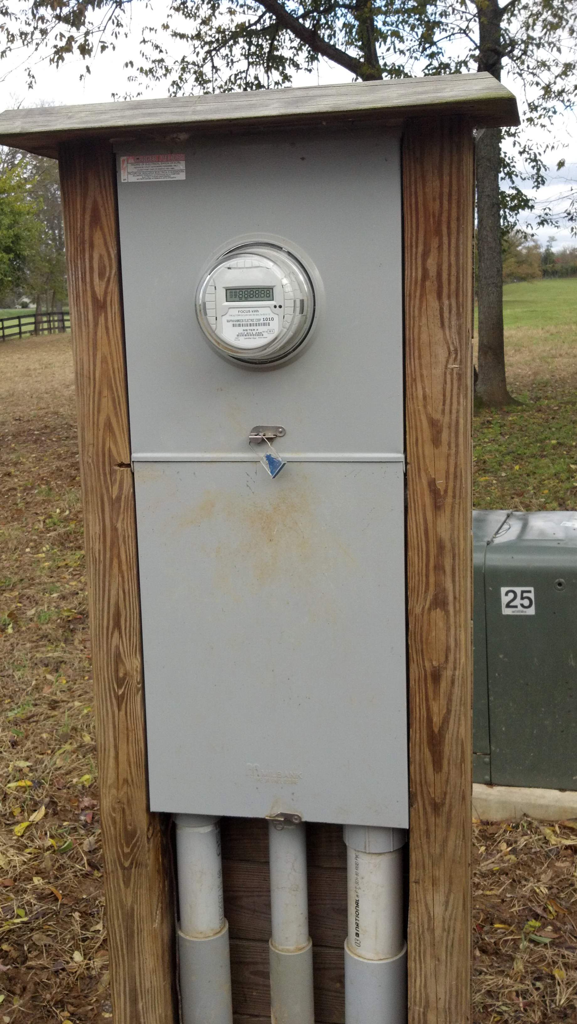

Below is my central farm distribution with a TC-200M26W shows a continuous generator rating of 40KW and a peak of 48KW
(Through my local utility)

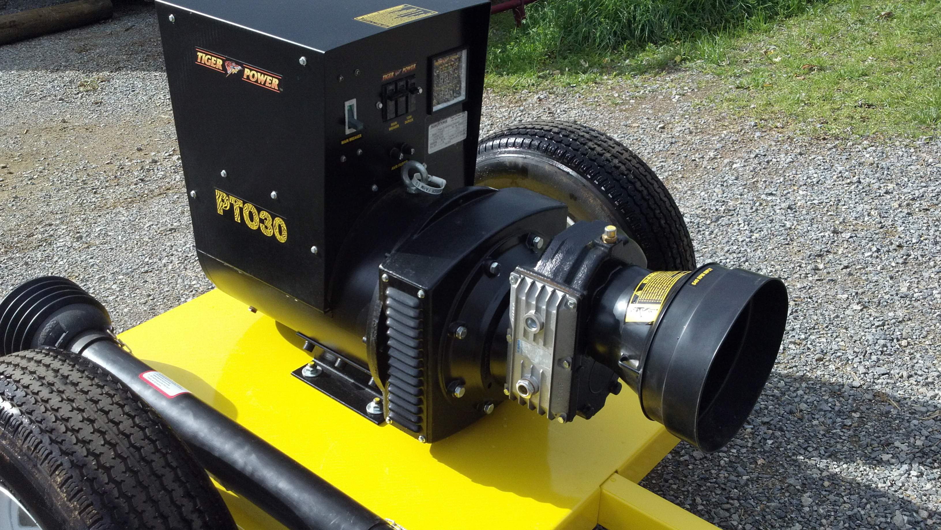

Tiger Power 30KW

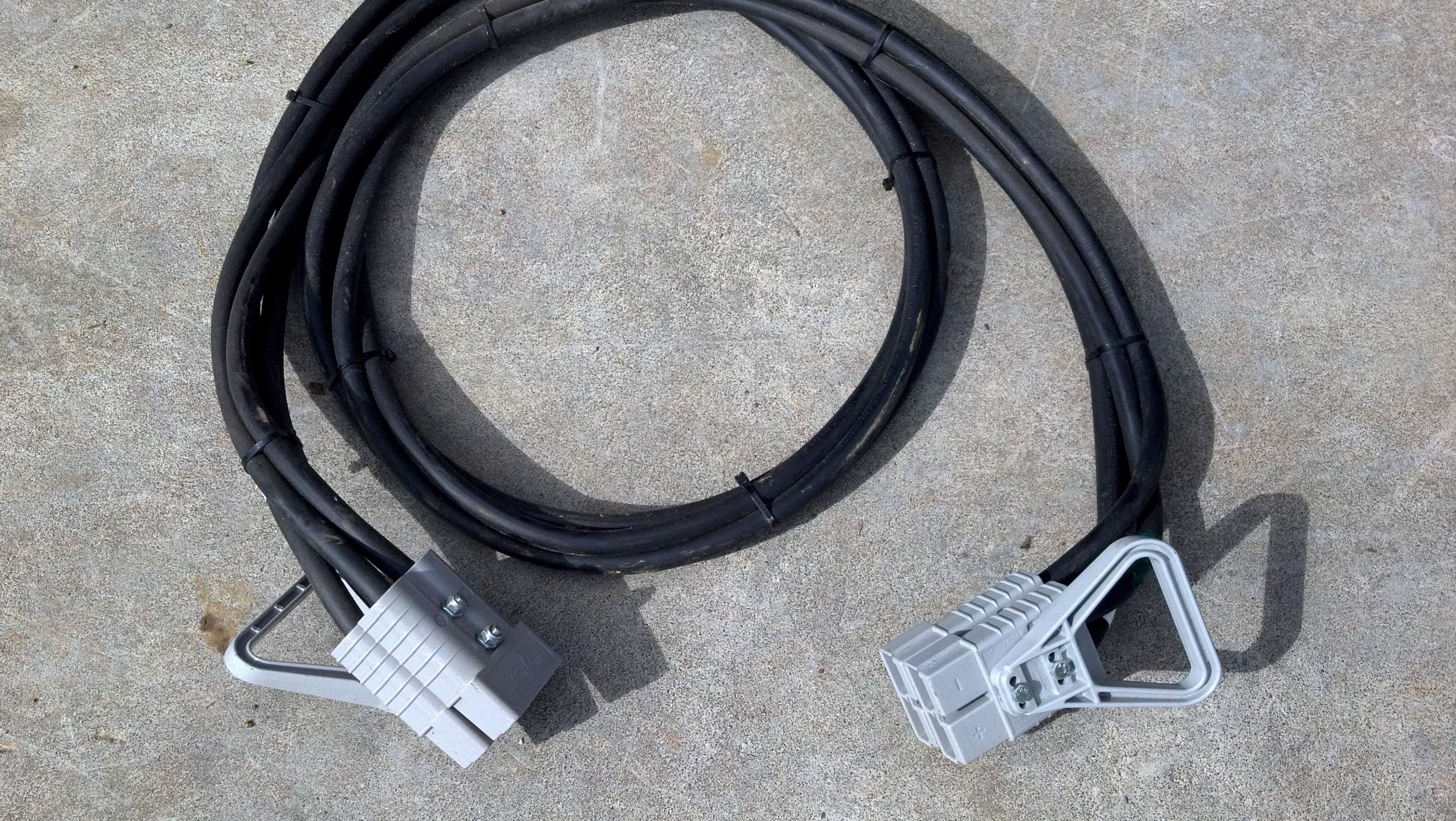

cord set (anderson 350amp connections)

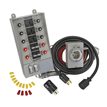

I just installed a Pro Tran 6 ciruit transfer switch. It is paired with a 5550 B&G genset. Wifey was tired of the extension cords all over the house and she was really tired of not having running water since we are on a well.
I wired this thing up in about 2 hours. FYI- I am a card carrying member of the Amish electricians union so if I can wire this thing up , anyone can.
6 circuits seemed like more than enough if you pick and chose wisely. I now have a well pump on the 220v circuit, 1 fridge, 1 chest freezer, lights upstairs living room, hot water tank(wifey needs hot hot showers) and lights and the TV in the family room for the kids. we didn't power the bedrooms at all or the bathrooms or garage.
The only complaint I have it that the 30 amp cord provided by the kit is a bit short. so, your gererator has to be sitting rather close to the house. Other than that, it is a wonderful step up from cords laying everywhere and we have running water.

Nice topic. The "ProTran" or "GenTran" method is often a good choice. As mentioned above, it installs quickly. It can be the least expensive method. It switches individual branch circuits, so that while you are powering some circuits with the generator, other circuits remain connected to your utility. This means that when the utility restores power, you know right away. Disadvantage of the GenTran style is you cannot power circuits from both a main panel and from a remote sub-panel. That's when you might choose one of the options that powers the whole house with the generator.
Another note about the GenTran -- you can buy it as a kit, with a cord, or a la carte, and buy the cord separately. The kit might save you money, but its cord might not be long enough, as noted above.

The Large collar behind the meter is large enough for a continuous generator rating of 40KW and a peak of 48KW. The connection is with 2/0 cable with anderson 350amp modular plugs. Most other connections of size would be with a permanent connection. On a PTO generator, the connection is known as a full power outlet.
And if you look at the pricing for 400amp transfer switch. $$$$$ its crazy prices.
What's nice about the unit I got... no extra wiring for me. The one main meter (central farm distribution) feeds large house, barn, sheds, shop, well, so with this system, all is powered from here. The utility came out and pulled the meter, put the collar on, mounted the 2nd box with the brains and connections, put meter back, sealed it, billed me for unit spread out over 4 payments.

"The interlock"
The interlock makes it so only 1 breaker can be on. The main panel breaker, or the generator breaker. So, you turn off the main 200amp breaker, slide the metal interlock, and now you can turn on the generator breaker.
2011-10-20_13-12-11_726.jpg click on the picture to see larger, then click again to zoom in.
Your panel needs to have a interlock kit for it. It usually needs the 2 top right spaces for the generator breakers. If your panel is full, a lot of times you can get half breakers to help make some room.
