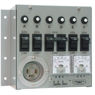

   / Generator #58
It seems to me that the best place for a transfer switch is between the meter and the main breaker panel. That way you can run any appliances you want and shut off power to any circuit you want through the standard breaker. These sub planel transfer switches include a lot of hokey wiring above and beyond the normal spaghetti maze. The problem is that the meter backs right up to the breaker panel in many installations including my home leaving nowhere to splipce in a TF.
Am I missing an important point?
I would like to know how to legally and safely power up my house with my big honkin loud 220 generator and since the only big appliance I have is my clothes dryer there is no reason that the generator can't fully replace grid power.
The next question is that my generator is marked as having a "floating" neutral. Are you all tying the generator to ground and using all 4 wires of the typical generator 4 prong twistlok? Or just using the two hots, the white neutral and no generator ground?
   / Generator #59
Well, I guess I just don't know what to look for or where... everybody says a transfer switch is cheap and easy to find... all I have located are $500 or way more... more than I spent for the generator.:eek:
Could somebody point me to the right source for a transfer switch...My needs are:
I live in the country at the end of the electric line, literally. I need to plug in my generator and power just enough to get by.. as all have said, water, microwave, referigerator. I have propane stove, hot water.
I'm just looking for a simple manual switch. As I understand it, The power will normally flow thru the switch to the house, well, etc. This means about 200 amps capacity, I think, since the Air conditioner is in the normal circuit. However, when I manually pull the switch (to be done when the power is out), then the electric company is cut completely away from the house power and the existing house wiring is powered by the generator which is connected to the other side of transfer switch.
Thus, I think I need a 3 pole double pole manual switch rated for 200 amps and outdoor installation.
Generator is a pull start gasoline coleman 5500 watts, 6250 surge if I recall correctly. It has 20 Amp circuit breakers on the 110 and 220 circuit. There is a 4 wire twist-lock plug on the side of the generator and I understand that a plug connection (about 8 gauge) between the generator and the transfer switch is needed and it is best not to have male connectors on both ends of this connection. I know that this wattage is very small for running a whole house... but I intend to have ONLY the minimum on at one time and can cut out the water well circuit breakers if need be.
At Square D I found this page of switches. General Duty Safety Switches - Light Duty Class 3130 .. and figure I need their non fused 3-way 200 amp manual DU324 switch for $589.
I am sure I'm missing something simple... will accept ideas pointing to my error and a proper and cheaper solution.
   / Generator #60
Mine is similar to the attached picture.
It was around $200.00 at an electrical supply house.
