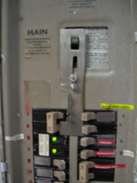

There is a transfer bracket that allows you to back feed through a normal breaker and it allows only this breaker or the main breaker to be on, not both at any given time. I make one for my panel out of a piece of steel. You can buy them for around $150. Do a web search. I will also look.

   / Generator #66
Attached is the tranfer bracket that only allows the generator breaker or the main breaker on at any one time. Both may be off of course. I made it out of stainless, but many materials would work. I did a card board version to get the dimensions first, and copied it to metal.
The breaker on the top left is the generator breaker.
   / Generator #67
BobRip's solution is one I thought about posting but didn't because 1) I hadn't actually done it myself and 2) there's that dang "code" thing that I could not say whether it'd pass or not.
But BobRip's box is what we used on submarines to make sure that two breakers couldn't be 'on' at the same time.
Living off grid I don't have to consider "backfeeding" and therefore don't have any switches to prevent it. But BobRip showed an excellent photo of a reasonably priced answer.
Phil
   / Generator #68
Phil
There are code approved devices to do this, but I did not know about them when I came up with it. I did see something like it on a generator subpanel. That's where I got the idea. I highly recommend that you buy it if you can.

   / Generator #70
At some of the loran stations I have been at, we had alternate power sources for the transmitters. These were controlled with key lock assemblies that were bolted to the panel face. In order to get a key out of a lock assembly, you had to move the breaker to the off position. You could then turn the key which extended a bolt into the path of the breaker(like a deadbolt lock) locking it in the de-energized position. Once the bolt was extended, the key could be removed and placed into the lock on the other breaker allowing it's bolt to be retracted and that breaker energized. Like the attached pic from the Kirkkey website. The last ship I was on had transfer lockout bars like Bobrip shows to control which buss(primary or emergency) a particular sub panel was fed from. They usually went across the panel between two source breakers. Both could be off(switched outward), but the cross bar that slid allowed only one to be on(switched inward) at a time.
