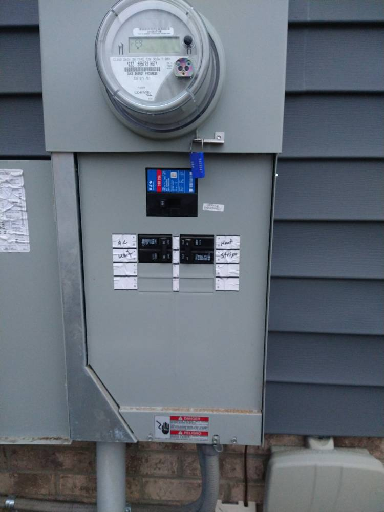

None of the panels are old, the house is only about a year old, by the way. However, it is a modular. So the main panel was in place when the home was manufactured, then (I assume), the small panel was installed after the house was set and the power line was run.

Yes, they make interlock for that
there is nothing old looking in those pics. Millions of homes have 200amp subpanels indoors with a meter main outside. There sold and installed today.
   / Generators - Backfeeding - 120V #133
for some reason I thought it was a code thing, where we are its generally a subpanel with just lugs, and no main.
   / Generators - Backfeeding - 120V #134
A subpanel within the same residence is not required to have a main breaker, however a main breaker panel is generally cheaper, at wholesale prices, than a main lug panel mainly due to the fact there are more produced and stocked. When i used to order parts for large house jobs with multiple level subpanels, the prices for a 100amp main lug or a 100amp main breaker were nearly identical.
if the subpanel is in a separate location on property, like a barn or shop, than a main breaker is required.

based on this photo, he has it made. throw the interlock on the outside, and put the generator plug on the bottom and a breaker in the outside panel, and he doesn't even need a hole in the wall. wish I was setup like this.
   / Generators - Backfeeding - 120V #137
I think Chilliwack was talking about the original poster of the thread, but you're right. Now that I understand that's my main panel, this is fantastic news. Won't even have to buy much wire.
Over where that panel is will be a good location for my generator (that I don't own yet). It won't take much cord to get it pretty far away from where we'll spend most of our time. Help reduce the noise pollution inside when it's running.
