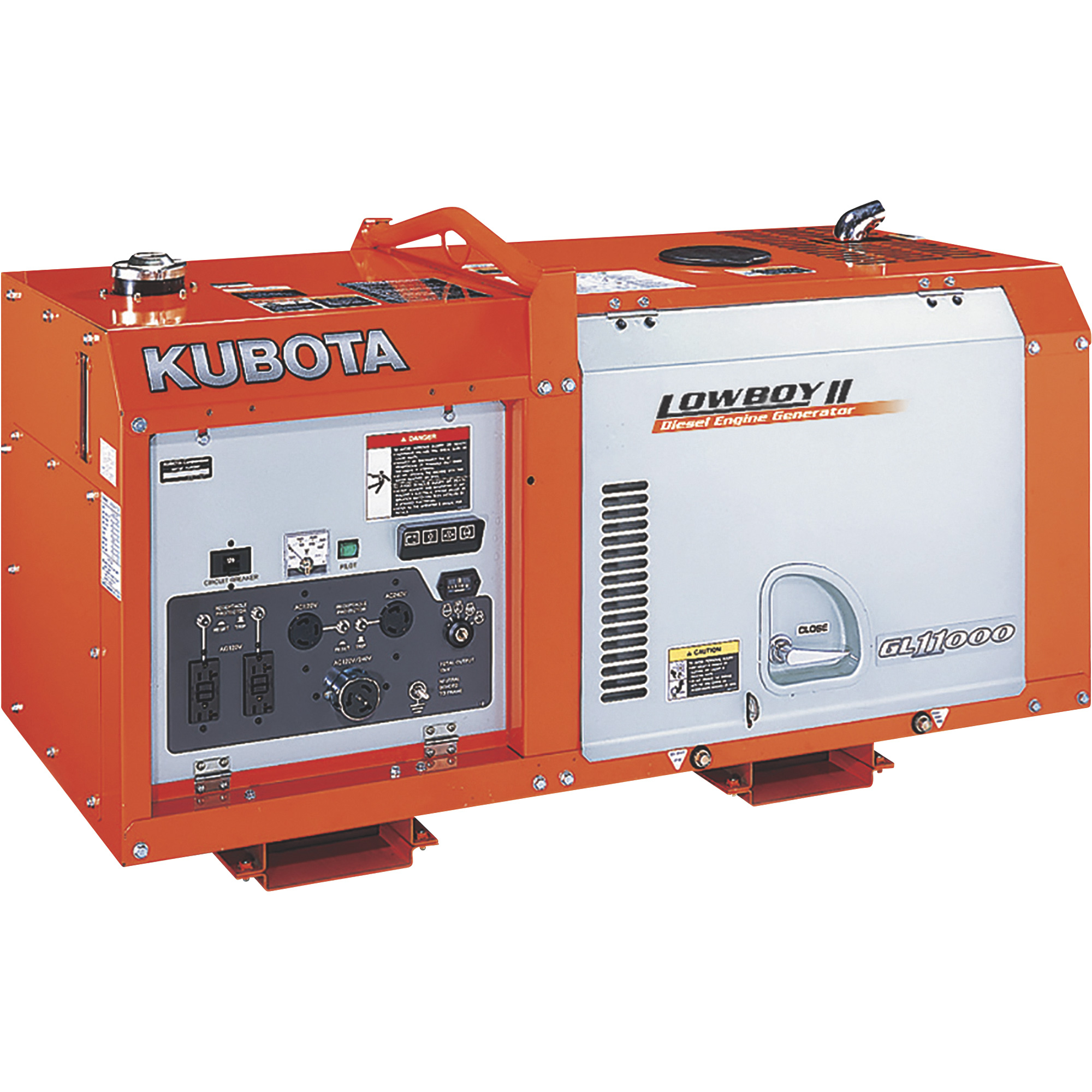

This would be a good solution for the barns but they are too far from the house. I'm trying to keep the area around the house looking neat with no implements lying around outside.
I'd prefer a portable diesel generator that I could keep in the garage next to the house. A unit on casters, like this Kubota, could be moved around inside or even moved to another building with pallet forks:
I guess I could keep the trailer mounted unit you suggest in the garage also but it would take up an entire bay and would be difficult to move around by hand.

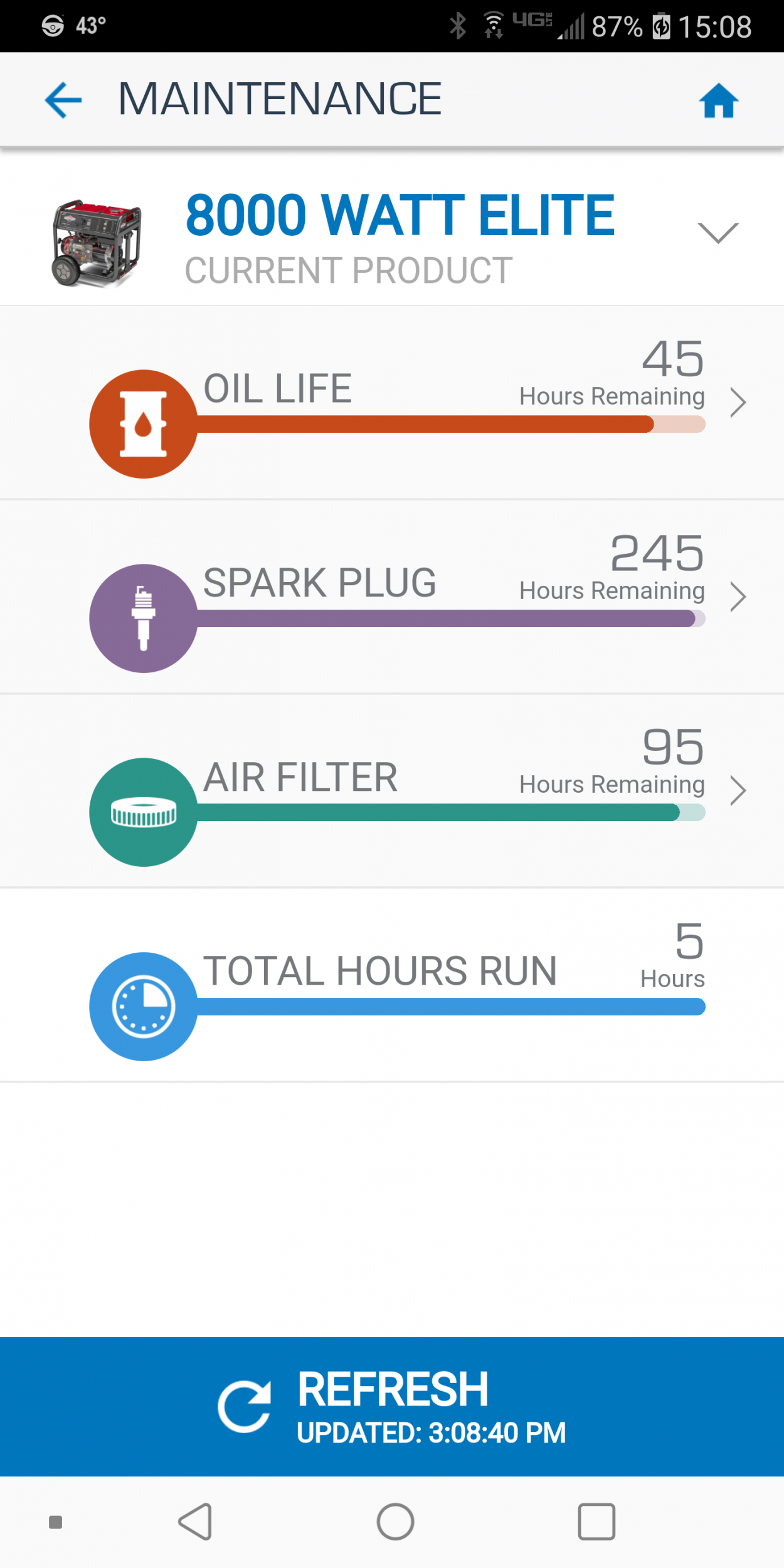

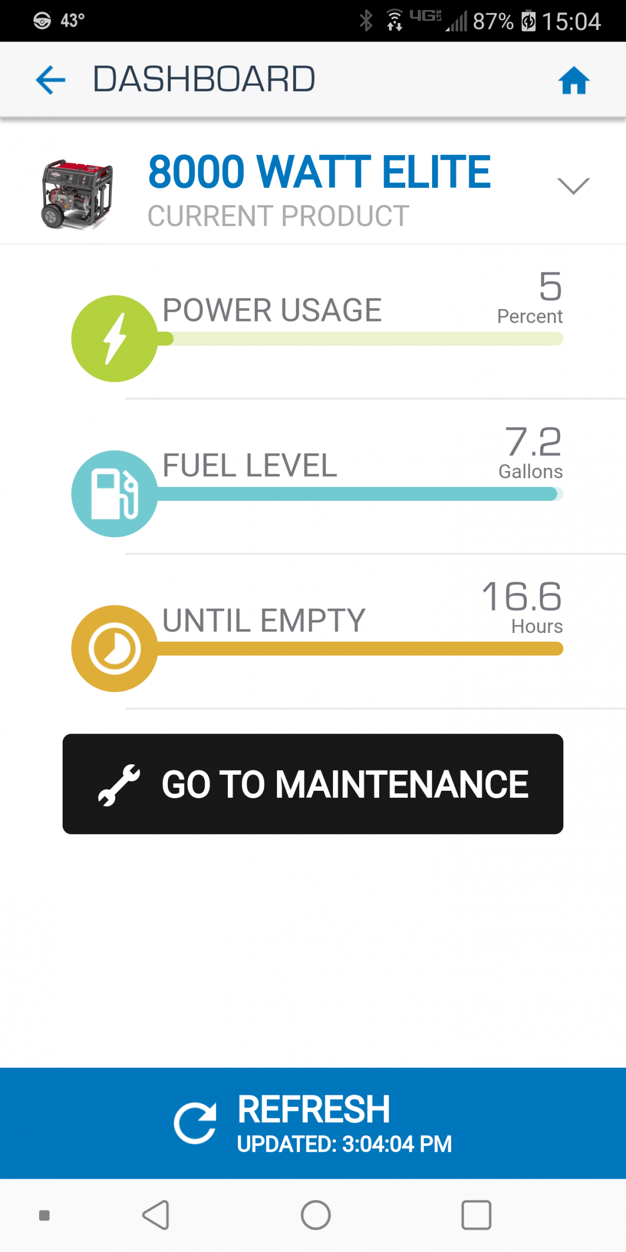

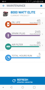

WEIW; we live at 1,200, the 10GPM water-well is 400 feet away and 220 feet down.
Our new 8K does just fine; the comments regarding balancing usage are spot-on.
We haven't used our electric heater since 2003...all wood heat with $60.00/mo electric bills...
Our older 5K that we bought for Y2K was a beast, but it wouldn't run the well.
We use clear-gas; we NEVER put ethanol into anything that is carbureted, but having full tanks in the vehicles is always a backup.
Electric start is wonderful; we run 4 hours on, 4 hours off.
Liking the bluetooth!
