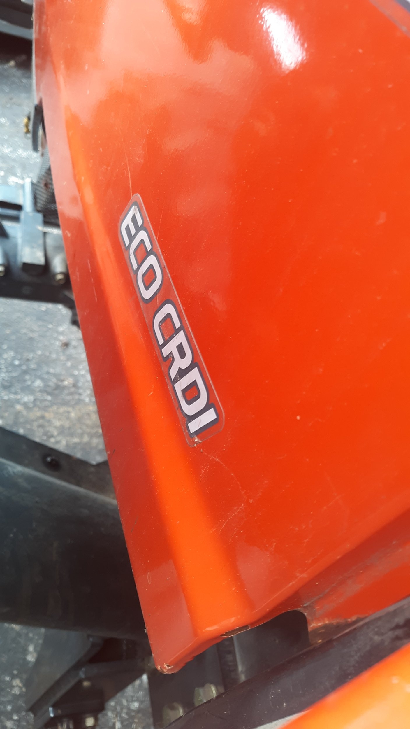

I was replying to the guy asking about Ecodiesel deletes.
Stan, I thought he was talking tractors since this is a tractor site. My tractor says Ecodiesel on the side of it.
   / Generic DPF filter delete. #63
Huh, interesting. The only Ecodiesel I am aware of is the trademark owned by Stelantis.
This is on the hood of my tractor.
