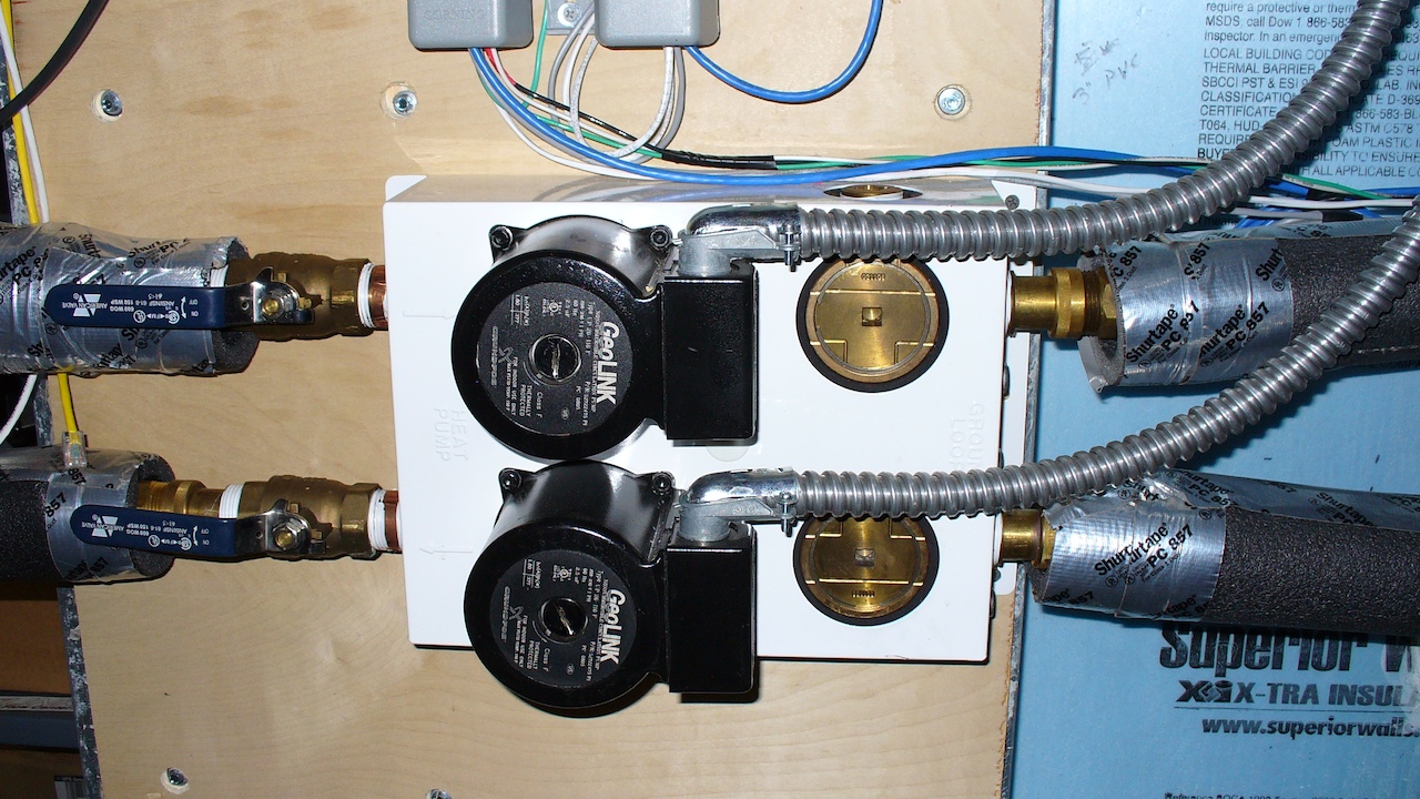

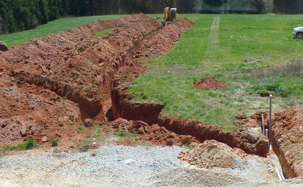

buckeyefarmer: Here's a shot of the flow center that the 3 and 5 ton Water Furnace E-Series heat pump use. At each heat pump there are valves used to set the flow to each unit. The other ground loop runs another 3 ton unit, and it only has 1 pump motor instead of 2. Pumps are labeled as 377 watts each.
That software sounds pretty good. You know more about this than I do, and those were great examples. I hope the cost of these systems comes down in time, I think it was expensive because not many people use it.

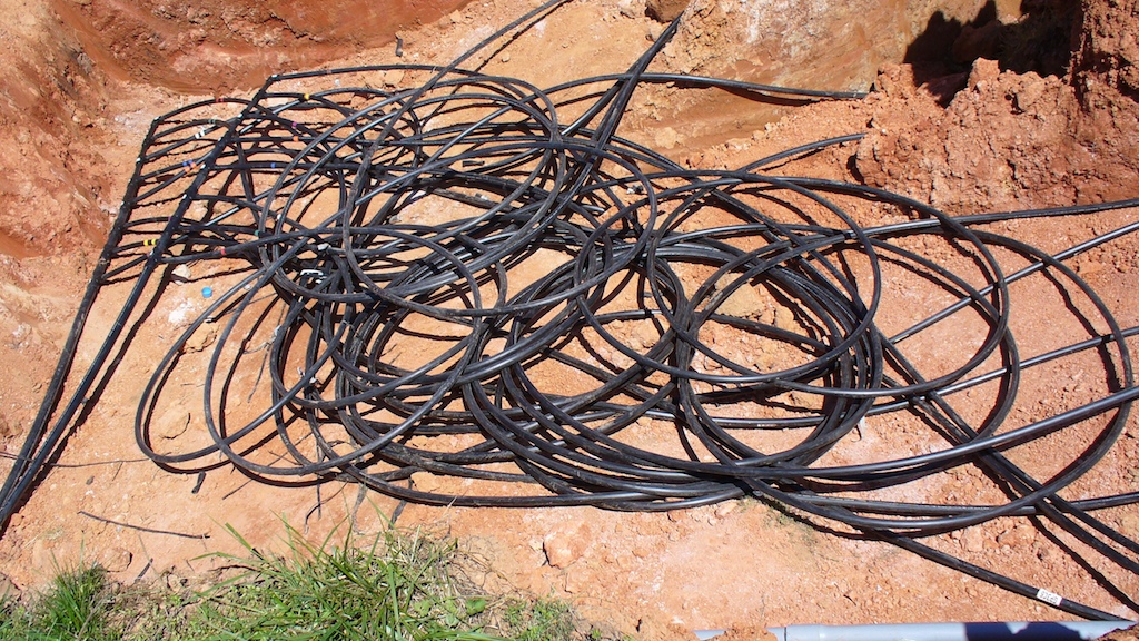

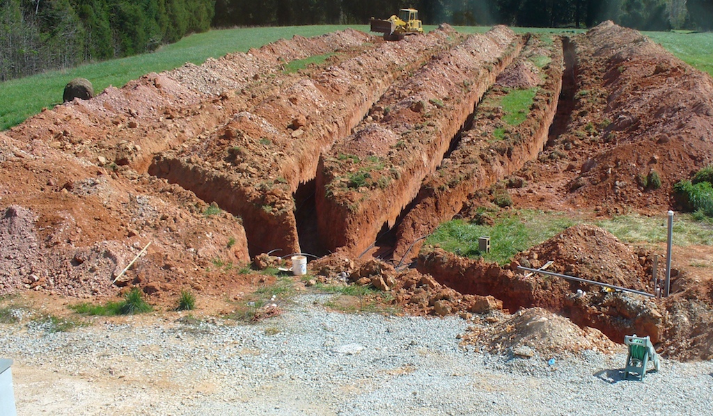

One problem my HVAC guy had: when he measured the ground loops with a distance measuring wheel, he should have added about 5% to account for the extra distance you see due to "wheel bounce" on the grass. When he got done rolling out the 600' pipe, there was about 25' left that just got coiled on the manifold pit. Not enough to warrant stopping the work and bringing the excavator back. Of course, that might just be me wanting to squeeze every last percent out of a system.
And here are pictures of the horizontal trench going in, the crowded manifold pit with the extra pipe, filling in and the site supervisor. I hear everyone likes pictures....;)

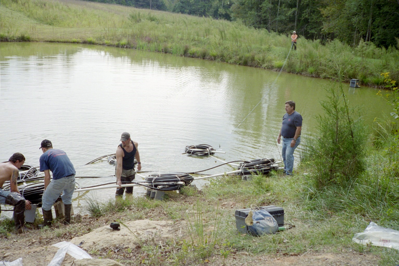

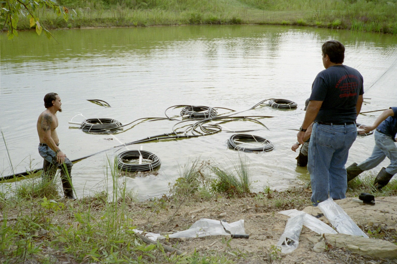

Found shots of the pond system (closed loop) going in, so here are more pix :)
The loops are left intact with some spacers, put on a PVC frame. The manifold is put on the frame. Since there is no water in there, just air, it floats and gets pulled out into the pond. Then, once in position, the loop is filled and it sinks. There were some cinder block tied on to help hold it it place once it sank.
The pond loop is cheaper to install because there is no digging. There is a little savings on labor because the pipe doesn't have to be rolled out, but it's very little, just a few hours. There is still all the "welding" (heat plastic so it fuses to make connections) for the manifold, and the additional time hit of the frame, positioning, and the like. For a half day, it does take more people (4) than a ground loop (2).
Anyway, this should give folks some idea of what these two types of systems look like when they are going in. Oh yeah, check for yellow jacket nest before the crew shows up. Failure to do so can cause a small delay of game.

eepete, Do you have a shot of the finished yard? It sure looks like a large excavation process.
   / Geo-Thermal heat pumps #37
eepete, thanks for the great pictures, especially the last one showing the supervisor. I am IGSHPA certified, so I have a good bit of info at my disposal.
You show a great example of the reverse return that's required to ensure equal flow in all the loops, note the color coding on the pipes where the header is fused together. Once the weather gets a little better outside I will be tearing up my yard. I originally designed mine for a 2 pipe trench, but due to the length of the digs, I have changed to the slinky. It will require a wider 3' trench, but each one about 100' long. I also decided to header inside, bring each loop thru the wall into the basement, in order to purge with the loop pump, instead of renting or buying a flush cart. I will be able to turn each loop off individually if I want.

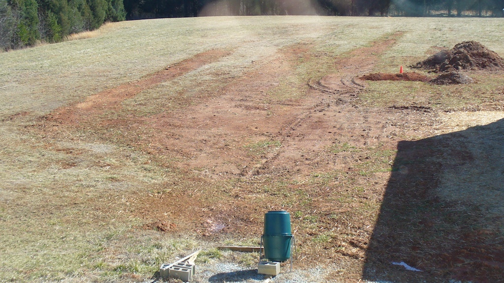

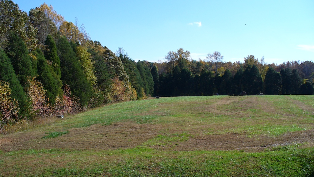

psj12: Here's a wide shot of the yard this fall, before I started the tractor garage project. You can see the lines from the trenches because the grass isn't well established. Then, there's a shot taken today. You can see the shadow of the new garage. You can see where I took dirt from the cut and fill operation for the garage and put it in the last of the depressions from the trenches. Next step is to level it with a box blade, till it, then (if I get the next attachment) land plane it smooth.
It takes a year for everythingto settle, and you have to keep filling it. Good excuse to get a FEL ;).
buckeyfarmer: I learned about ponds vs. ground loops in this area the hard way, but it was all very interesting. Glad you like the pix, they should help others understand the process. Yeah, you're just a few miles away. 36 05.365 79 09.695
Pete

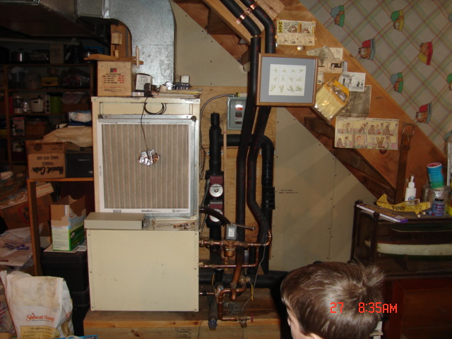

Wow, Pete, your installation sure looks a lot neater than mine! Guess 24 years of R&D have made a difference.... here's a shot of mine.
For those interested, it's a 3-1/2 ton system, closed loop (down the well hole), pumping 8-1/2 gpm via two Grundfos in series. Flowmeter is above the 2 pumps, wrapped in Armaflex to reduce sweating. The two lines going up the side of the stairs cross the ceiling and run to DHW. For you HVAC guys-- the HP control is on the line from the DHW heat exchanger; the lower line's from the desuperheater.
Just out of sight behind grandson's head are two shut-offs for the ground loop, which exits the house along the floor under the stairs.
I did my own ductwork (fiberglass ductboard), and made it oversize a bit to lower air velocity. In heating, I get 17-19 degrees TD at the air coil; when it's REALLY cold, I fire up the woodstove, which is about 6' away from the heat pump --directly behind me as I took the pic. Note the non-ducted return-- this seemed to work quite well, so I just left it that way. Makes it easier to see how dirty the filter's getting!:D
