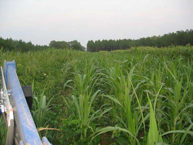

In the picture below, you can see how I rigged my cultivator to plow. The plants where the tractor is are iron clay peas and egyptian wheat. I put too much e. wheat and planted too many peas in that particular planting. I changed planter plates for later plantings. You can see the corn on the left side of that picture. I cleaned it up real good with glyphosphate when it was about 30 inches tall, but you can see the weeds coming on in the picture. The coffeeweeds are chest high, now.
Every time you disturb the soil where there is a sicklepod problem, you stimulate more seed. I plowed most of the stuff twice. By then, there was a pretty good canopy, and that helps keep the weeds from germinating.

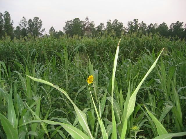

In the next picture, there are two different ages of plants. The egyptian wheat in the background is about where the tractor was sitting when I made the previous picture. In the foreground is a later planting, with ic peas, e. wheat, and just a few sunflowers. This picture was made this week. As you can see, the stand isn't quite as thick.

This shot gives some perspective of the size of the field, about six to eight acres. The corn isn't visible. It is on the right side, hidden by the tall e. wheat. From where the picture was made, it is about 1000 feet to the pines at the far end.
