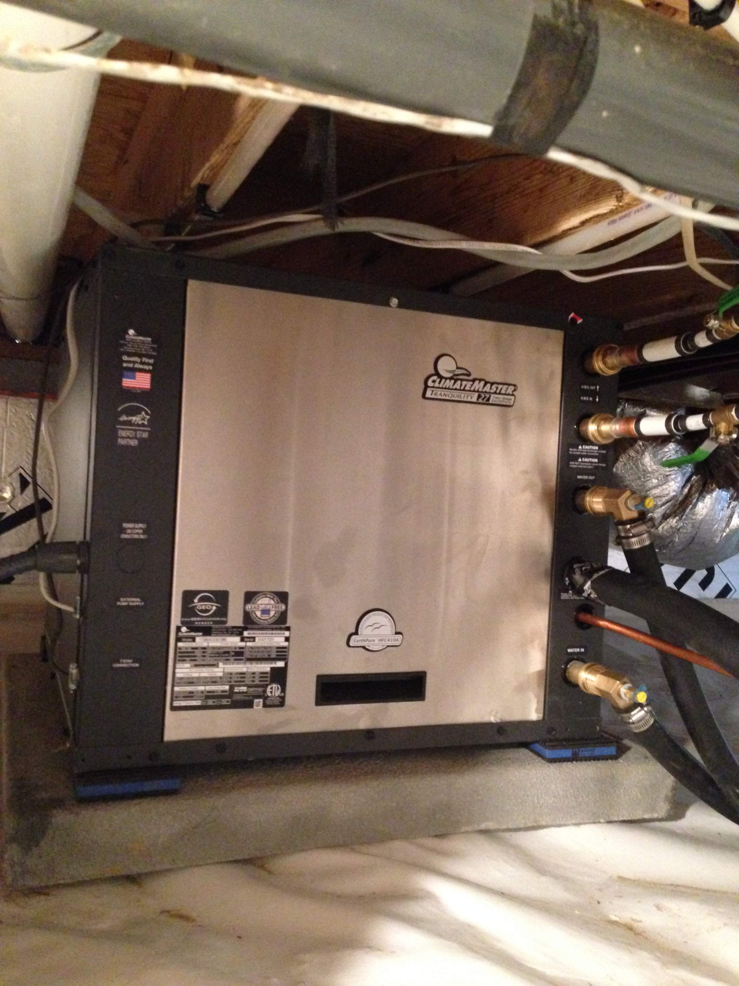

What is the unit sitting on? Is there contact from the unit or pipes on the floor joist to make the noise resonate more? You can get a jacket to dampen the compressor noise, but I would look at the other things listed above. Did your installer listen to the unit and find it acceptable to other installations?

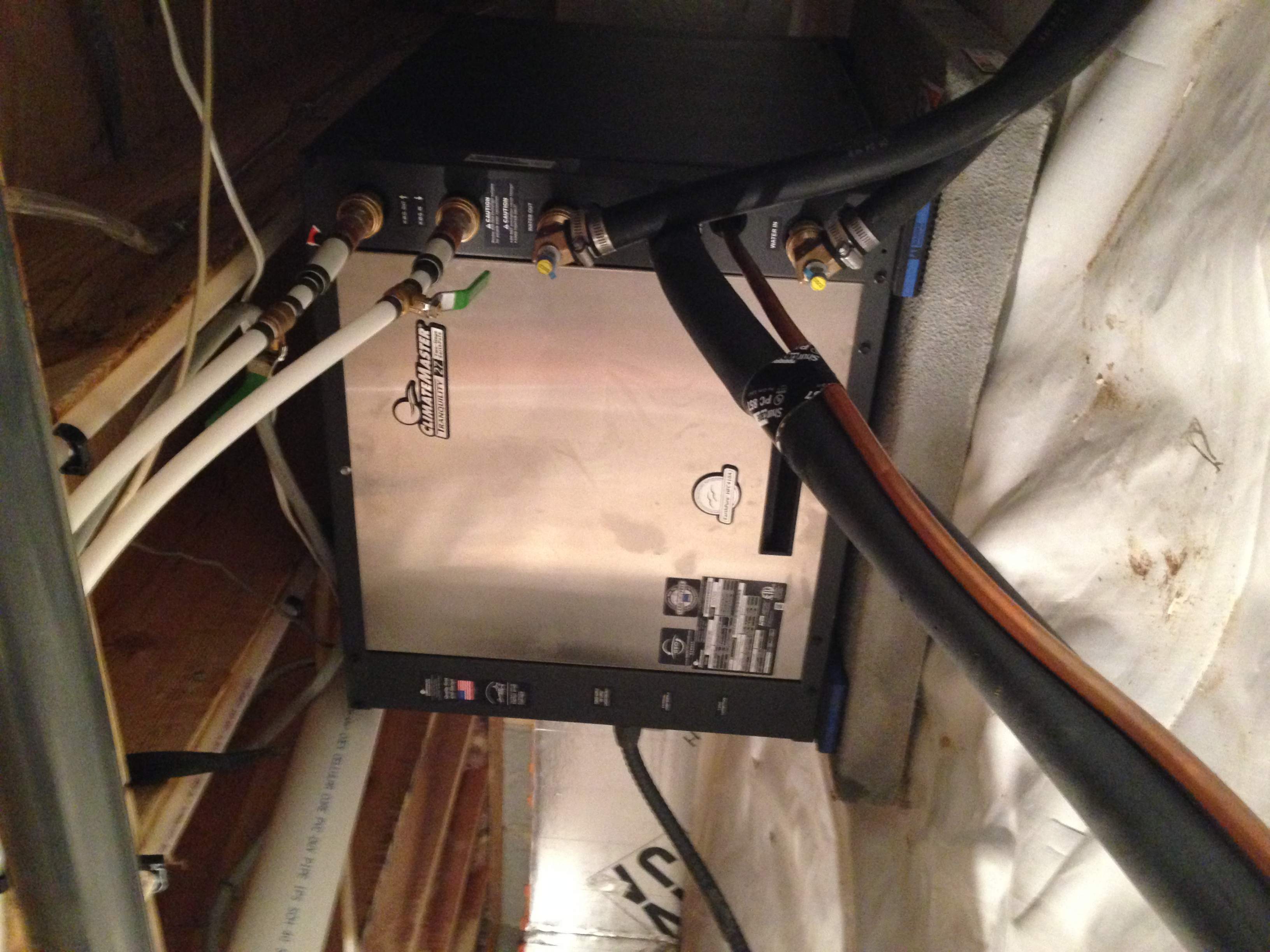

Here are a couple of pictures of the compressor. It's on rubber feet which are on a concrete block. It's close to the bottom of the joists but not touching. How much room doe a jacket take? As you can see there isn't a whole lot of room here.

The jacket goes on the compressor inside the cabinet. I would have your installer listen to it and trouble shoot. Then do the jacket as a last resort.

Would be willing to bet a little sound proofing insulation in the bays directly above the compressor would go along ways and be pretty cheap. Still may not be a bad idea to have installer listen to it. Just to make sure everything is correct.

No way I'd move it, certainly not without trying some sound insulation first. You can get Roxul (sp?) rock wool insulation at Lowes, and it is intended for sound insulation. Very good sound deadener. Stuff that into the cavities above the compressor unit. Double the batts if there is enough depth. If there's room, I'd also nail up a piece of OSB or drywall to the underside of the joists between the compressor and the insulation. Cover as wide of an area around the compressor with insulation and sheathing as you can. That way you will have multiple layers to damp the sound.
