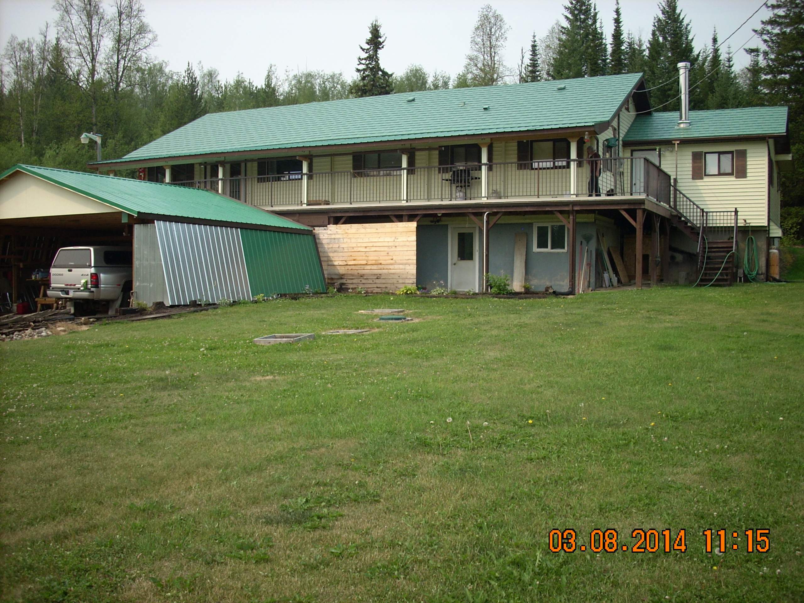

Hi Guys,
I just tried posting a thread but lost it for whatever reason - so if it is duplicated you will know the reason why.
I am interested in electricity consumption for a geothermal heating system in extreme conditions.
I have a 5 ton WaterFurnace unit with horizontal lines buried outside at 7ft or 8ft (previous owner information). I keep a 2,000sf house at 68F - also the 950sf basement and the 900 sf double garage (closed off to outside).
We are just starting to get winter conditions now around here where I live - last night at -24C/-10F and today at -18C/-2F. For the last twenty four hour period we have used 95kWh of electricity keeping the house warm. There is no gas usage except for the back up propane furnace, so that is all the energy used.
I had an energy meter installed that gives me the power usage every 30 secs. or so, as it is being used. I also log daily consumption as I do not trust our utility company - they have tried to screw me a few times with their "guesswork" consumption billing.
Would be interested to know what other owners are getting for similar conditions. Our winter temperatures can drop as low as -40C. Of course house insulation makes a big difference, but I believe our house is fairly well insulated, so a comparison would be usefull.
Thanks in advance, for any other owners info - would help to understand house heating efficiency.

Thanks for the comments so far.
From what you lot say, the cost of my heating seems high - maybe there is another problem I am not ware of. The house insulation isn't bad but could be improved of course - something I will check out this coming summer.
The energy meter I am using has proven to be an eye-opener in what power is used. The outside temperature now, as I write, is -28C/ -19F and the power being used for heating is 8411 watts or 8.4kW. At this rate there will be a lot of power used. The house sits on top of a hill and although somewhat sheltered by trees, still experiences a lot of weather.
The meter I am using is the MTP3100 and shows actual usage as it happens. It is an eye opener as to what power is being used.
As I write this I am starting to think that my place is not as well insulated as I had previously thought.
If anyone else has examples of what power their system uses I would appreciate knowing.
September and October of this year, 2706 kWh of electricity were used over 59 day period and cost me $292.94 or $150 month. November and December will likely be twice that amount with the total bill being around $600. I do know the natural gas is expensive in this area as is propane for heating. I was told by a neighbour that they paid around $200 to $250 a month for natural gas for a small house (less than 1,000sqft). Of course prices vary from province to province and state to state, but the general thought is that geothermal should be 50% or more, cheaper than gas or other heat. In my case I am not so sure and with the current price increases in BC, the advantages seem to be going out the window.
Talking of windows, do any of you have triple pane windows ? I am thinking of adding a third outside pane to existing windows to cut down on heat loss. Hopefully that will make a difference in power used. Has anyone else done this and if you have, how effective was it ?
Thanks and please keep the info coming as I am sure others will find this of some help.
