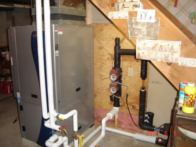

Just been down to the basement and took a few readings using a hand held infrared thermometer. These are probably not too accurate as I haven't used this much to date.
Here are the measurements:
Basement wall (in the cooler part) 60F
Heat transfer fluid to/from coils 52F out 94F back
Air temps in/out 67F in 74F out
Unit is WaterFurnace Premier AT 2 Speed
I don't know if the above makes sense to you guys, but as I read and understand what is happening:-
heat transfer fluid leaves the house at 52F and goes underground in coils and is returned at 94F, which is put through the heat exchanger.
Air is recirculated back to the unit at 67F and leaves the unit at 74F to heat the house.
Basement wall temperature in cooler part of the basement is 60F
I don't see any secondary heating coils so can only assume that the refrigeration unit cycle is reversed and the heat goes into the heat exchanger to warm the air more.
Please correct me if I am wrong regarding the above - the return of 94F is very real and is warm to the touch and tallies with the reading I am getting with the hand held IR thermometer.
Power used for last 23 hours extrapolated for 24 = 130 kWh current outside temp. at -19C/-1F

I have not seen a water condenser on a residential system. Nice to have, but as mentioned it would be expensive. You would need to have some sort of bypass (on the water side) during heating season. The desuperheater option is usually not that expensive to add (about $ 125 w/o dealer mark-up). During heating there is enough head pressure to get 1-2 KBTU/hr. In the coldest weather I get around 120 deg F in my preheat tank. I am sure that it has paid for itself many times over.
You are correct that in AC, since the loop water is 50-60 deg, there is little head pressure and superheat, so not much to gain. In cold climates like NH the desuperheat option should be worth it.
