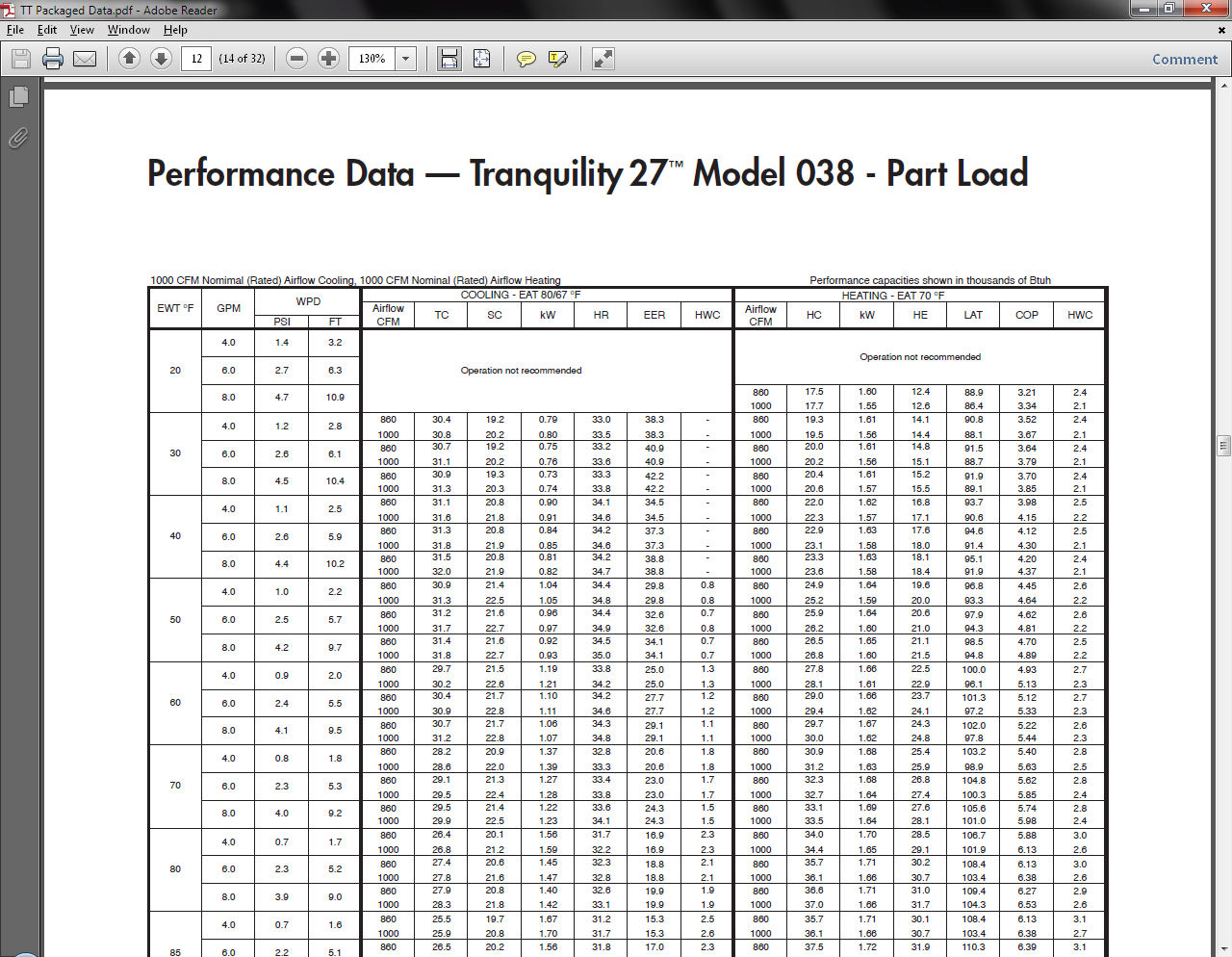

   / Geothermal HVAC #13
Just as a data point, here is data from the ClimateMaster Tranquility 38K BTU unit. If you look at the column "HWC", which is the hot water generator BTU output (in 1000's BTUs). You can see for every condition, the output in "Heating" always exceeds that of "Cooling"

In the winter you heat DHW with 30°-40° EWT. In the summer, EwT is in the 80°-90° range. For my unit SUMMER cooling makes more hot water than winter heating mode. you dont read the table across at the same EWT, you need to look at the proper season temps. In the middle season it's a moot point. my unit is 2200btuh winter heating and 4000btuh summer cooling. ymmv.
I am surprised by your EWTs. In winter I reach 27-29 deg by the season end. Summer I never get above 60 deg. But even at 80 deg summer and 40 deg winter, the DHW generator output is close to the same number, not really favoring summer.
Do you have bore holes or a ground loop ? Ay 80-90 deg EWT in the summer is not much improvement over a conventional air-air heat pump.
