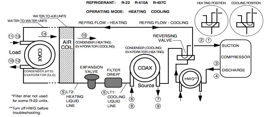

Here's a schematic of my Climatemaster geothermal unit if that helps the conversation:
The tech manual does mention hot water in all seasons.
Note the HWG is part of the reversible compressor refrigerant loop.
Also note that in cooling mode, the air coil is the evaporator and the ground loop is the condenser. In heating mode, the air coil is the condenser and the ground loop is the evaporator. That was a simple observation that cast the operation into agreement with my understanding of regular AC / heat pump systems (where the exterior fan and coil replaces the ground loop of a geothermal system).
Actually if you look, the HWG is on the compressor discharge for either mode. As mentioned it is technically known as a desuperheater and cools the hot gas discharge from the compressor.

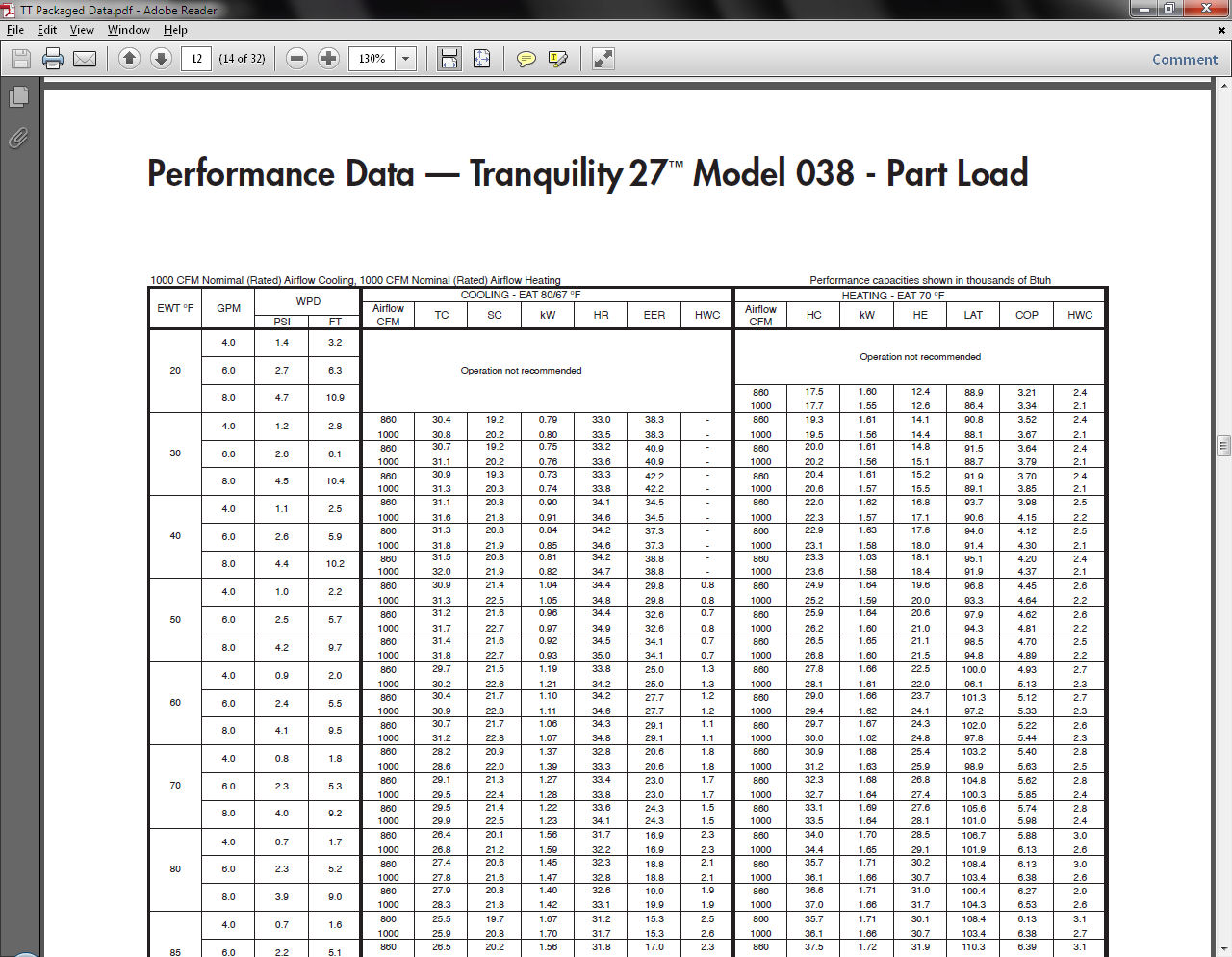

Just as a data point, here is data from the ClimateMaster Tranquility 38K BTU unit. If you look at the column "HWC", which is the hot water generator BTU output (in 1000's BTUs). You can see for every condition, the output in "Heating" always exceeds that of "Cooling"
paul

In the winter you heat DHW with 30°-40° EWT. In the summer, EwT is in the 80°-90° range. For my unit SUMMER cooling makes more hot water than winter heating mode. you dont read the table across at the same EWT, you need to look at the proper season temps. In the middle season it's a moot point. my unit is 2200btuh winter heating and 4000btuh summer cooling. ymmv.
/ Geothermal HVAC #17
I am surprised by your EWTs. In winter I reach 27-29 deg by the season end. Summer I never get above 60 deg. But even at 80 deg summer and 40 deg winter, the DHW generator output is close to the same number, not really favoring summer.
Do you have bore holes or a ground loop ? Ay 80-90 deg EWT in the summer is not much improvement over a conventional air-air heat pump.
