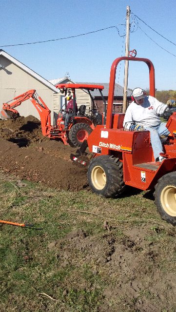

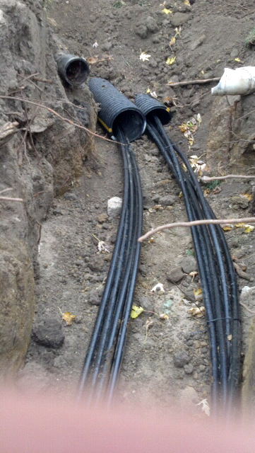

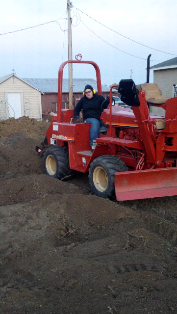

Well got the loops in and all went as planed took about 11 hrs to get all the pipe in the ground. We found a old heating old tank old septic tank and several tiles for the old lateral field as we have new aeration septic. Had wet clay from 34 inches down with as dry as its been that was a nice find and should help make it more efficient.
