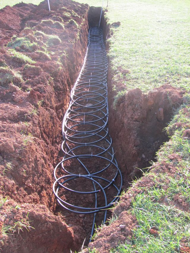

Geo can be a DIY, if you know what you're doing. I'm in the middle of installing two geothermal systems myself. I started by taking the IGSHPA geothermal class and became an accredited installer, then bought design software and designed the systems, including a manual J. Then I bought a backhoe, and now I am putting in slinky's. I put my 2nd slinky in today and have it on a pressure test before I backfill it tomorrow. In the end I will have 2 systems in my house for about $12k give or take, plus the backhoe. I was getting quotes of up to $40k to do these systems. I am using standalone package units, not split. They come precharged, so you don't mess with freon lines. Units are made by HeatControllers, and I used their design software. I brought all my loops inside, and will purge the loops individually with my QT non-pressurized flow centers.
I first designed using straight loops, and quickly changed to slinky's. straight loops are a LOT of digging, and you can achieve the same thing with slinky's, a lot less digging, and just a little bit more pipe. The pipe is one of the cheapest parts of the system.
I'm planning to write it up as a project when I get done, it's taking awhile because I don't have much spare time to work on it.
