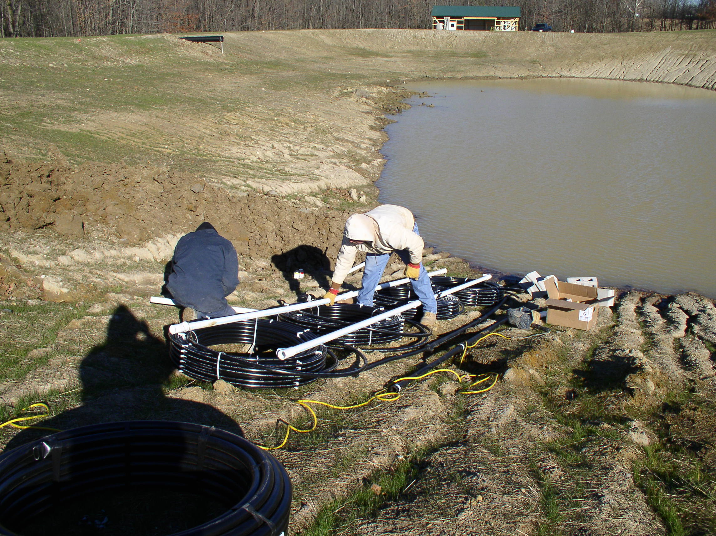

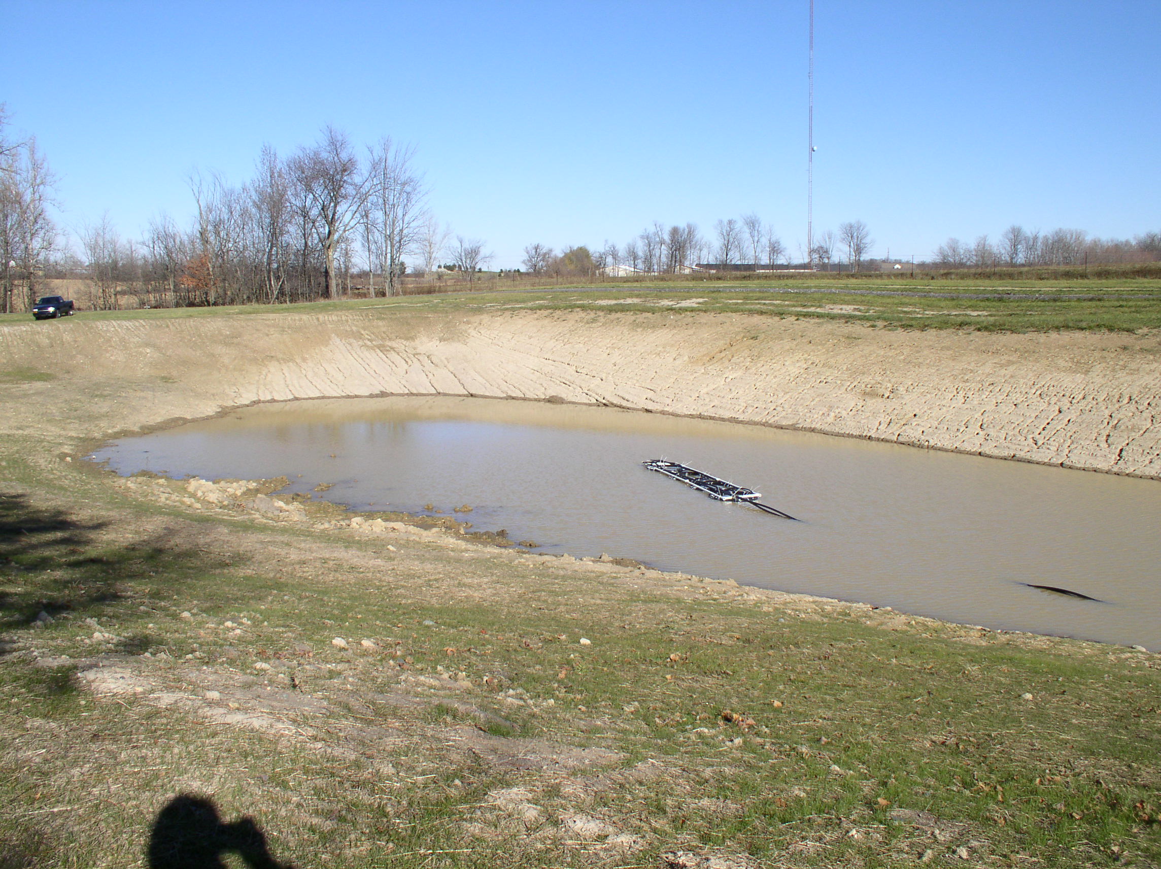

I have a closed loop in my pond. Its been 6 years and is working fine. The pond is 2/3 of an acre and the loop is down about 15 feet. My brother lives on the other side of the pond and he runs his geo off his well water. He dumps the water into the pond. His system also is working fine. My system cost a little more upfront but i wasnt crazy about pumping all that water out of the aquifier.

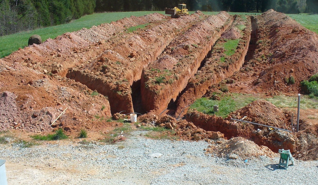

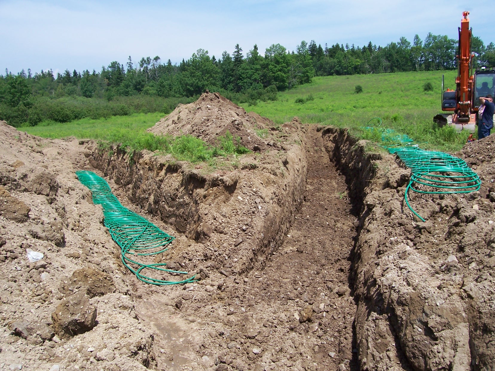

We did 3 horizontal slinkys for our 3 ton unit.
Ours is much the same, closed loop with 3 100 foot trenches 6 feet deep and 6 feet wide. 1000 feet of pipe in each trench.
Sean

/ geothermal pond loop? #25
3000' of pipe in a trench versus 1000' in a pond for a three ton unit. Now I see why he wanted to use a pond loop. We just tye-wrapped 20ft lengths of 3/8 rebar to our pipe, towed it out and let it sink when he charged it with antifreeze.

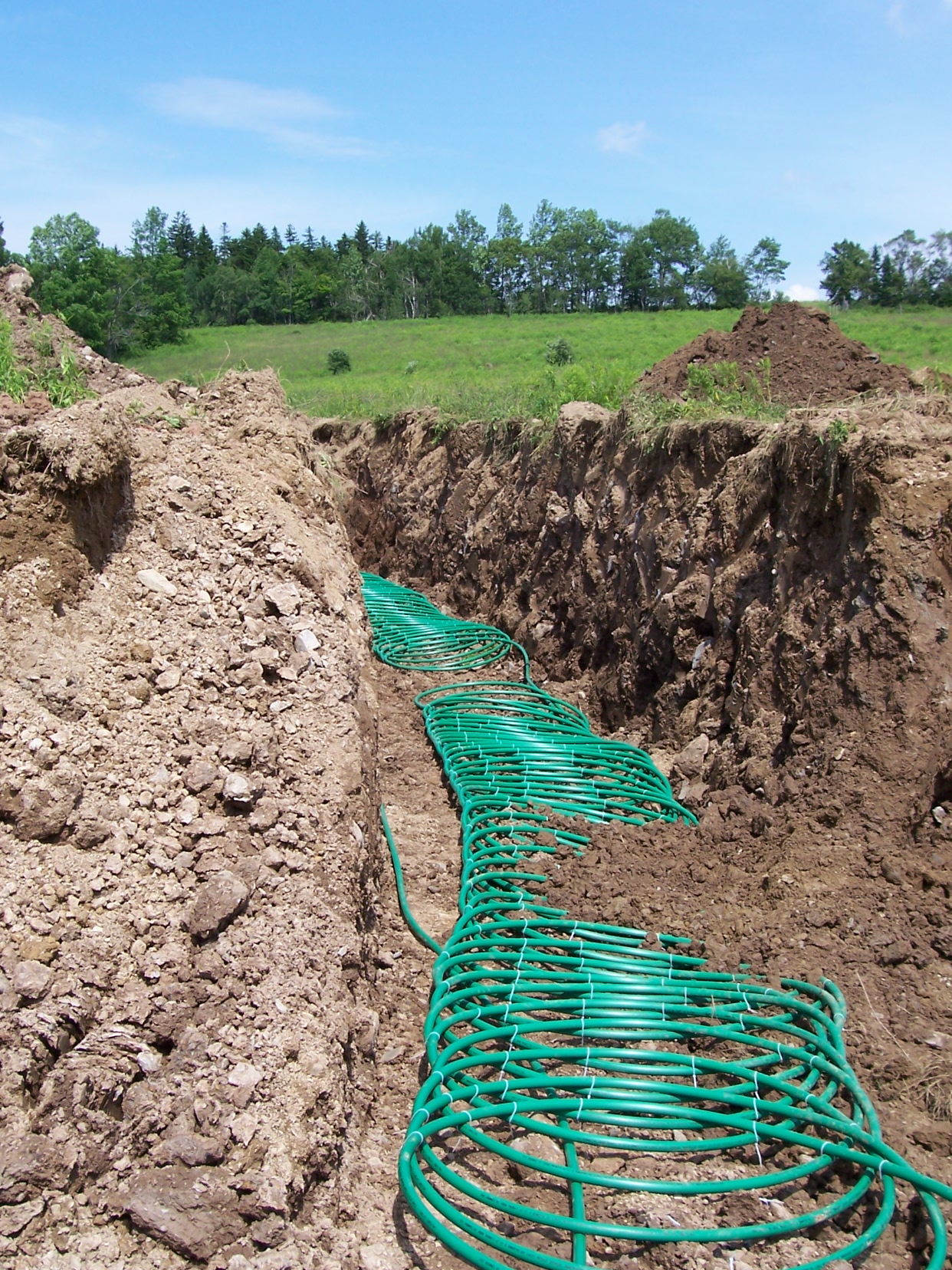

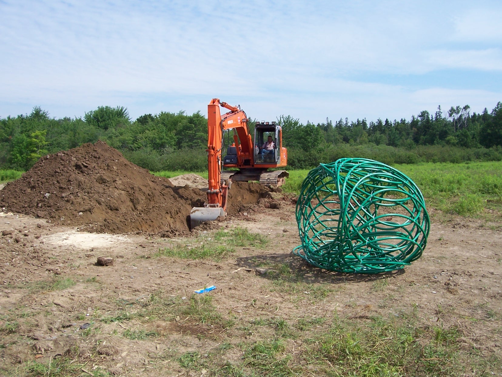

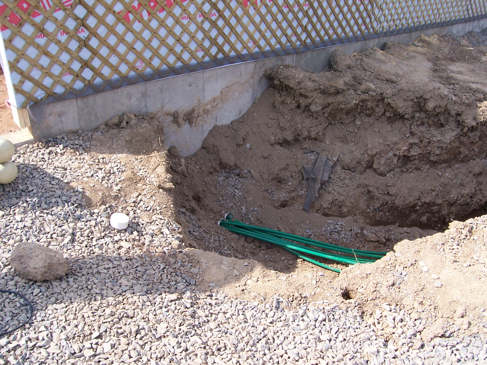

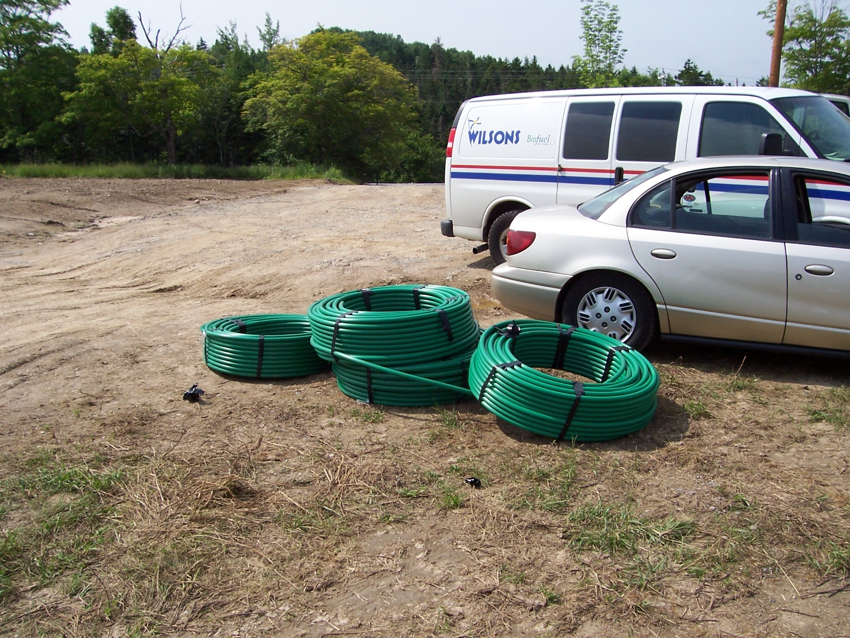

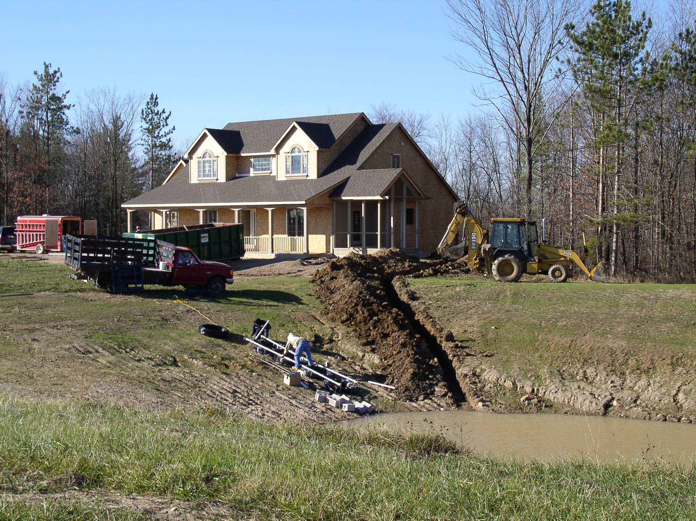

/ geothermal pond loop? #34

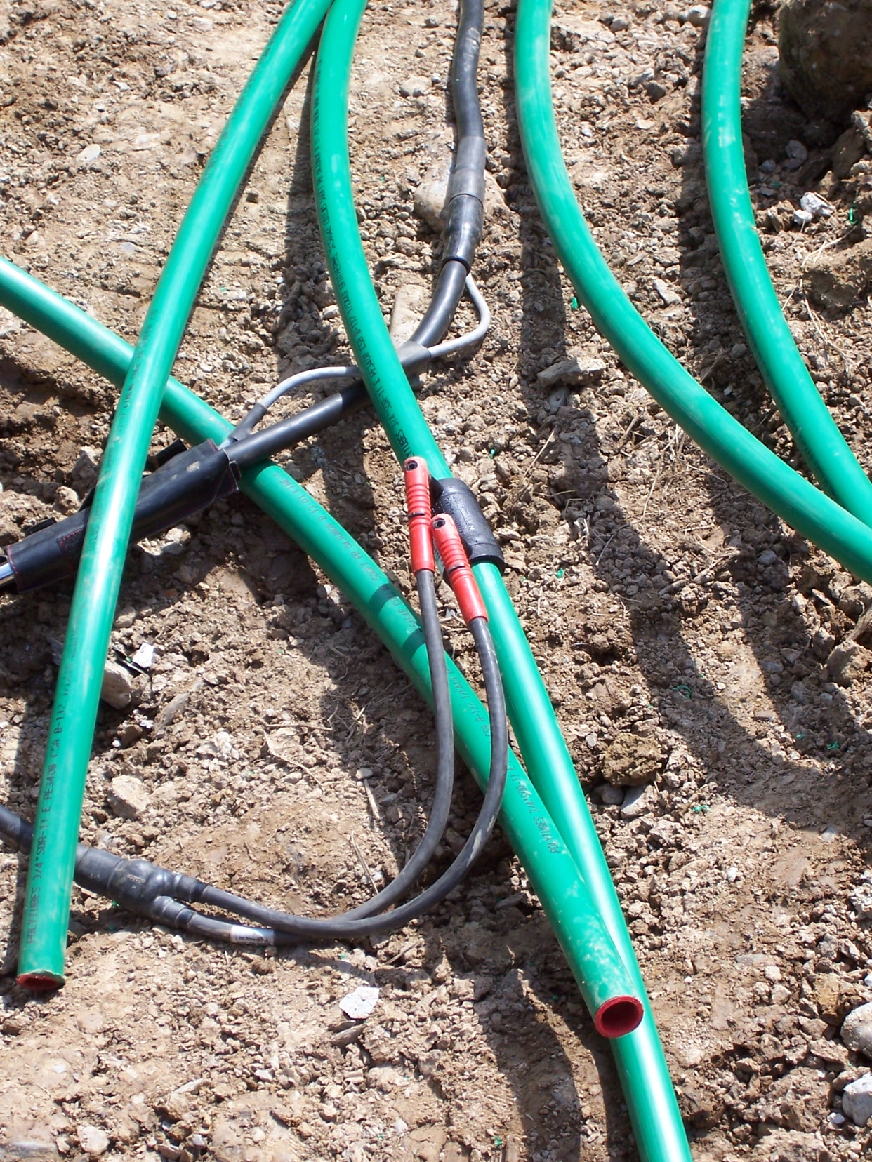

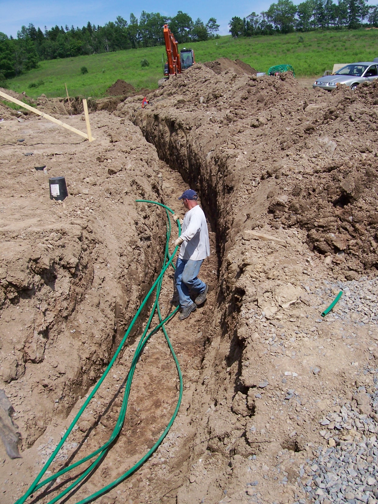

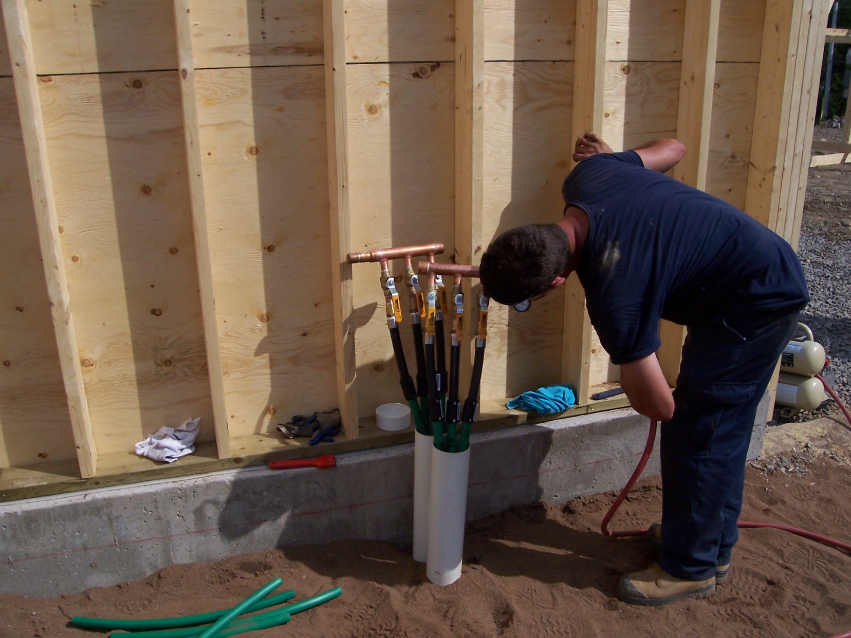

Our loops are at least six feet deep (underground), so there's no movement there. The excavation folks used a sifter bucket to fill the first foot or so on top of the exposed pipe, to keep any larger rock away from it.
The lines were pressurised while we were backfilling, so any break would have been immediately visible on the gauge.

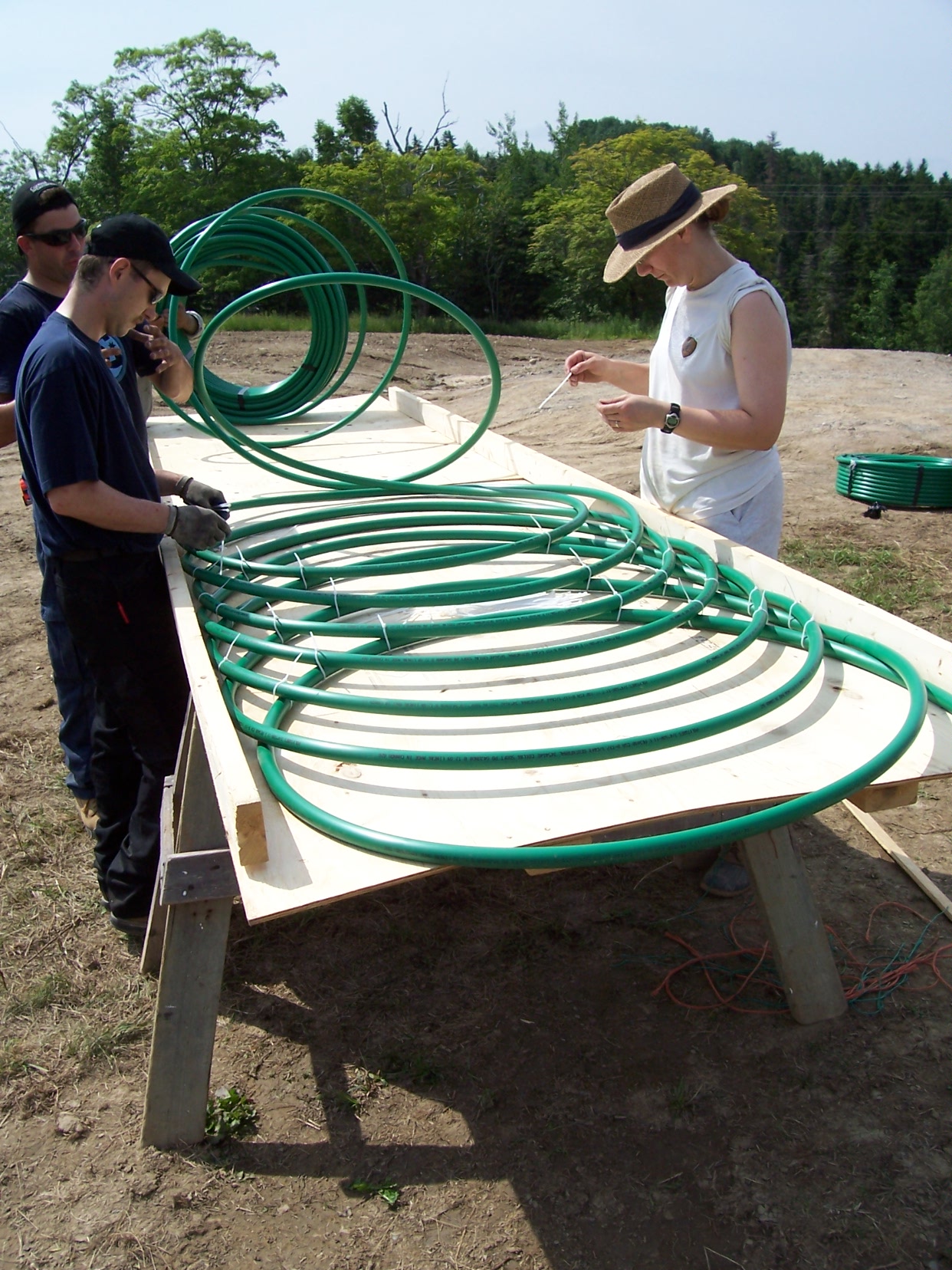

The loops were made on a table made from 4x8 sheets of plywood end to end, with 2x4's screwed to the edges to make a shallow trough. The loops were laid in place, then tie-wrapped to each other. The whole thing rolled up into a big "ball" for easy transport.
Electro-fusion couplings seals the ends of the loops together, and the ends terminate in manifolds inside the house.
I've got lots of pics, any specifics I can try to find.
Sean
