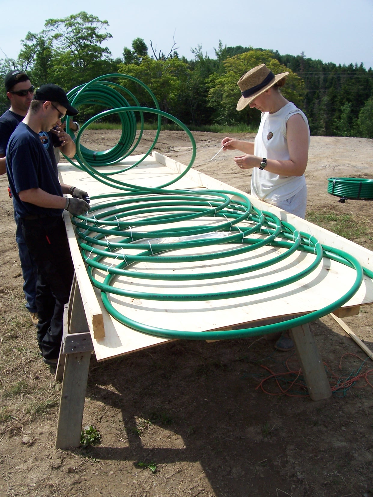

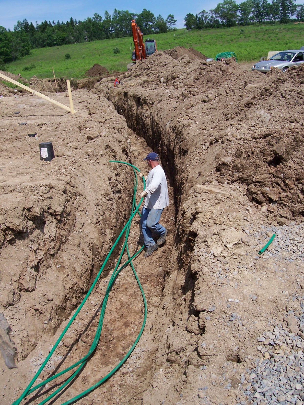

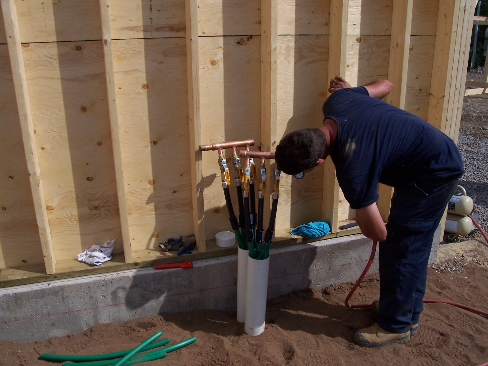

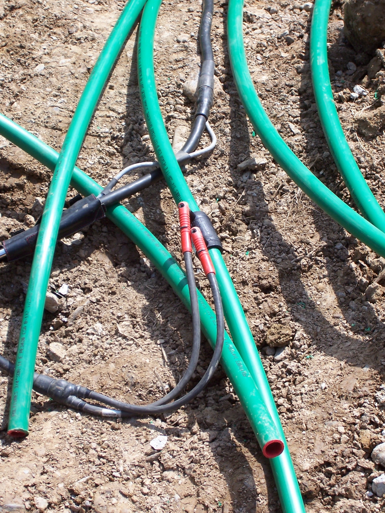

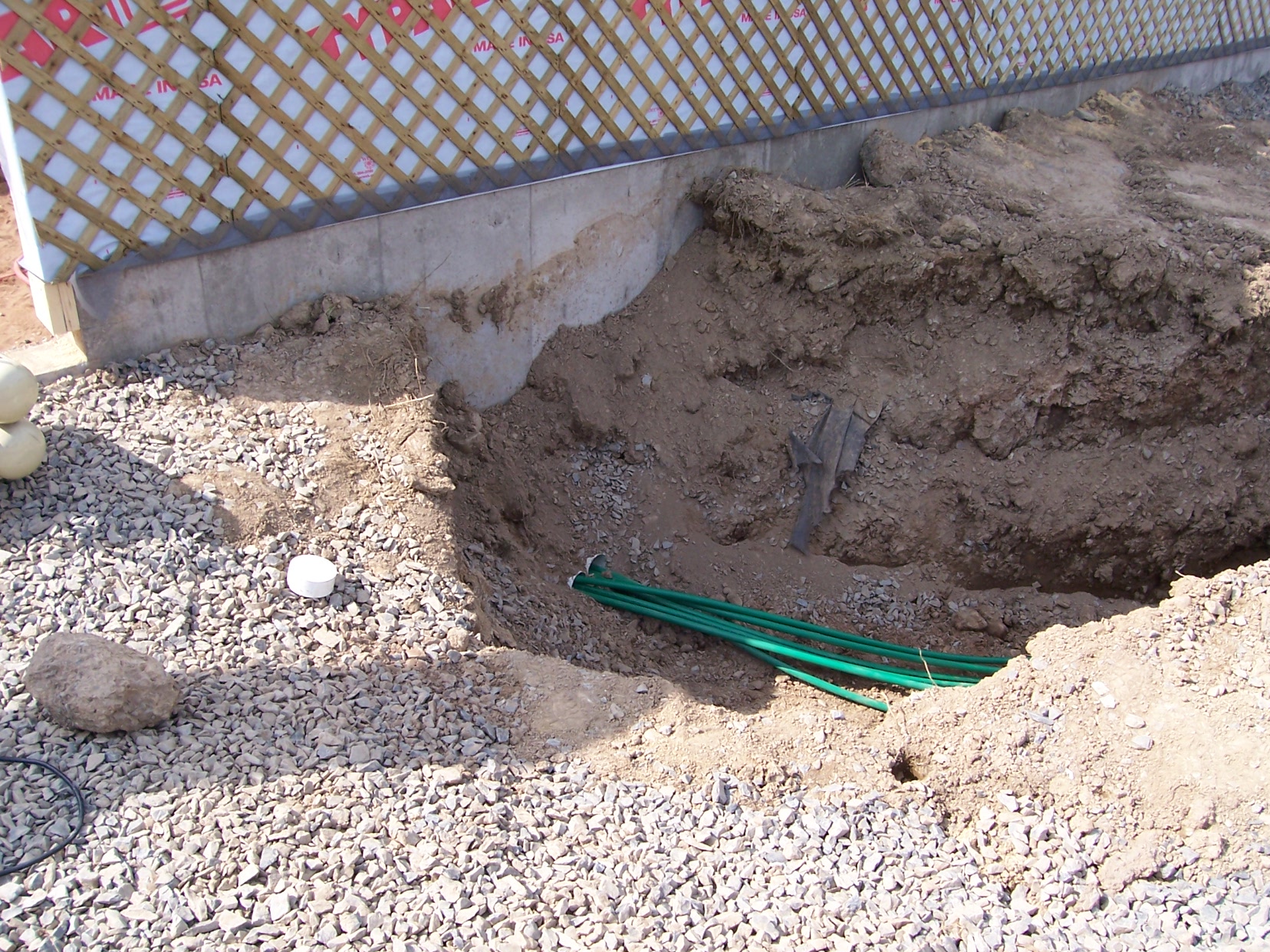

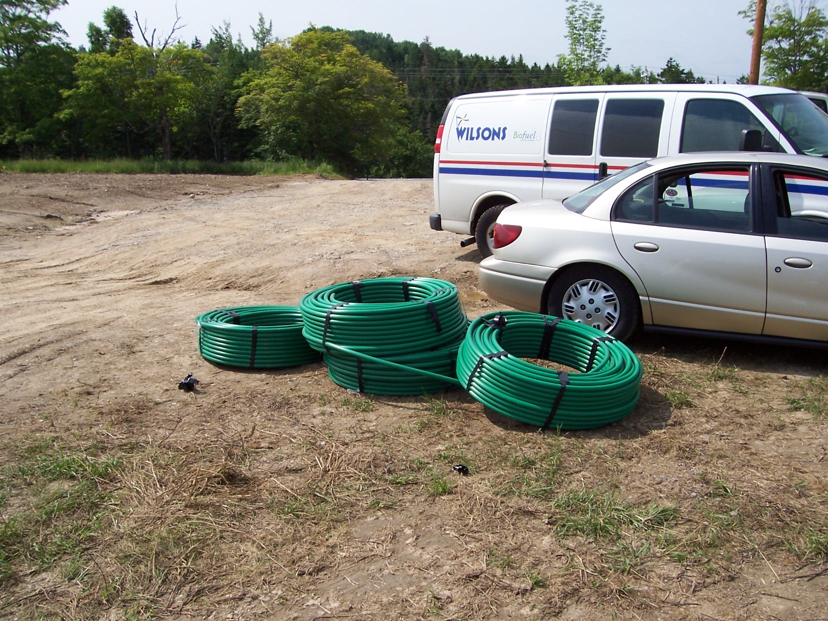

We put geothermal in last spring with 6 200 foot loops put in with a line boring machine. They are between 16 and 20 feet deep and the only places I had the yard messed up was where they dug a trench about 12' long to tie them all together with a manifold and by the house to run it in the basement.I replaced a 15 year old heat pump that wouldn't even keep the house cool in the summer with a system that will keep the temp at whatever I want for a whole lot less money. With 30% back from Uncle Sam it was a great decision.
Jeff
