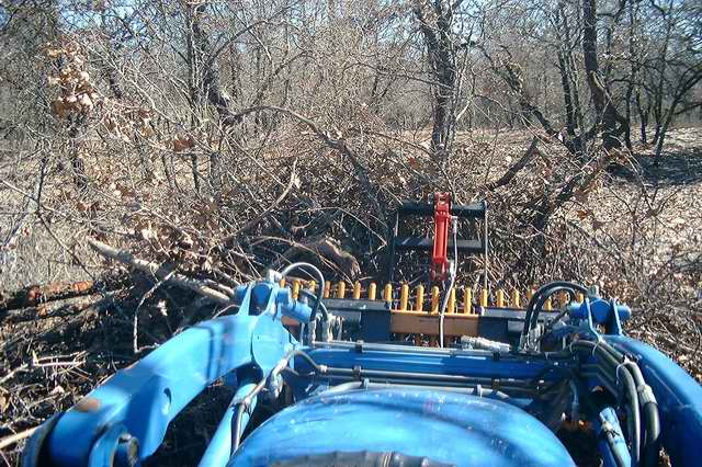

Thanks, Bill. Having a rock bucket with this design was one part that made my project quick and easy. I had doubts about the 3/8" u-bolts, but yesterday I stalled the hydraulic cylinder several times and it didn't phase the u-bolts. I think they are strong enough for most anything I'll do.

Jim you may want to head on over to your local TSC and pick up a part number Universal 1404-6-6 R.031 restrictor. It's 3/8" x 3/8" and will fit your grapple cylinder. It has a 1/32" orifice and will slow your grapple to a comfortable working speed.
Priced at just over four bucks. Cheers! /forums/images/graemlins/grin.gif

Thanks, PineRidge, but I beat you to this one already. That's good advice for anyone building a circuit to control a cylinder where controlled flow is a must. My New Holland dealer has lots of those and suggested them to me a long time ago. I use them on my TnT and the Grapple. I can just feather the remote valve handle and make the jaws slowly close or go full open and the jaws move from open to close in about 2 seconds. It's very controlled and easy to operate. I think my orifices are 0.030". /forums/images/graemlins/cool.gif
One thing Mark at CCM pointed out to me is to be sure you have a right angle adapter between the orifice and the hose because the jet flow of fluid will eventually bore a hole in the walls of hydraulic hoses. I think it would take awhile to do that, but I've found Mark doesn't say things unless he has a reason.

Jim, I have heard that mentioned before also but decided to test the theory. My restrictor is installed straight in line with one of the grapple hoses. This particular hose has a bit of excess so I figured that if the hose ruptured as a result of the restrictor then I could easily cut off the damaged end and have a new connector crimped into place and then deal with the location of the restrictor itself. I'm betting a failure won't occur in my lifetime but I could be wrong here too.

Mike, I remember CCM's post on that and it was more than a theory. It was experience they had with something (forget what) where a number of the same items came back with hole/leaks in hydraulic hoses, and the cause was traced to the hose being cut internally by the fluid shooting out of the oriface hole, sort of like high pressure water can cut steel plate.
Anyway, it might have been due to a bend in the hose right after the oriface. If your setup is straight, and the high pressure stream does not directly hit the hose material, and the energy is dissipated within the fluid in the hose, you should have no problems I would bet.

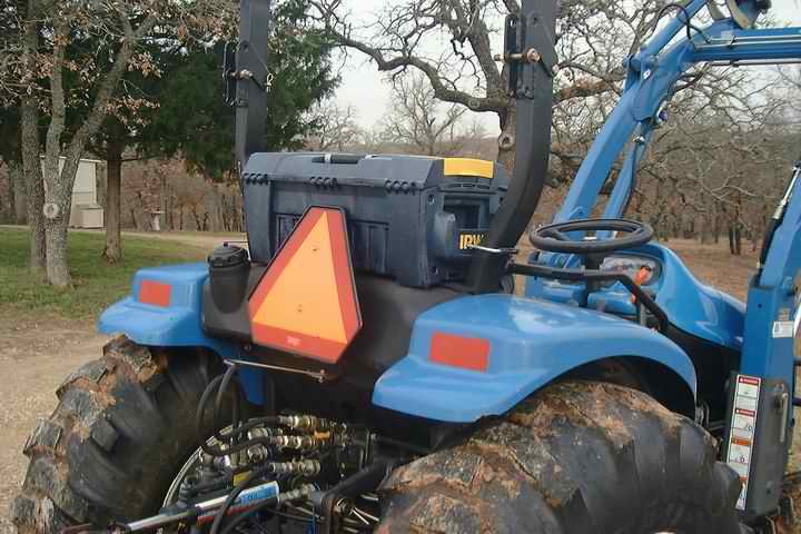

A bit off topic, but....have you posted any details of that toolbox and how you mounted it up above the fuel tank ??
I'm thinking that's something I can use and afford /forums/images/graemlins/crazy.gif.

Don't know how Jim mounted his tool box but this is how we solved the problem. toolbox

I didn't know if I was gonna slip that by without anyone noticing or not. I just got tired of not having a good toolbox and decided to give this simple solution a try. It's an Irwin brand toolbox I bought at Home Depot. The thing is 26" wide and is nearly a perfect fit between the ROPs uprights. I used some old rubber bedliner (1/4" thick) under the toolbox to kinda pad the top of the gas tank. There were brackets on the sides of the toolbox just right for me to use more U-bolts in addition to the ones on the grapple. I'll post a few pictures to show how I mounted the box. I really like this box because it sheds water and has no holes to leak water down into the box. Heck! If I was diggin' tators with Have_Blue, I'd be able to put about 25# in this box. /forums/images/graemlins/laugh.gif

The only problem with the toolbox is it is so big some of my rear view is blocked. I keep my seat adjusted high when boxblading in reverse so I can see what I'm doing. It's not bad, but I don't have the clear view of everything as I had before.
