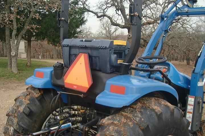

Jinman, To say I'm jealous is an understatement. Nice work.
A bit off topic, but....have you posted any details of that toolbox and how you mounted it up above the fuel tank ??
I'm thinking that's something I can use and afford /forums/images/graemlins/crazy.gif.

<font color="blue"> A bit off topic, but....have you posted any details of that toolbox and how you mounted it up above the fuel tank ??
</font>
Don't know how Jim mounted his tool box but this is how we solved the problem. toolbox

</font><font color="blue" class="small">( A bit off topic, but....have you posted any details of that toolbox and how you mounted it up above the fuel tank ??
I'm thinking that's something I can use and afford .
)</font>
I didn't know if I was gonna slip that by without anyone noticing or not. I just got tired of not having a good toolbox and decided to give this simple solution a try. It's an Irwin brand toolbox I bought at Home Depot. The thing is 26" wide and is nearly a perfect fit between the ROPs uprights. I used some old rubber bedliner (1/4" thick) under the toolbox to kinda pad the top of the gas tank. There were brackets on the sides of the toolbox just right for me to use more U-bolts in addition to the ones on the grapple. I'll post a few pictures to show how I mounted the box. I really like this box because it sheds water and has no holes to leak water down into the box. Heck! If I was diggin' tators with Have_Blue, I'd be able to put about 25# in this box. /forums/images/graemlins/laugh.gif

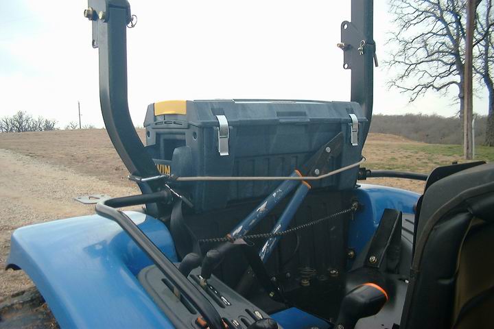

The only problem with the toolbox is it is so big some of my rear view is blocked. I keep my seat adjusted high when boxblading in reverse so I can see what I'm doing. It's not bad, but I don't have the clear view of everything as I had before.
