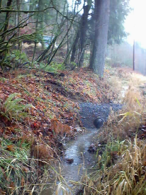

Well, I fellt like getting out of the house today so started a little project. Also happened to put the camera in my pocket and document along the way. Todays project was to put a culvert in a small creek which would give me some access to parts of my property previously inaccessable with the tractor. There is a horse trail on the other side of the creek that leads up to the house and barn and could use some regular 'housekeeping'. Bought 8 feet of 12 inch pipe (local code) at a discount for being a short piece ($20) and brought in 2 loads of rock with my pickup at $10 each. So, fairly cheap project also. Heres the pic of the culvert in the creek and just putting some crushed rock around/over it...

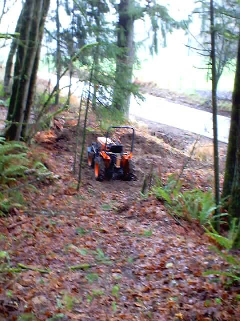

Heres looking upstream and have a little more rock on top.

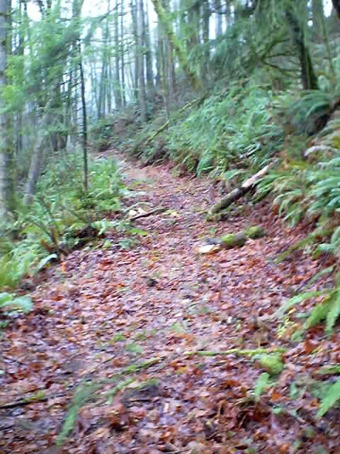

Once I got enough rock on top to bridge over, I was able to finally give the little tractor a taste of the dirt on the other side by doing a little leveling.

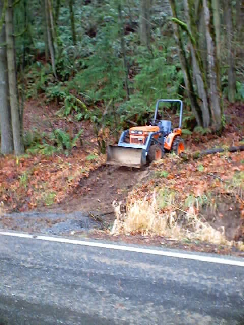

Behind the tractor you can see the trail going up the hill. In front of it is a pile of wood that I'll burn. I am standing on another trail that leads back to where the creek comes out my property and where I have some new trees planted.

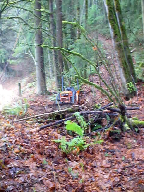

No Mike, I didn't get a permit. Thought about it, but figured they'd charge me more than what the job is costing me. If someone wants to make an issue with it, I'll play dumb and deal with it then. I don't think I'll have any problems though.
Here's a pic of the horse trail going up the hill to the house and barn...

Frank, compared to what Buffalo got hit with, I'll take the rain anyday! As far as the ag tires go, couldn't do anything without them. Going over the culvert the first time I had to back over, in low, max rpm, and differential locked. Once over, I leveled the slope a bit.

pdxman -
I know well the satisfaction of crossing a new culvert to reach virgin territory. /w3tcompact/icons/king.gif
I'm curious though -- is your culvert intended to be permanent? I only ask 'cuz I don't see from the pictures what's going to keep it from washing away when that creek gets to really rippin'.
I put in several on my property, using sandbags filled with redi-mix to face them off with. In addition I arranged rocks to help shield the upstream side from erosion. Even so, one of them washed out the first winter and I had to rebuild it. Poured a concrete face this time. /w3tcompact/icons/grin.gif
