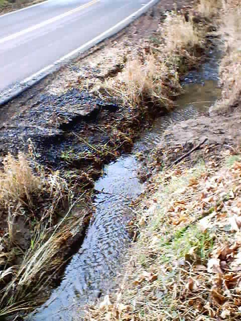

Well, the culvert didn't hold up and all my fill washed out. Haven't had a chance to look at it in the daylight since last weekend. But, was able to pull the culvert out by hand the other night and throw in my pickup...don't want it to find a pair of legs and walk off being that it was right next to the county road. It was plugged with debris on the end so I am sure it was undersized. Plus, during the heavy flow, was also submerged.
Question; Any rules of thumb on making an overflow? Might as well find this out before investing more time on it.

The idea is to provide a channel which will carry excess flow away from your culvert and drop it back into the creek at some downstream point. I guess the theory is that it's better to sacrifice a little erosion across your road in favor of preserving the culvert. One way to minimize that erosion is to construct a swale at the road crossing itself.
I made <A target="_blank" HREF=http://www.acknowledge.com/tractor/L2500DT/photos/Overflow.gif>this sketch</A> a while back, and in fact it pretty well represents the way I constructed the overflow on my first culvert. Although it would be better to divert the flow further from the culvert, it did overflow and survived the first winter. I haven't seen it since this recent bout of heavy rains we just had, but I'm keeping my fingers crossed. I've learned that culverts are something you re-evaluate after each rainy season.

Well, here's whats left of it. I did remove the actual pipe earlier this week.
Harv: Thanks for the threads.. I'll take a look at your experiments.
One thing I noticed in mine was how much rock actually washed away and is gone. I think the first rock I put down this time will be some larger pit run.

pdxman - tough to judge from the pics but that looks like about 12 inch pipe? Might want to consider upsizing to 18 or better and use the collars they make for the upstream side. Oversized will let any debris, mud etc be washed through to ther other side and the collar helps prevent the water from washing away the back fill. Also as you already figured out the bigger the rocks the better, at least for the base. Water washes away gravel and running crush pretty easily. As an alternative you could also get some used railroad ties and just make a bridge for a gap that small.
