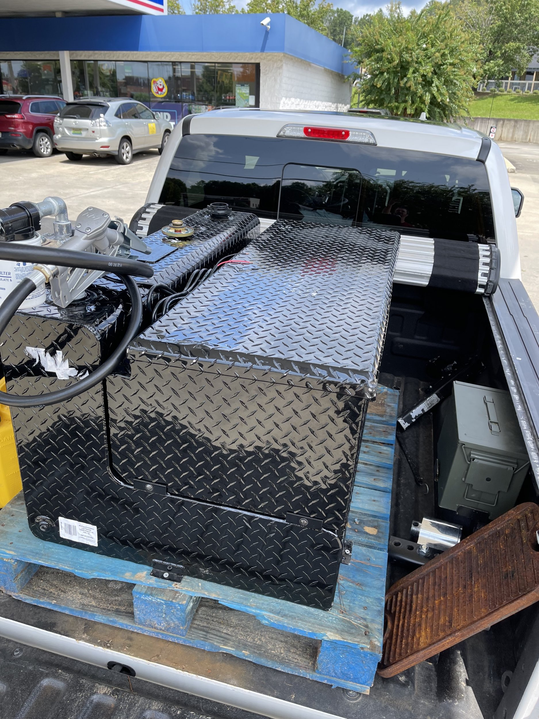

I picked up a scratch and dent 80gallon tank/toolbox combo for $600, the toolbox was banged up but the tank is pristine. They had locked it and lost the keys, I drilled it open and found a GPI 8gpm pump and filter inside.

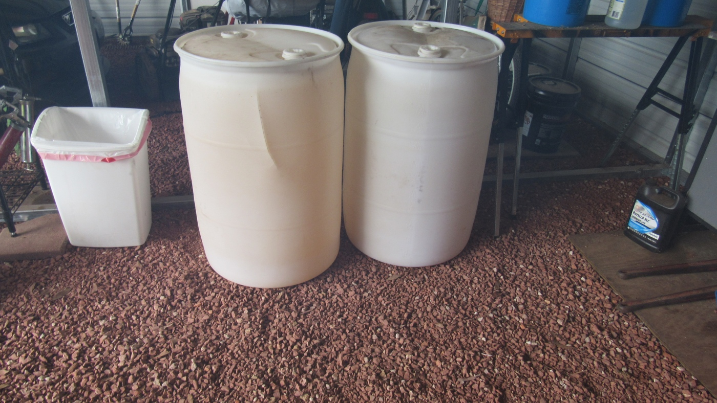

After my drum split scare I'm done with large plastic diesel storage. I just pumped the rest of mine into 5 gallon plastic containers so I could situate my new to me aluminum tank.
Not sure if it counts for containment but I do have a heavy duty tarp the size of my barn underneath the crushed brick. Wouldn't be anyway to remove a spill without destroying the tarp but it might eventually evaporate. Just hoping I never have a spill that large. I got lucky on the drum split and it stopped above the level of remaining fuel.
Here is my new to me aluminum tank. Supposed to receive the gauge I plan to install today so after that is set I can order a fill up.
