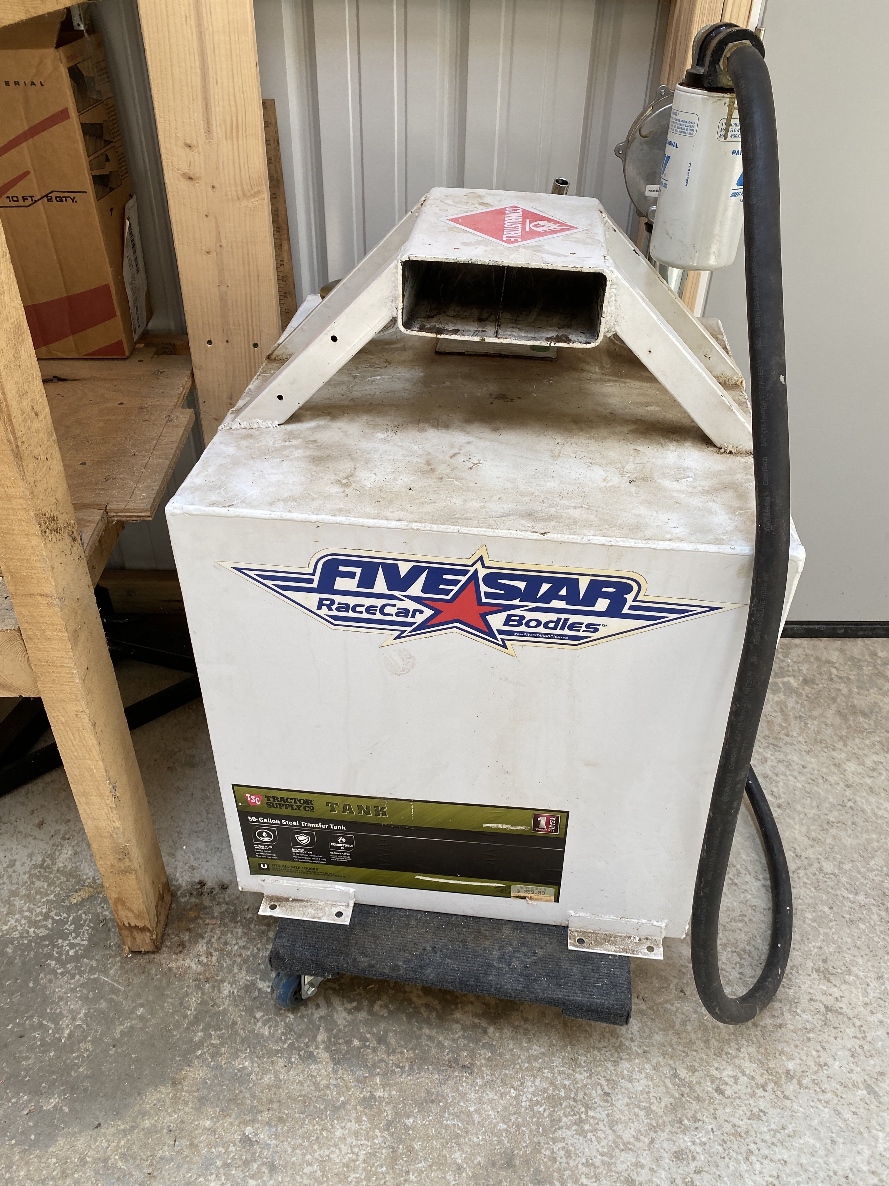

   / Fuel hauling trailer #16
My portable fuel tank;
