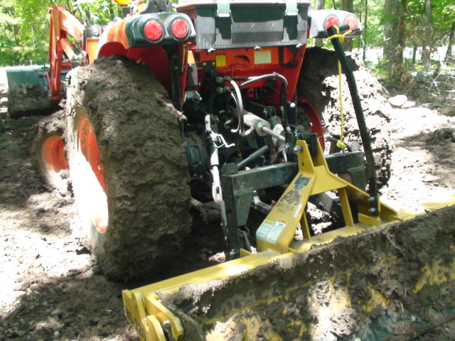

What is a solution for sticky, clay-mud build-up on tractor tires and skid steer tracks when I get back at the shop? From Oct-Mar it doesn't take much for the sticky clay to create a 1-2" layer all the way around the tires/tracks.
Short of pressure washing before going inside, is there a labor-saving way to get the bulk of that mud off before going indoors or near the shop.
Is there some type of "cattle-guard" that you could drive over that would get it off?
How about some sort of tire-scraping wheel or track attachment?
Maybe something you can put on the tire as a non-stick treatment?
Something else?
Thanks, Scott
I smack the tires with a piece of wood (think baseball bat or short 2x4) on the sidewalls and treads. The rubber deflects and pops the clay off. Drive the tractor forward a few feet and do it again. This work great on my turf tires after rototilling.

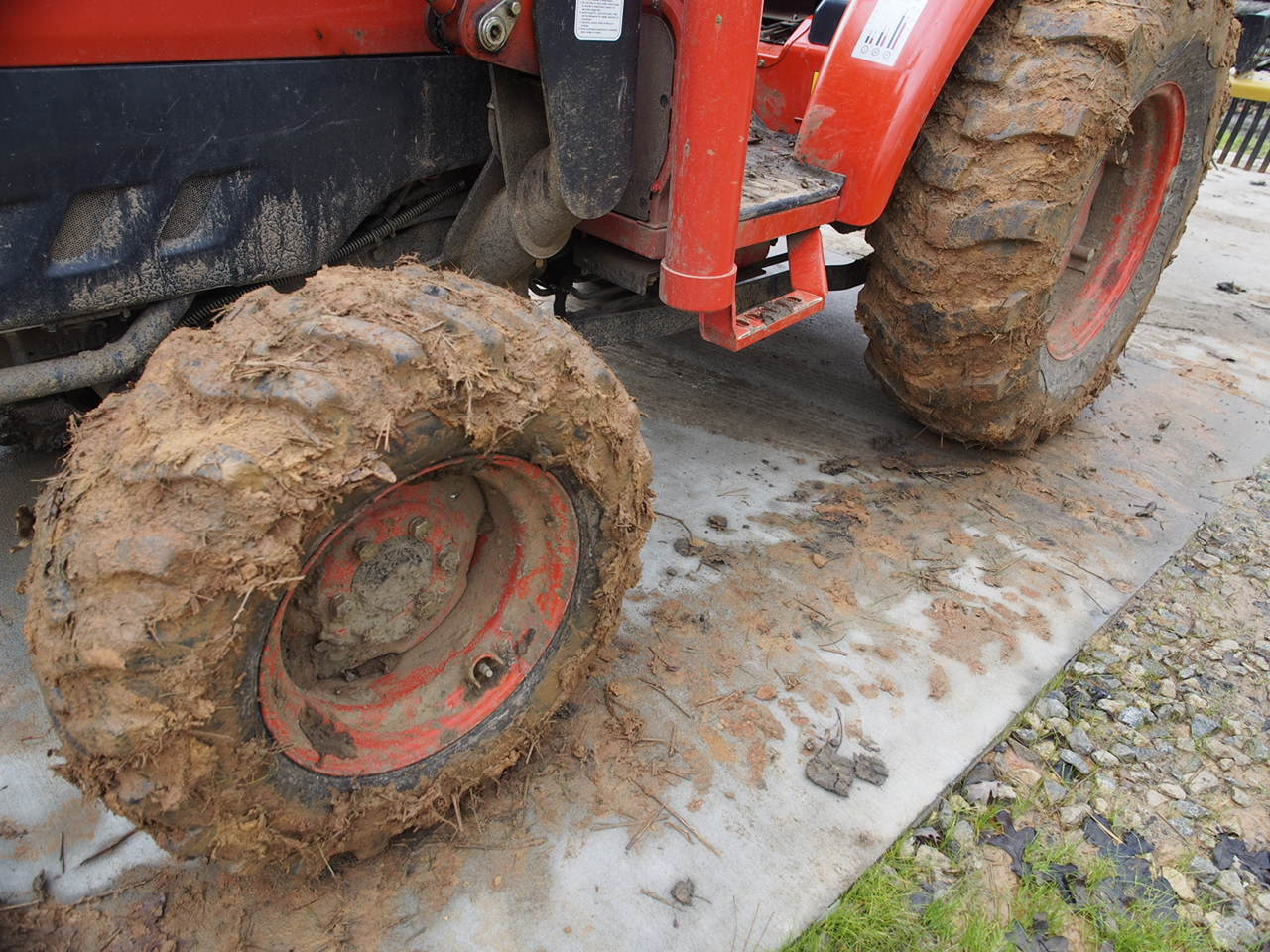

Another vote for pressure washing.
Something else?
Thanks, Scott
I have a 1/4 mile stretch of paved road near my place. When my tires get caked with mud I put the traactor in high gear and run it up and down the road. The mud flies off.
